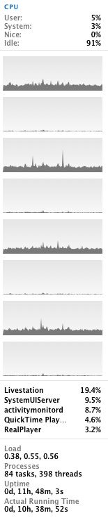

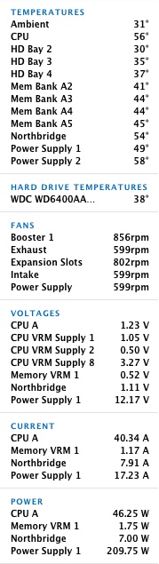

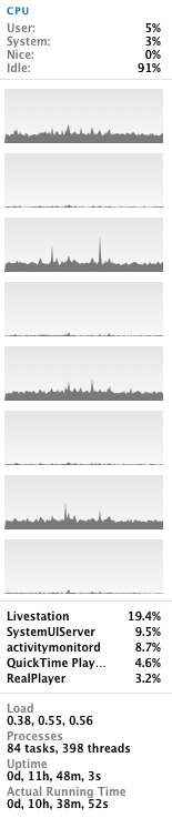

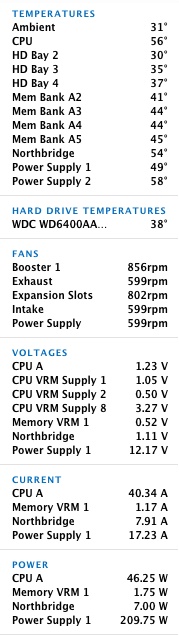

I did a test on my 2 week old 2009 2.66 Quad / ATI4870 / 3GB Ram / OS 10.6.1... played a MP3 4min. song using:
- Quicktime 7
- Quicktime 10
- VLC
- iTunes
- Realplayer
Test also included Safari with a flash based live-streaming radio station, and TV stream with Livestation (dw-tv).
Also running the finder, skype, livequartz, textedit, and a bunch of pref panes (SMCfancontrol, soundsource, iStatMenus, cuteclips, caffeine, littlesnitch). The fans were set to the default speeds during all tests (no SMC).
CPU temperature is around 45ºc for internet browsing, with a reported ambient temp around 30-33ºc... thing is that the ambient sensor is wrong: it's not really that hot here!!! Two other thermometers report 21-22ºc... perhaps the sensor is wrong, or perhaps the fact that I have my MacPro under my desk has to do with the difference (I do feel some of the GPU's hot air there... where's the ambient temp sensor anyway???).
See attached stats.
CPU temperature rose 13º celsius during the test; power consumption rose 12-15 w. Extra activity from the fans did not kick in. After the test I closed all players and streamings. Temperature stayed at 54ºc (dropped 2ºc) , CPU workload back to 2% User, 3% system, and voltages decreased by 10-15 Watts.
Hope this helps. Cheers.

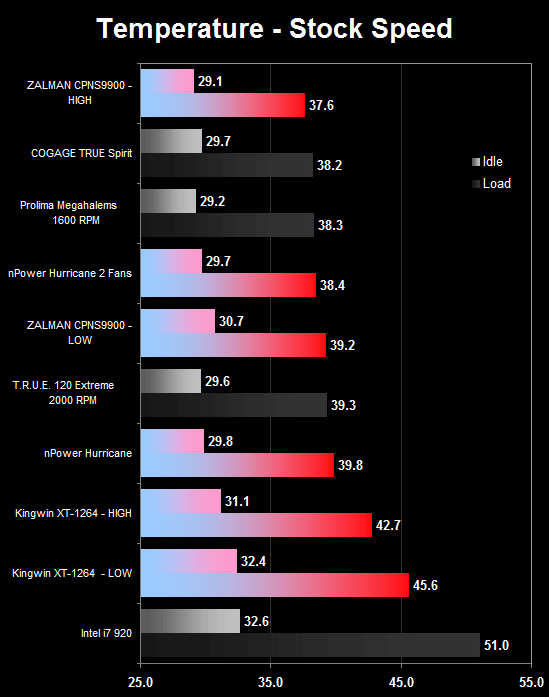

Thx for showing this! Your basic temps are MUCH HIGHER than full LOAD temps on core i7 CPU's.
I wonder how the new iMac with this CPU will handle the heat?

Yeah.. Those temps are high.. Kyle's work at [H]ard OCP shows it.

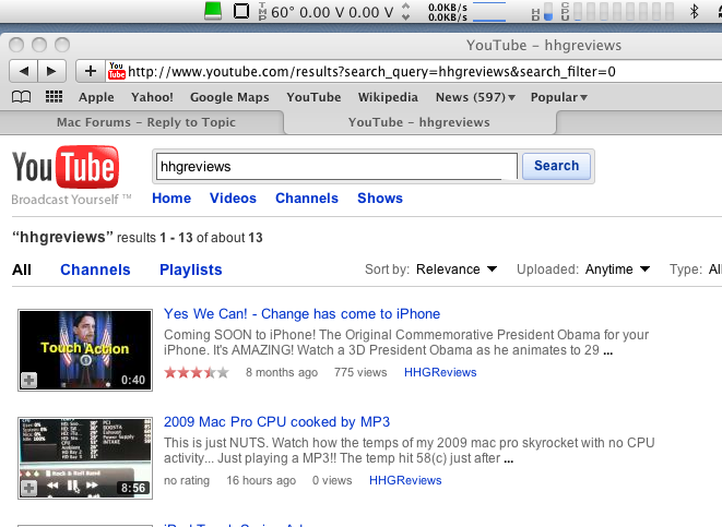

Just got up to work on some email. Just noticed I'm idling at 60(c)!?! I'm not doing anything. Why is my CPU chugging down so much power? I have word, mail, and safari running. I'm just typing an email...
No audio is playing on the system.
WTF... It turns out that some web pages sitting on inactive tabs are the cause of the problem.... No video... No audio.. Just a web page with some flashing graphics.

here's another one. Having the Web Page sitting idle brought me up to 60(c)...
There is no activity on screen. No video - or anything..... Just search results from YouTube....
