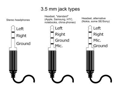

It's possible that your TRRS adapter has the wrong contact arrangement for the Mac Mini. Unfortunately this isn't standardised and manufacturers just use whichever one they want.
The adapter has to have the contact arrangement in the middle:
It's also possible that bad soldering within the adapter is causing the issue you are having.
Does your RCA to USB-C converter show up in Audio MIDI Setup? Can you give a link to its product page?

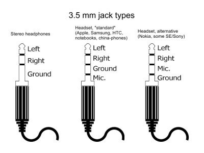

I just sent it back... it was cheap enough that I could order another one but the description said it was for iphones and apple products so I assumed it was what I needed. I didn't check with the RCA to USB... from what I read, the USB-C would only allow audio OUT. Every post was discussing using the headphone/mic jack. When I TRIED the adapter below, the audio was so loud and distorted, crazy.
I've realised that what I said about the TRRS adapter wasn't correct for your use case. It actually isn't possible to record stereo audio using the Mac Mini M2's 3.5mm jack, as the stereo audio part of the jack is an output only.
You'll only get mono audio input because the jack is designed for wired headsets with a mono mic.
