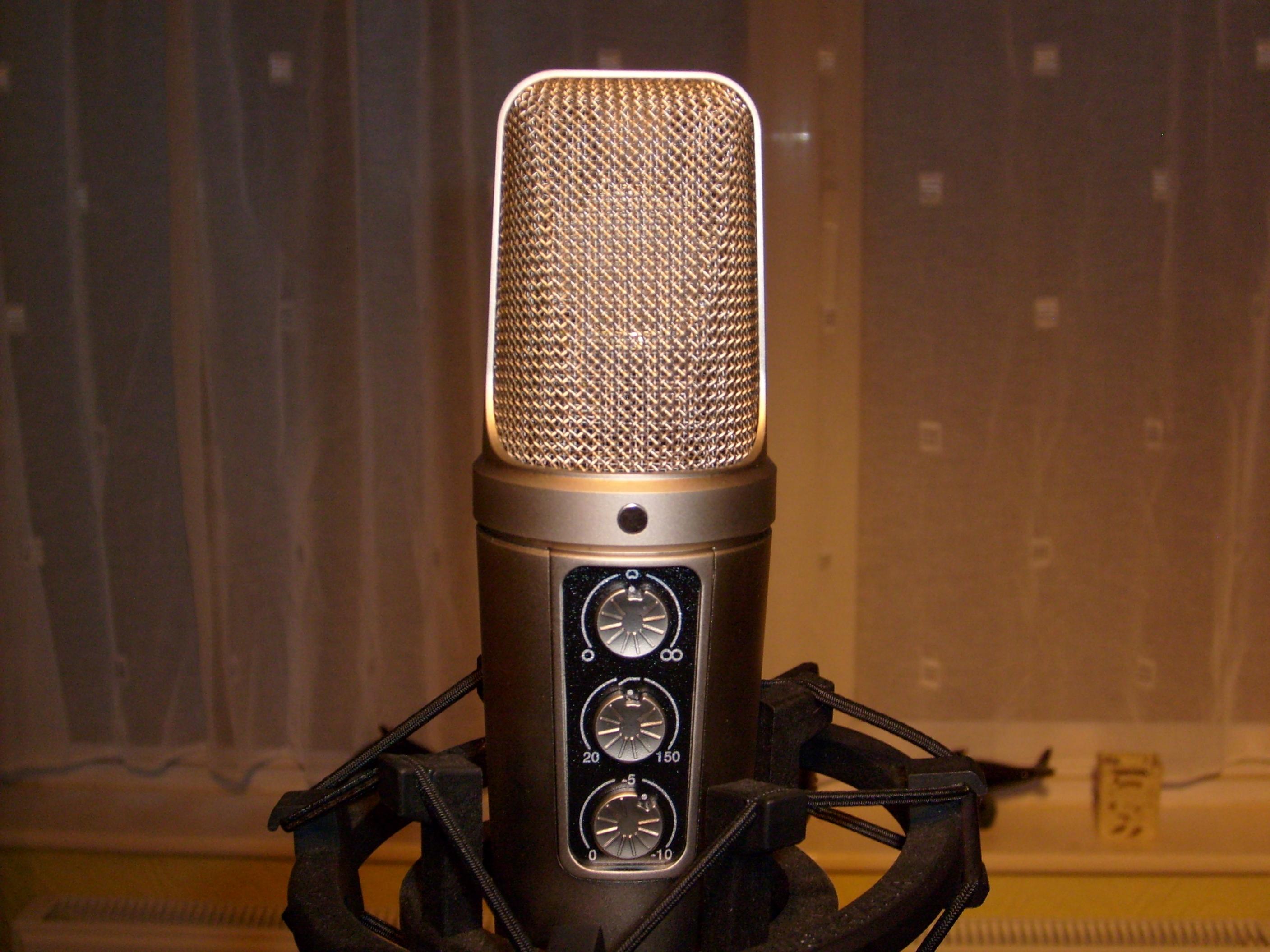

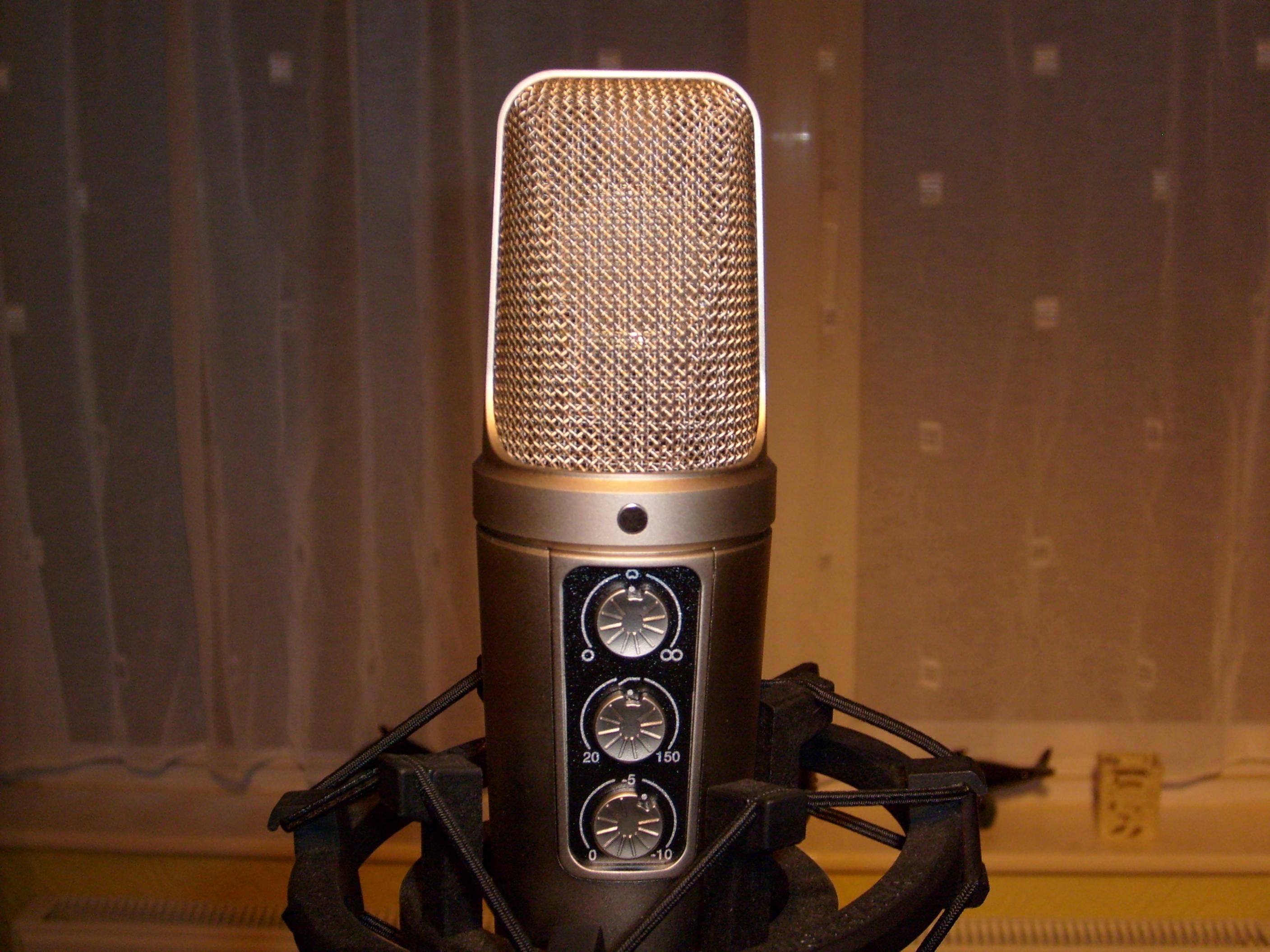

I love my Rodes I've got an NT1-A and an M1 I think they are both great but I got my NT1-A back when they came with crap shock mounts but now Rode supply a much better one with a built in Pop filter which is really nice, and living in Australia they are really good value here along with the 10 year warranty
I use them for everything....Never had any issue with them at all.
