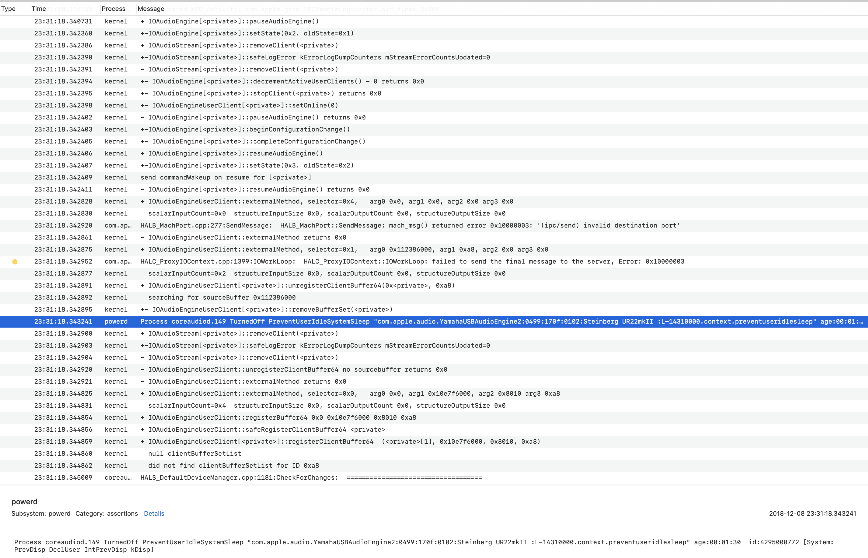

[doublepost=1544308682][/doublepost]Here's another log. This time the audio source was YouTube.

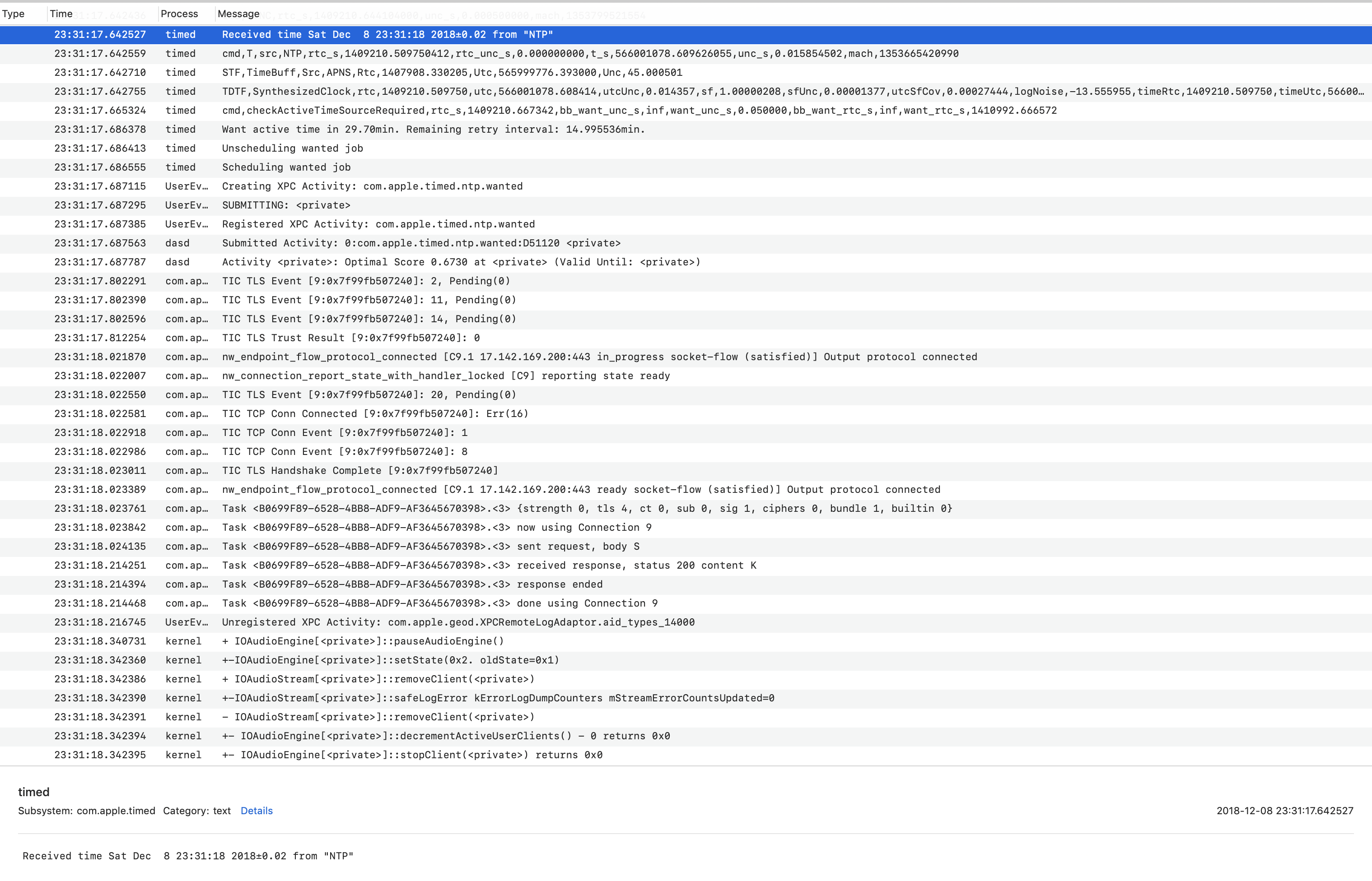

Here's a screenshot of the timed event with the connection disabled. I listened to a continous mix for 2 hours and the only time the timed process came back is when I enabled Wifi again.
Now it's possible that I spoke too early again, time will tell, but right now it looks like this is a solution for me until Apple fixes it.
