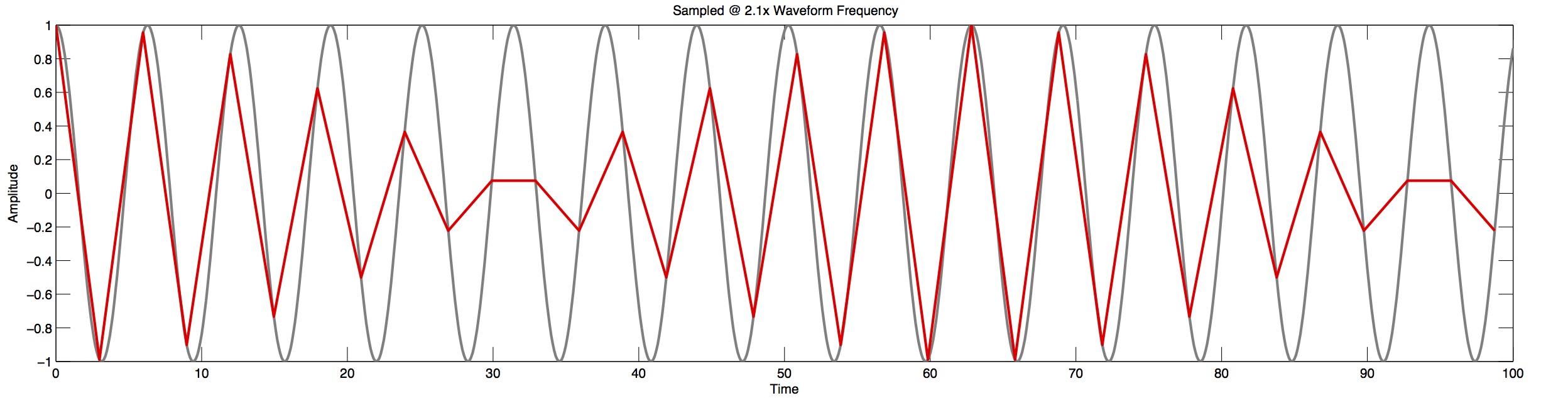

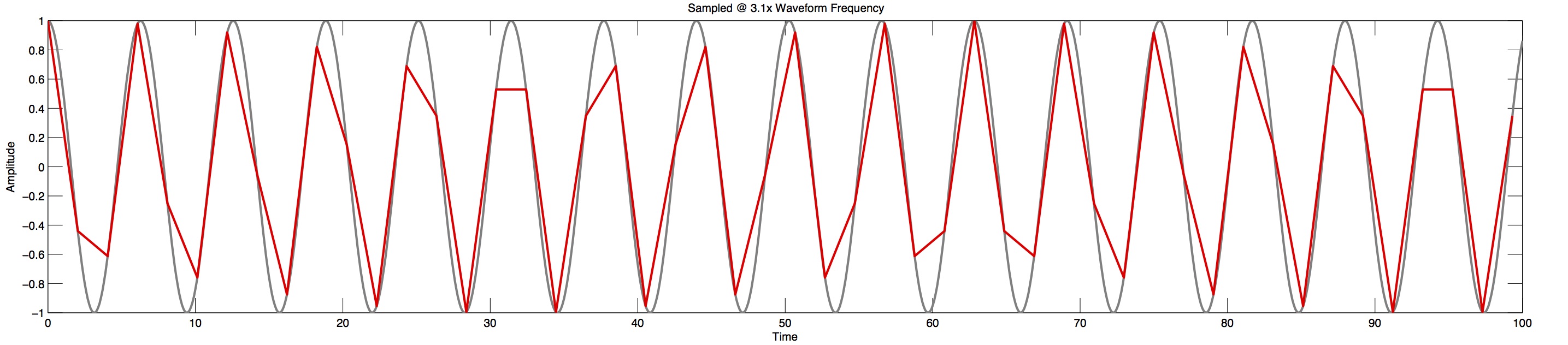

OK, two plots, sampling at 2.1 and 3.1 times the wave frequency.
So you're trying to tell me that the first graph, @ 2.1, still accurately portrays the waveform?
Neither of your red lines accurately portrays the waveform because you just linearly interpolated between the points that were sampled. That's not what a digital-analog converter does. A DAC finds a sine curve that fits the points that you sampled (i.e. the vertices of your red line) and then spits out an analog signal that is 100% identical to your input.
Check the last picture in jont-fu's link for a more accurate representation of how the waveform is reconstructed from individually sampled points.

Drawing the lines was a mistake on my part, I did not intend to suggest that the signal would look exactly like that, only give an indication of how the signal would be degraded. I should have just put in dots.
Despite that, pulling out the high frequency information using a Fourier transform still results in an incorrectly oscillating signal.
