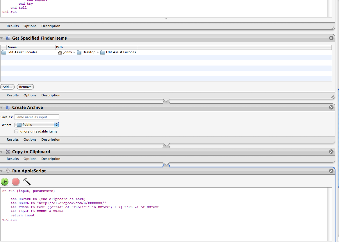

BUT when i run the code by itself - automator says it isn't written correctly...(and it isn't working)
Also is there a problem in the way compressor exports (creates a dummy file appended -1 which is 4k big and is then removed and replaced with a fully exported file when compressing is complete)
The problem is that my 'copy to dropbox' and copy link is happening too soon and so it copies the dummy file.
It all works separately (eg the code to copy the dropbox link and paste it into an email) but its just getting the applescript code to work that makes the process wait for the file to be either copied (so checking the file size until it stops growing) or is more than 4kb but then jumps to the final size for when it compresses. I just need to get the automator workflow to wait for the unique file specific length of time to then proceed to the next action...
any help you can give would be gratefully received!

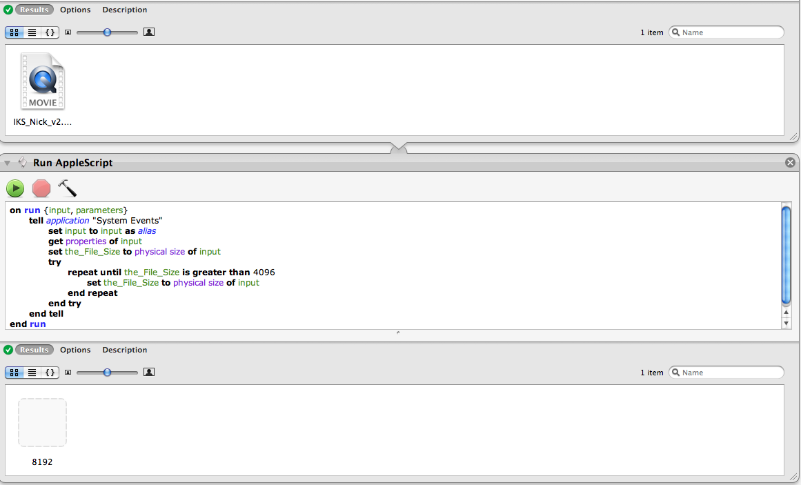

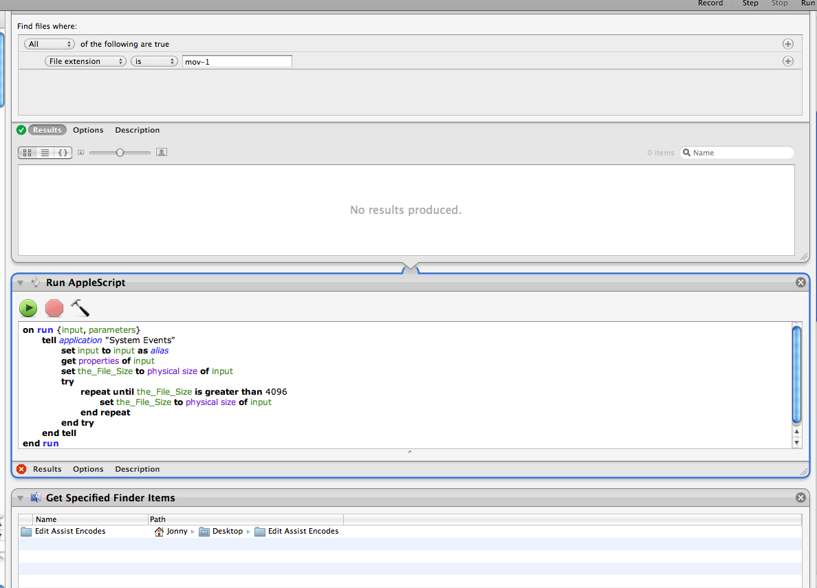

Use another run applescript action
Your Get Specified Finder items results in a folder. If you want to Filter Finder Items,
you should put a Get Folder Contents after the Get Specified Finder items.
To see if understand it correctly :
Your Edit Assist Encodes folder contains the dummy file with extension mov-1 (and 4kb file size)?
When compressor is finished you get a final .mov file in the Edit Assist Encodes folder and the dummy file
no longer exist?

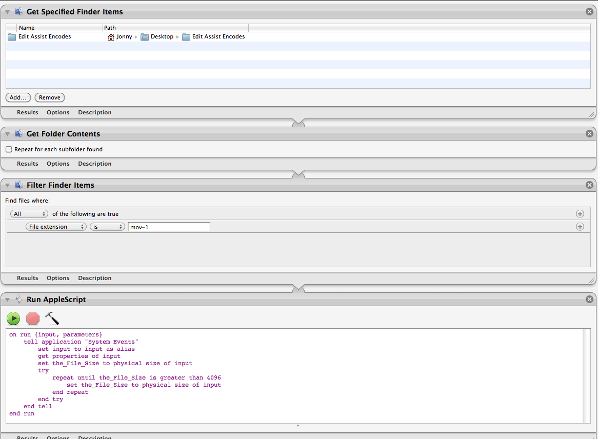

Could you try this please :
Get Specified Finder items --> with Edit Assist Encodes
Get Folder Contents
Filter Finder Items --> filter for File extension is mov-1

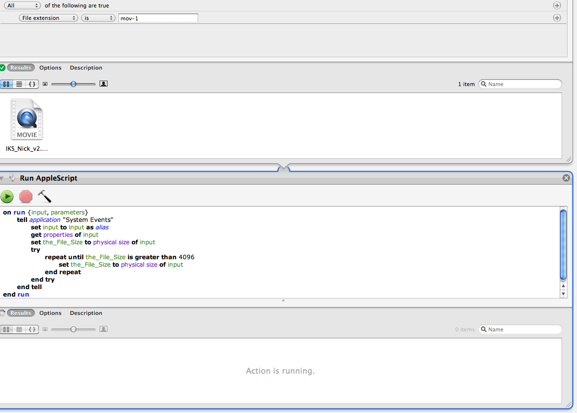

Run Applescript with this code :
Code:
on run {input, parameters}
	(* Your script goes here *)
	tell application "System Events"
		set input to input as alias
		get properties of input
		set the_File_Size to physical size of input
		try
			repeat until the_File_Size is greater than 4096
			end repeat
		end try
	end tell
end run

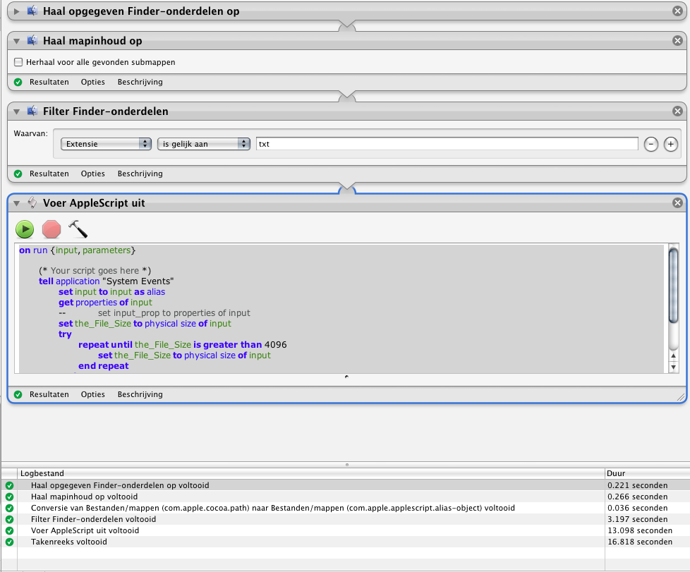

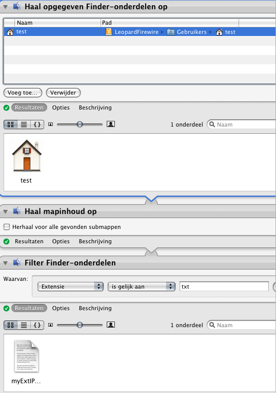

The Run Applescript action will run as long as the mov-1 exists. I've tested this workflow with a 4kb .txt file
and after removing the .txt file from command line in Terminal the Run Applescript action stops running.
After the Run Applescript continue with :
Get Specified Finder items --> with Edit Assist Encodes and ignore input
Get Folder Contents
do your thing with de final .mov file
Attached Thumbnail is in Dutch but shouldn't be a problem. Second action is the Get Folder Contents one.

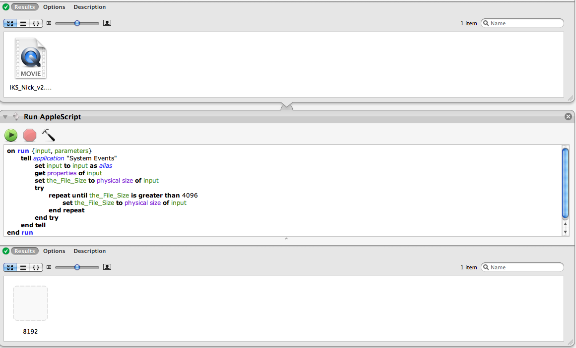

almost!
I think the apple script you provided (and the tweaks to the workflow) is working as now it doesn't jump ahead to create the archive (which then goes into the dropbox public folder and copies the url link into a chrome gmail email.
BUT its not doing any of that part at all now... (as in somehow the output from the apple script into the archive isn't happening??
I've attached a screen grab where your script is at the top and then the transition of the workflow is underneath...
I've probably done something wrong!
(I did try filtering for .mov and having that before the 'create archive' but it didn't work either??)

Questions : You want to create an archive from the final .mov file?
When compressor is finished you get a final .mov file in the Edit Assist Encodes folder?
Can you post your entire workflow as a few tumbnails but with the result of each action like the attached one as example? It would make things easier to debug. You could make something small so it won't take a lot of time for compressor to work on.

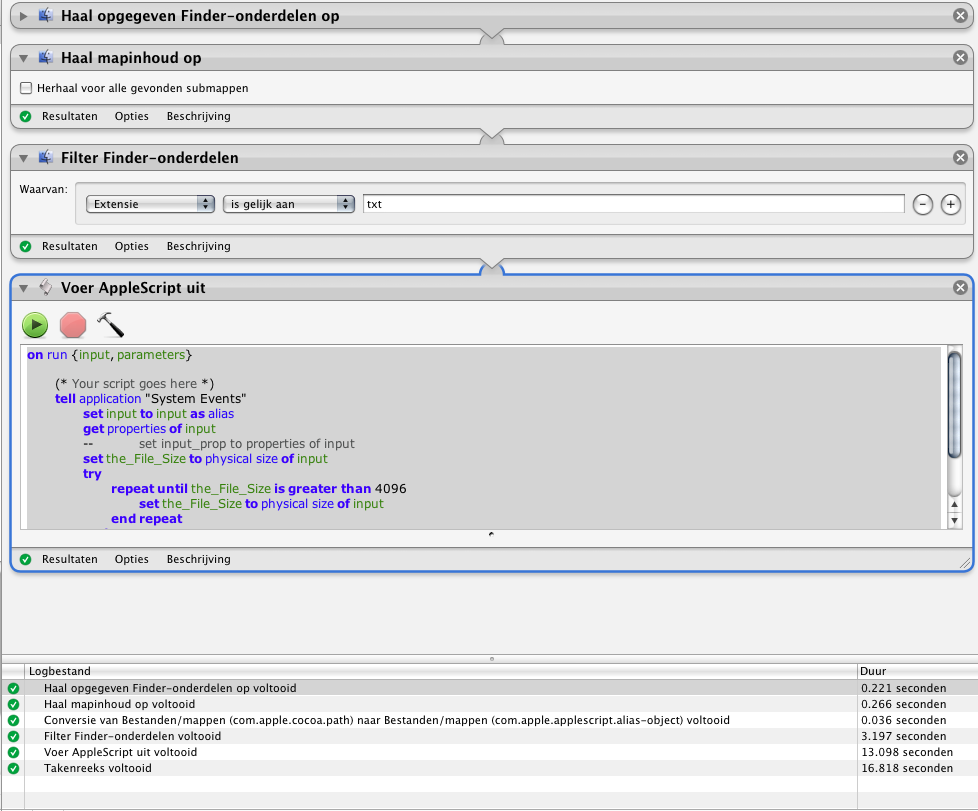

The script you kindly provided is giving up the error:
''Can’t make current application into type alias.''
Any ideas?
No problem
Script requires a Finder item aka an alias as input. That's why it's below the
Filter Finder Items action. It should only do one thing, to wait untill your .mov-1 file no longer exists and is replaced with the .mov file. I'm guessing you're using it below some other action. Will check again tomorrow.

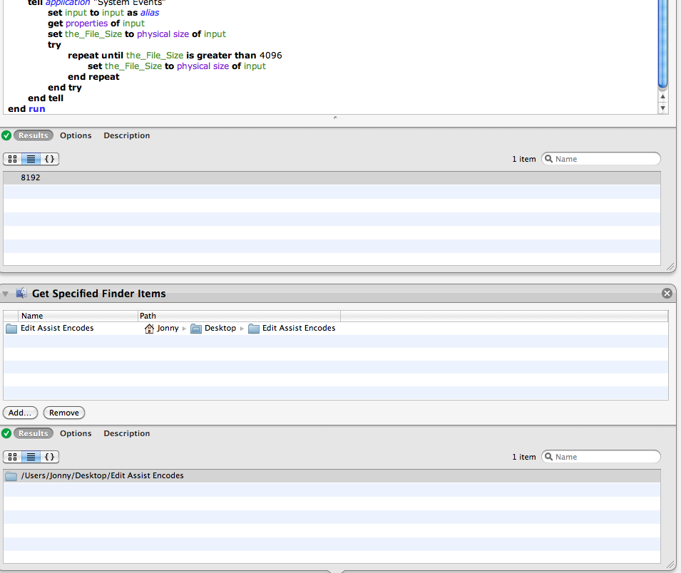

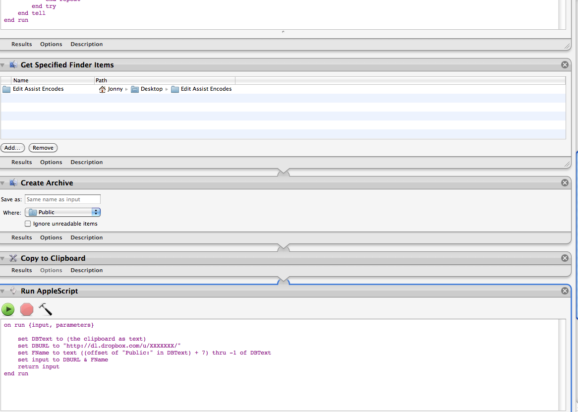

Screenshots for Debug
Here they are in order...

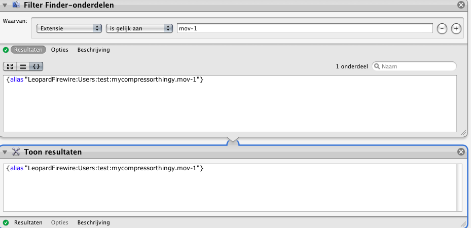

Run worklow to get results

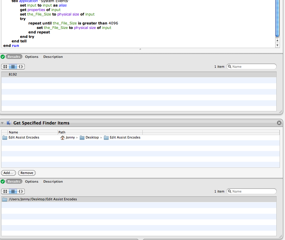

What's the result of your Filter Finder Items action. Do you see a reference to your .mov-1 file like so :
no results - only this
i don't have any such mention??

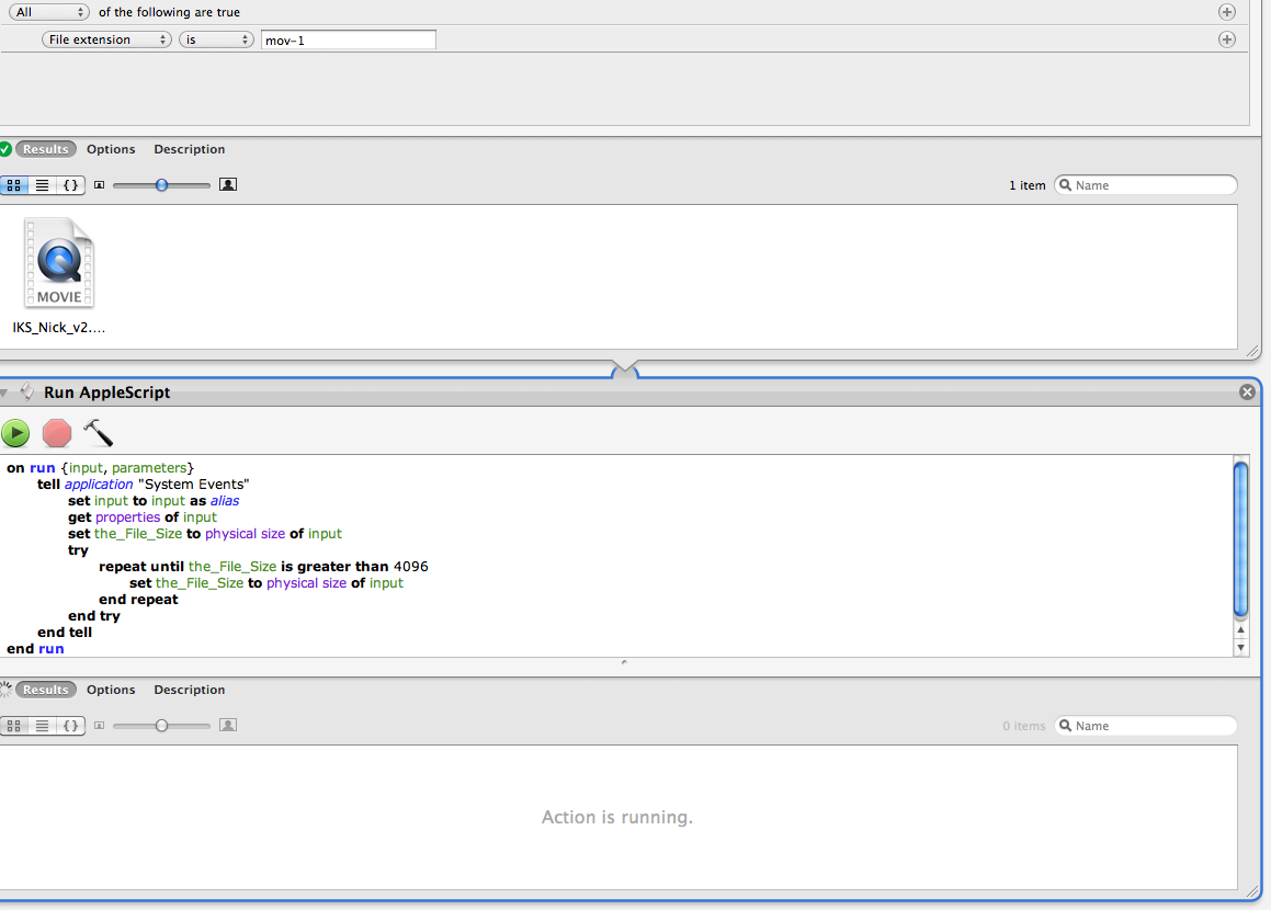

Questions :
Your Compressor droplet exports to another watched folder which is the Edit Assist Encodes folder?
Was Compressor exporting when you ran your workflow? If so there should be that dummy mov-1 file you mentioned.
If you filter for mov file do you get any result?
Can you save your workflow and attach it as a zip file?

So the full workflow is
1. Export from FCP to Edit Assist Uploader Folder
This creates a master file size version (BIG) of the film from Final Cut Pro
2. The Uploader folder has a folder action to run a compressor droplet to create an email-able file. This all happens based on a totally separate workflow that is working fine.
3. The Edit Assist Encodes folder also has a folder action set to run the workflow we've been trying to make work.
4. This is supposed to wait for the compressor file (first a mov-1 dummy file then the real .mov file) to be all there and then when it is, make an archive in the public dropbox folder, collect the url and paste it into an email that is then sent out. (in this case via chrome)
NOW.

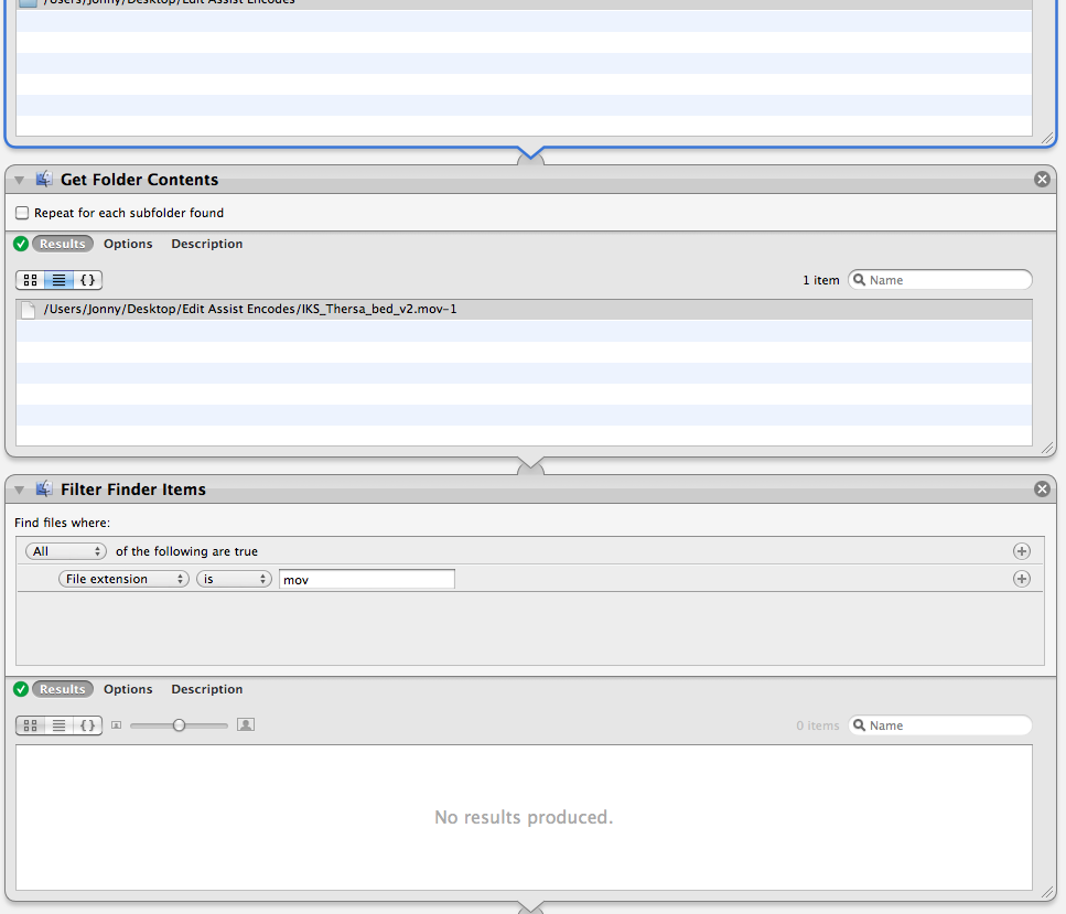

An interesting thing has happened when I ran the workflow (had it open and pressed run) while compressor was compressing so that i could do a debug screengrab. For the first time the whole thing did work (as in it made an archive and sent an email)
BUT when i opened the archive it was still the .mov-1 verison (798k - must have grabbed it part way through??) and not the final compressed version of the file (2.8mb)
I'm not sure why this happened as normally it doesn't work.
Here are the screengrabs for the results info during the compression and after the compression. I've also attached the workflow as a zip.
THANKS SO MUCH!
Thank you for your patience
I have a feeling we're very close to get it working. Could you run your workflow again if it's not to much work but this time with a Get Folder Contents and Filter Finder Items (for mov file) after the second Get Specified Finder Items. Post the result of the Filter Finder Items and Get Folder Contents as tumbnail but with the result shown like this : I mean clicking on the middle button just below result. You can disable all actions starting with Make archive and below to speed things up.

Strange
No work at all! I'm just thankful you're so happy to help! It is very much appreciated!

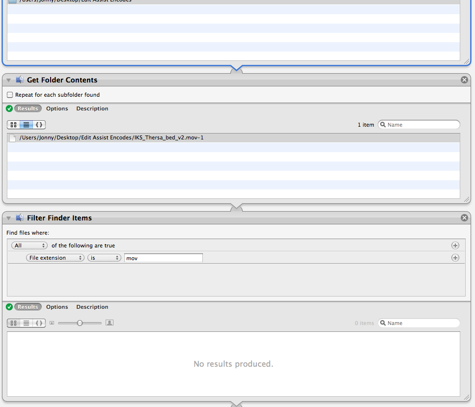

Added those two elements, this time around it didn't work all the way through because it didn't find anything to make into the archive (?). Here are the screengrabs.
Hang in there
As you can see the result of the Get Folder Content is only the mov-1 file. Perhaps it takes some time for the mov-1 file to be replaced with the final mov file. Can you run something through compressor again but this time open a finder window showing the contents of your Edit Assist Encodes, no need to run the workflow. Normally you would see your mov-1 file (of that we can be certain) but the interesting part would be to see your mov-1 file change into the final mov file. Don't worry I've a few more tricks up my sleeve. If push comes to shove I'll install FCP. It's on a backup disk of mine, i'll have to search for it though. I think it's FCP 4. Can I make a compressor droplet with that version?
When compressor is working could you open Terminal(you'll find it in your applications-->utilities folder) and paste this command into the Terminal window and press return : ps -xco command > psoutput.txt
Do this again when you see the mov file in the finder window but this time change the command to this : ps -xco command >> psoutput.txt
Post the psoutput.txt as attachement. The file is in your home folder.

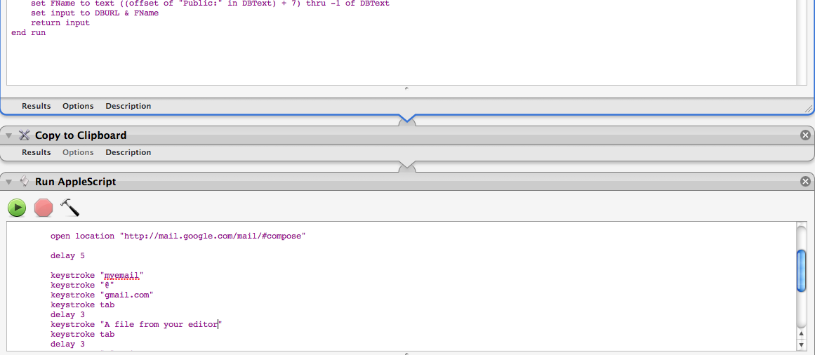

From the start of your post I was thinking there's got to be a way of scripting this. After all it was FCP an Apple product. As you were trying to use Automator I hadn't given it any more thought. But tonight I decided to dive in a little deeper and guess what. I found this on the net :
Compressor is a file conversion utility included with Apple's Final Cut Pro. It's very handy. There's an option in the preset inspector to run an AppleScript upon completion ("Execute action on output").Just copy/paste this into Script Editor, save it as an application, and attach it to your Compressor preset using the Applescript checkbox mentioned above.
Code:
-- It will be up to you to test it but I think it would be best if your final mov file would be the only file that exists in the Edit Assist Encodes folder
-- I'm putting numerous comments in the script to clarify things a bit
on open (thefiles)
	--setting the_Encoded_Folder to /Users/jonny/Desktop/Edit Assist Encodes --> this is POSIX path notation
	set the_Encoded_Folder to (path to desktop as text) & "Edit Assist Encodes"
	-- setting the_Public_Folder to /Users/jonny/Public --> this is POSIX path notation
	set the_Public_Folder to (path to public folder)
	--There should only be one file, but just in case send it through a loop
	-- I've disabled the loop. I think we don't need it. I could be wrong. We'll see when you run the script.
	repeat with thefile in thefiles
	end repeat
	-- Next we make a zip file with a name of Edit Assist Encodes.zip of the Edit Assist Encodes folder in the Public folder. The workflow would do the same. The Get Specified Finder Items would result in the Edit Assist Encodes folder. The Create archive would result in an Edit Assist Encodes.zip file in your Public folder because same name as input in the save as box is used.
	do shell script "ditto -c -k --keepParent " & quoted form of POSIX path of the_Encoded_Folder & " " & quoted form of POSIX path of the_Public_Folder & "Edit\\ Assist\\ Encodes.zip"
	-- Next in the workflow the result of the Create archive would be copied to clipboard which would give this as result /Users/jonny/Public/Edit Assist Encodes.zip. We get the same by using the next line.
	set the_Folder_Archive to (path to public folder as text) & "Edit Assist Encodes.zip" as alias
	-- Next in the workflow was a bit of code related to dropbox but this line : set FName (offset of "Public:" in DBText + 7 thru -1 of DBText resulted in garbage. I'm guessing you were aiming for this kind of result : "http://dl.dropbox.com/u/xxxxxxxxx/Edit Assist Encodes.zip" If so we use this code below : BEWARE no file is uploaded here I think or it's something I'm missing. I don't use dropbox. The only thing done here is composing an URL.
	set DBURL to "http://dl.dropbox.com/u/xxxxxxxxx/"
	set the DBTextInfo to info for the_Folder_Archive
	copy displayed name of DBTextInfo to FName
	set input to DBURL & FName
	return input
	-- The result of return input would be "http://dl.dropbox.com/u/xxxxxxxxx/Edit Assist Encodes.zip" In the workflow it get's copied to the clipboard and passed on to the next bit of code of opening Chrome and composing a mail. But it's not used in the tell block. The return input result after the end tell would result in the same result as the one after set input to DBURL & FName namely "http://dl.dropbox.com/u/xxxxxxxxx/Edit Assist Encodes.zip". I admit this baffles me a bit.
		tell application "Google Chrome" to activate
		open location "http://mail.google.com/mail/#compose"
		delay 5
		keystroke "youremail"
		keystroke "@"
		keystroke "gmail.com"
		keystroke tab
		delay 3
		keystroke "A file from Jonny Elwyn"
		keystroke tab
		delay 3
		keystroke "v" using command down
		delay 3
		keystroke tab
		keystroke return
	end tell

Hey Kryten2
Thanks for all your hard work - and not at all intrusive!
First of all here is the psoutput text which i did during compression and after.
(i couldn't really make heads or tail of it!)
Secondly - thanks for the script! I shall test it out. I did know that you can add scripts to compressor outputs, but the thing is that I wanted to be able to export a master file from FCP and then have compressor kick in later.
BUT because the first part of my workflow (A watch folder with a compressor droplet attached) is working, I guess there is no reason not to append an apple script on the end of the compressor droplet - thereby saving the hassle of the compression watcher not working.
So onto your script.
The bit that 'returned garbage' in the dropbox section is because the archive from Edit Assist Encodes is being copied into machd/users/dropbox/public/
which is like a private ftp section and each file gets given a unique url to send to whoever you want to download it.
In the code i posted on the net I had removed my unique dropbox number and replaced it with lots of XXXXX for privacy.
In the workflow version the archive is created based on the exported filename from FCP which is carried over to the compressor output. But in your script it looks like every zip file would be called Edit Assist Encodes.zip
Is there a way to keep it unique to the file name?
I will try adding the second half of the automator workflow to the compressor droplet and see if that works from start to finish!
Success!
Well your thought about compressor inspired me to try the automator workflow another way.
This is how it is now working....
1. Export from FCP to watch folder
- runs folder action to run compressor droplet (with new apple script ending)
2. Compressor compresses file into Edit Assist encodes and runs the second half of the automator workflow (creating the archive, uploading to dropbox and emailing)
success it works!
Thanks so much for all your time, effort, patience and insight!
I only wish you could make use of it!
Many thanks again!
