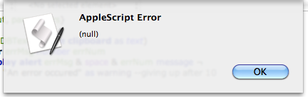

error message p2
hope you weren't up late just for me!

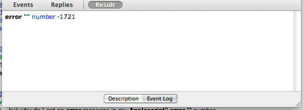

Right I ran your code in both the workflow itself and on its own and I get the same message.
The workflow (archive email etc) does work perfectly, its just getting it to work by being fired up from a script run at the end of the compressor droplet.

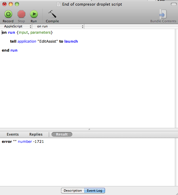

If you see the third attachment I added the {input, parameters} to the run line and that gave me the same error code.
This is the only bit that's not working for some reason, this tiny code to launch my edit assist app (which is just the part 2 workflow saved as an app)
Can i change the tell application line to tell it to launch the workflow, what would that be?
Thanks so much
Jonny
You can but before that could you try this as compressor droplet script(remember to save as application!) :
Code:
on open (theFiles)
repeat with thefile in theFiles
display dialog thefile
end repeat
tell application "EditAssist" to launch
end open

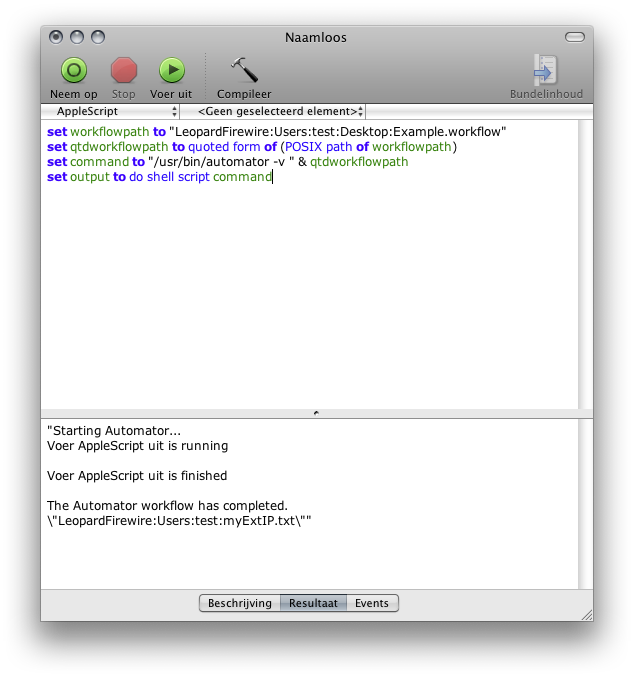

For the workflow :
Save your EditAssist Automator app as an Automator workflow (.workflow file)
Code:
-- change line below to where you saved your .workflow
set workflowpath to "Macintosh HD:Users:martin:Desktop:Example.workflow"
set qtdworkflowpath to quoted form of (Posix path of workflowpath)
set command to "/usr/bin/automator -v " & qtdworkflowpath
set output to do shell script command
Also put the above code between an on open (theFiles) handler. First run it without the handler. Good luck.
Try to run the worflow code from scripteditor as well you'll get some results in the result pane.

The second code worked fine, and previous codes have worked fine.
I think the real problem now is that Apple Compressor 3.5 is not executing the script when it finishes encoding. I'm trying to find out why this is the case.
As suggested here http://www.proactiveinteractive.com/software/compressor/index.php
I tried saving it as an app with the 'on open (theFiles)' handlers but it still isn't working. Every script i write works just fine 'outside' of the compressor section of this ordeal. but i can't seem to get it hold together!
Think this is a compressor specific problem (which is why i had tried to do this part with folder action code before)
Unfortunately I can't test this in real life with an example. Compressor 2 on my Leopard install (ppc hardware) runs just fine but qmasterd process crashes within seconds and on my Tiger install it's the other way round.
