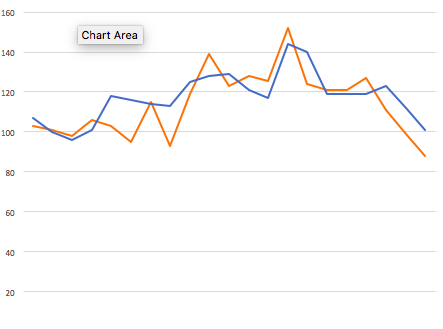

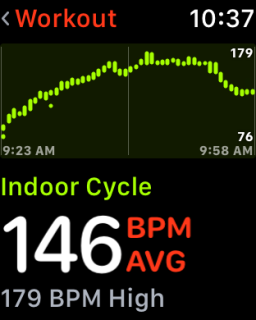

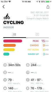

The top photo shows data collected by my AW3 and data calculated by Apple Activity App's Indoor Cycle program.

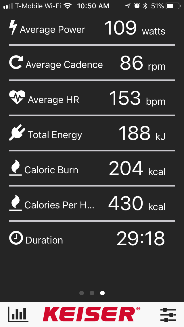

The bottom photo shows data collected by Polar H2 chest strap and keiser m3i bicycle which uses magnetic resistance.
The HR at any given moment was usually within ±2.
Average HR was 156 vs 153, Apple's number is 3 points higher.
The calories burnt were 228 Cal vs 204 Cal. Apple's estimate was about 10% higher.
Overall, I am quite impressed by the accuracy of AW3 HR sensor.
I do not enjoy wearing the chest strap because of obvious reasons. The watch on the wrist is much preferable. If the m3i bike app programmer can incorporate AW HR monitor into their app, I would not have to wear the chest strap at all. I will contact them someday about this.
*I started the exercise bike app after I started pedaling so the duration has slight discrepancy. The app is on iphone and it does not start automatically when I start pedaling.
The Activity app was programmed on my AW3 with the target of 225 Cal to burn.

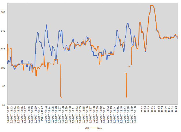

So I've had 3 hikes now and it's been wrong on all of them. Basically what is happening is it is in certain situations (it looks like when my heart rate is ~140) it halves it. There are lots of spots where it goes from 130-70 then to 150. When I compare to the other wearables (including my other AW 2) they all say 140.

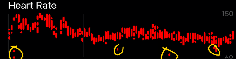

Here is an example of the best hike that I've had. I've circled the items that were off. This is the best hike so far. Most of them have had a lot more issues.

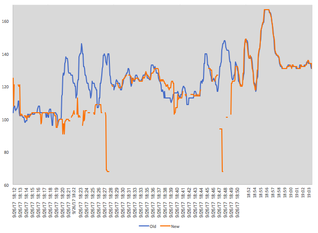

Do you have the LTE Series 3 one or the GPS only series 3 one? I'm wondering if there is a difference between the two in terms of the heart rate sensor. For example, my series 2 has grey circles (about 1/4" thick) around the LED lights, but the series 3 doesn't (and as far as I can tell the cellular series 3 does).
I did the same hike with my series 3 and series 2 on different wrists at the same time. (Switching about halfway through). You can see the series 2 works well the whole time, but the series 3 doesn't do well until the light gets pretty low at which point it matches perfectly. The series 3 data has a bunch of gaps as well (some minutes where it only recorded 1-2 records) whereas the series 2 is pretty consistent about reading the heart rate regularly. I just updated my series 2 to watch OS 4, so I will see if now it starts having issues as well.

Ok. So tonight I tried my series 2 watch on watchOS 4 after I upgraded it (the one in my previous post with the comparison graph that starts "Do you have the LTE Series 3..."), and it appears to have similar issues as the series 3 watch. Not quite as bad, but still underreporting a significant portion of the time close to sunset. This leads me to suspect it's a software issue. Hopefully that means it will/can be resolved in the future. Looking at my history of HR data over activities, it seems like it was improving the longer I had worn it. Do you all have the same experience? Does it seem to be getting better over time?
