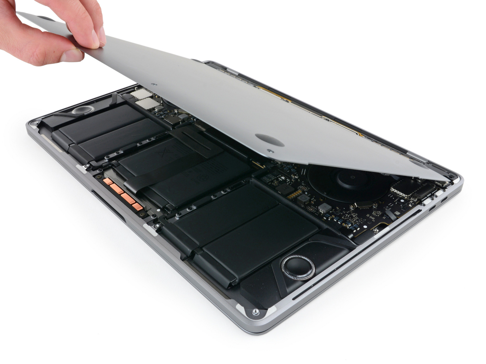

Would you risk an Apple Store repair for a back-cover that is not flush?
Could this be a sign of battery expanding?
Its probably less then a 1mm, and on both sides.
Opening lid also makes sound, I imagine this is the culprit, case is bent from factory somehow.
I've read so many repair stories gone wrong, I'm worried to take it in.
https://ibb.co/fARGhT
That’s a battery expanding. It’s unlikely there’s a bottom case defect, just at the front, where the battery pack is located.

So I've to take it in :/
Will they replace the whole thing? or just battery? Since its bent.

The battery is glued into the topcase. You'll get a new topcase (main body of the computer) which includes the battery, trackpad and keyboard. A good tech would asses the entire device and repair all issues if covered by warranty, but be sure to mention ALL issues you are aware of when submitting it for repair to be sure they don't overlook anything.

First of all, the battery is not located there, so cannot be the battery expanding the problem.
After one of my top case replacements, my bottom cover was exactly the same and I just pressed on it hard on that side and clicked in and is 100% flush now, so probably just a small issue from assembling the device.

NOPE - If that's a battery issue (and may well be so), best get it sorted sooner rather than later. And the OP is correct, if you pay premium price, you expect premium quality. This isn't a cheapo £30 Android tablet, it's a £3000 MacBook Pro. And as for wear-and-tear, that's nonsense too. I have a Mid 2015 MBP that's as clean and tidy today as the day it came out of it's box, and a CMP (2006) that happily running as a server with loads of disks in, that still looks like it's on display at the Apple Store.
You are right not to worry too-much about wear and tear, but this is NOT wear and tear.

Take it back to an Apple Store and let them look at it.
The battery is located there. You had a re-assembly issue from a repair but OP's notebook is new.

what are you talking about? you can clearly see that the un-flush part is at the top (near the screen attachment) by the ports, no battery there...
@OP
I do not know if it is a expanding battery, but if you want to be sure take it in and explain that you noticed the bottom was not flush and that you want to be sure it is not an expanding battery causing this. In any case they will take the back cover off to check it, if nothing is wrong reapplying the back cover might fix the issue with it not being flush as the original placement of it can have been a little off.
Having removed the back plate on my model a couple of times I found that putting it back can be tricky and you can get it a little off.
