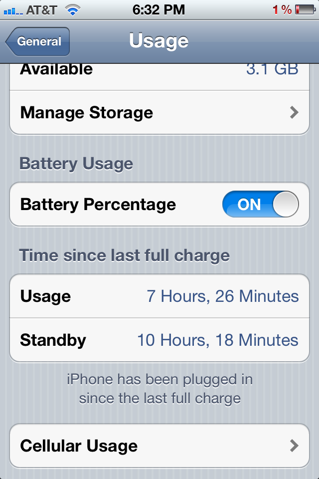

I am already on my 2nd phone. Exchanged at Apple due to bad mute switch and bad sensor. My replacement is acting up. Horrible battery life. For example, fully charged before bed Tuesday night and then left it off charger overnight. Woke up at 6 am and had gone from 100% at 11pm to 65% overnight with no use. Had a terrible day with battery all day yesterday. Phone was draining 1% every 3 or 4 minutes with little use. Was also running very hot. Restored from previous iPhone 4 backup. Never set up as new. Clearly this is an iOS issue and not hardware.
Last evening I followed some of the suggestions found in posts and removed unused apps, turned off location services, turned off iCloud, turned off push, reset network settings, turned off everything is spotlight, turned off notifications, deleted and removed all email accounts and manually re-entered them. Then fully charged the phone before bed and when I woke up this morning, I had only l lost 7% over night. Topped it off this morning and then I made it through the entire day today with almost 7.5 hours of moderate use and more than 10 hours of standby. I also have been turning things back on throughout the day to keep an eye on any rapid draining or heat. I think I have narrowed the issue down to location services and/or iCloud. Both I can live with off unless needed.
By the way, my log showed a lot of low memory warnings as well for what it is worth.
