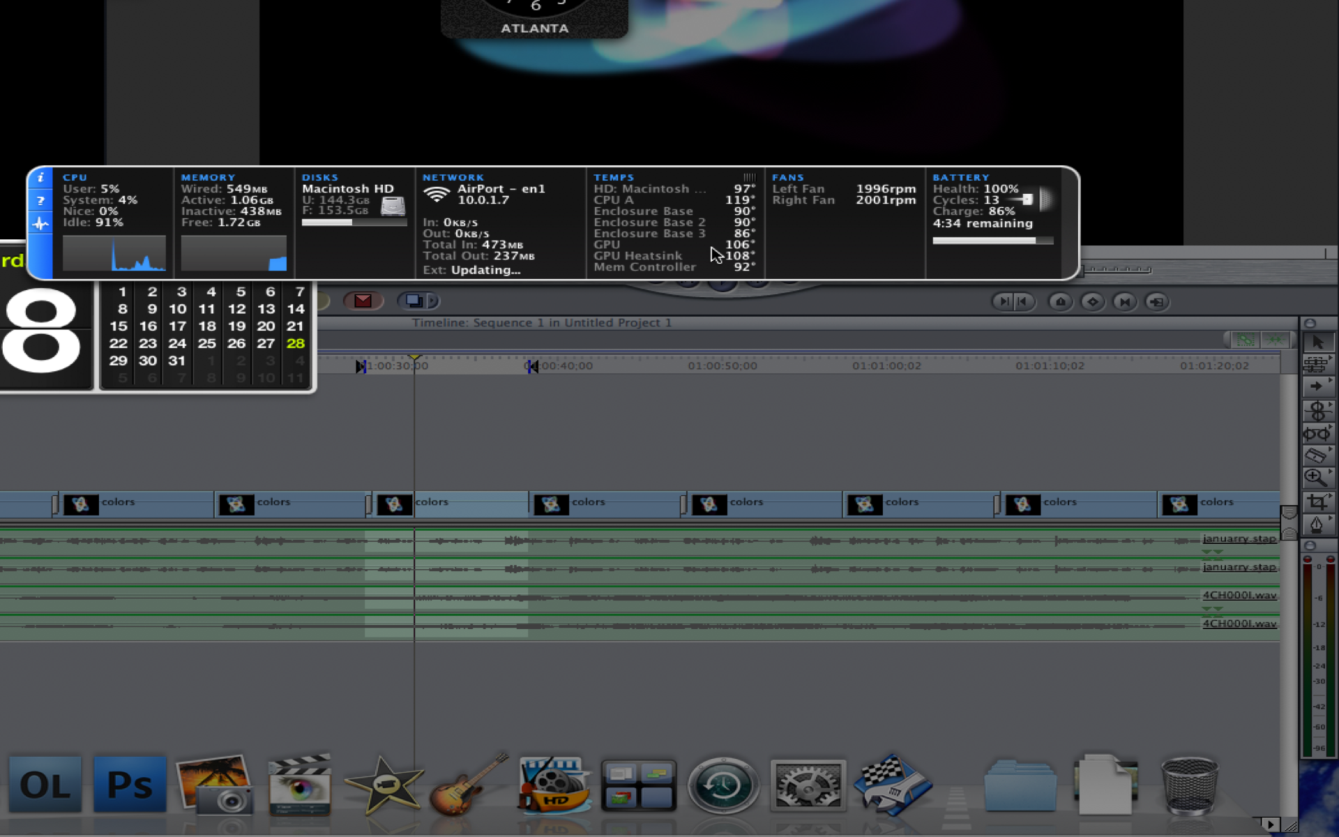

here is a reading showing only CPU A
look at this screen shot

my bad
I didnt realize that there is only CPU A must be really tired
lol
Okay, I think you're getting confused.
CPU A = CPU Diode
There is only ONE CPU Diode in the entire system. The Diode contains 2 Cores within sharing a 6MB L2 (or 3MB L2 depend on what CPU you're using) Cache shared between both Cores.
Tell us, what tests you have run to determine your CPU is actually "broken". Look into "Activity Monitor" in /Utilities and see if it shows both CPU running any usage (anything above 1%).
