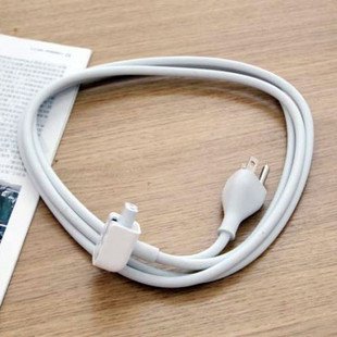

Hi,
Try this: your MacBook should have come with a 3-prong plug extension cord for the charger (images attached). Use that. That extension cord has a ground cable in it so it should negate any static shock.
Hi,
Regards
Raptor
Maybe - but if the static build-up is on HIM the earthed cable just facilitates the discharge to earth :)
