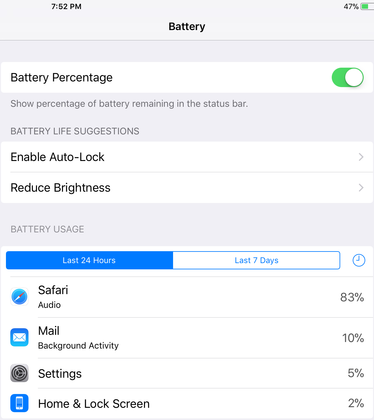

Please let me know if you get this resolved. My iPad is doing about the same thing. I’ve tried putting it on airplane mode all day and the battery still drains. This all happened after iOS 11. Here’s a snapshot of my battery status and remember this snapshot is almost twenty four hours of non use after screen was put to sleep and all windows and apps were closed.

If the problem was due to an older app, battery settings wouldn’t show Safari as the culprit. It would show the name of the old app. Right?
