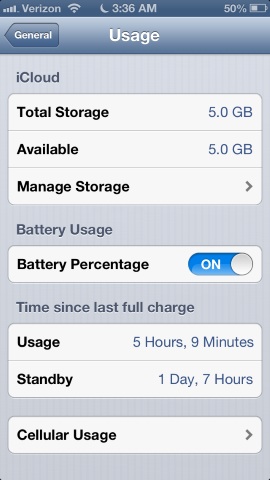

If you get 8 hours of average use and only lose 7% battery then I want to know where you got your iPhone from, because that is a bunch of lies.
You got any screen shots of this super battery you own?

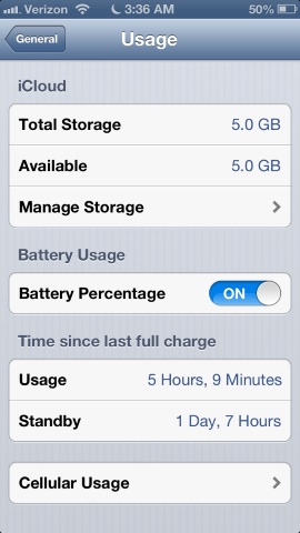

Verizon...
