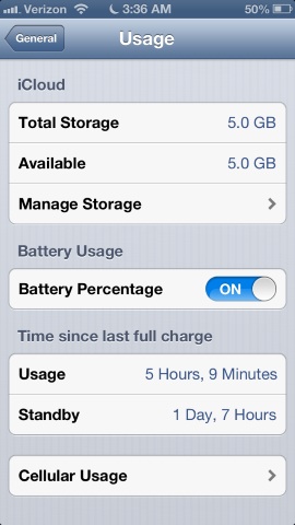

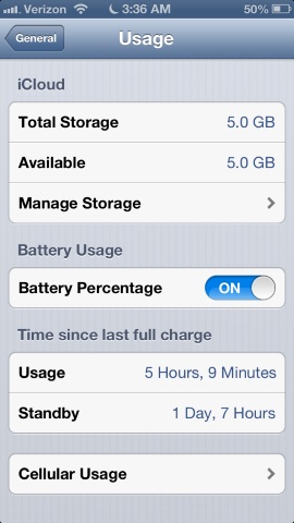

If you get 8 hours of average use and only lose 7% battery then I want to know where you got your iPhone from, because that is a bunch of lies.
You got any screen shots of this super battery you own?

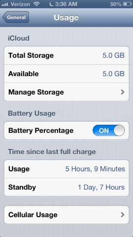

My new ip 5 seems to get about that with no jailbreak...
X2
There is no way in hell that guy is getting 30-35 hours with medium to heavy usage either.
I was lucky to make it through the day with heavy usage before the jailbreak and its no better now.
That's about what I get on my new iPhone 5 before jailbreak...

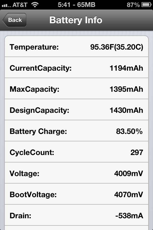

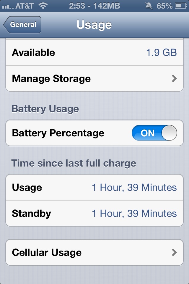

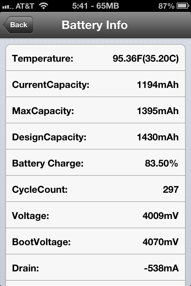

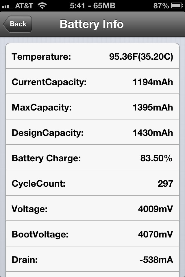

Here is a screenshot of my phone yesterday. After about an hour and a half it's already down to 65%. The phone is almost always warm to the touch. There's also a screenshot from BatteryDetective. Shows a lot of drain and battery temp. That's with nothing running in the background.
edit - I know that the true battery capacity was higher before all this started and it is going down alarmingly. I think that whatever is draining the battery is wearing it out faster as well. FML.
I guess I could try the temp restore and see if that helps.

I'm pretty convinced at this point that there was *something* inherent in my phone left over from previous versions that was being carried over by restoring backups. This is the only thing I can attribute to my battery not draining now.
It's been in standby for about 90 minutes now and it is still at 100%. If you look at my previous attachment it shows that my phone was down to 63% after the same amount of time.
