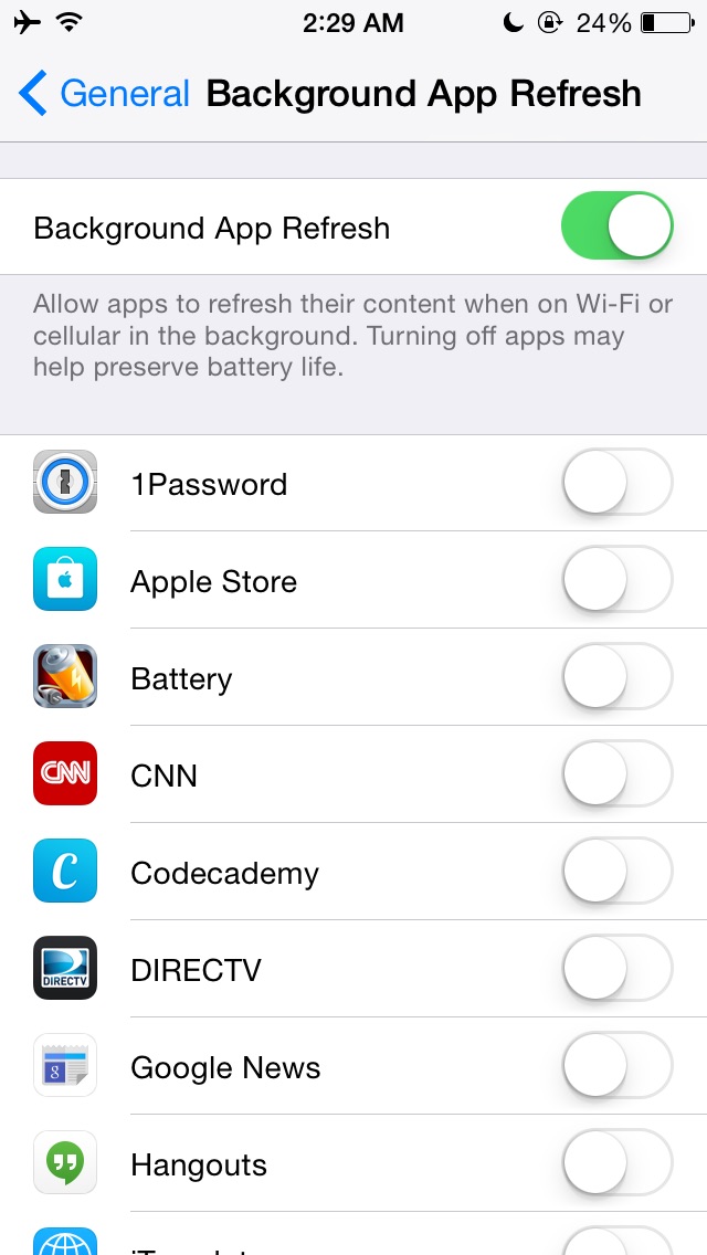

You might want to take a look at these settings...
unfortunately, it's already off, and i also close all my apps before i turn my phone off.
