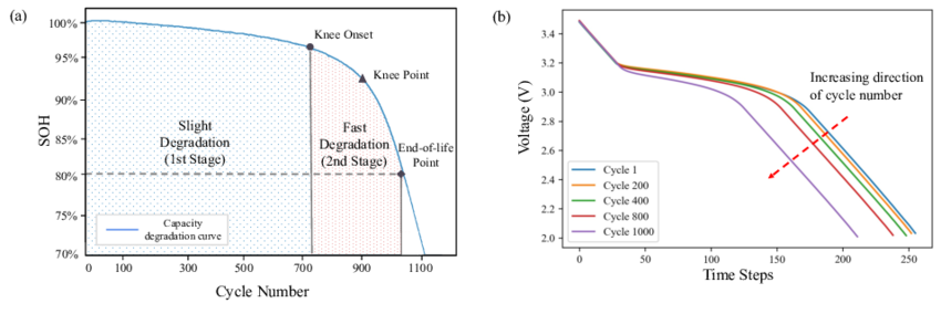

As @russell_314 and @mrochester stated, the original capacity is typically above the designed, targeted, advertised level, which is good. However, because Apple doesn’t show err report to the user greater than 100%, the perception is skewed as to how long the battery maintains full capacity.
As @FeliApple described, capacity over use has an initially medium slope, then things almost level off as the battery chemistry settles into a comfort zone (so to speak), and the capability finishes with a nosedive.
The following graph provides a decent depiction.
Here’s an actual Apple device example.
ipad-6_coconutbattery_final-log-png.2470596
I had it plotted, and it looked similar to the referenced graph. Unfortunately, I can’t locate which battery thread I originally posted the log visualized.
By the way, the recommendation to replace a battery at below 80-percent capacity is just an averaged, estimated guideline. Also:

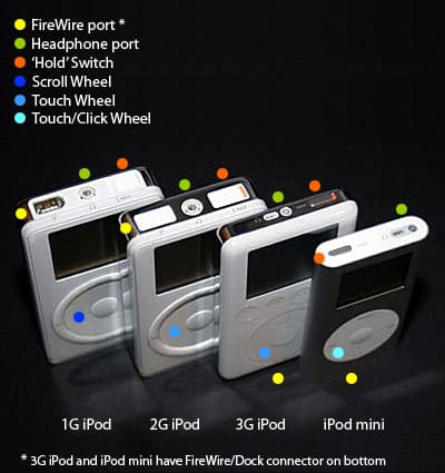

But seriously… To the numerous selfish, greedy *********, not showing that extra two to six-percent is still “lying.” They’ll continue to claim, “it was at 100% for [x] months, and now it dropped [several]% in just a few months.” Whether willingly ignorant or not, the people complaining are simply about pursuing more undeserved handouts.
And less we forget:
What is a “Battery Failure?” A third-generation iPod has experienced battery failure when “the capacity… to hold an electrical charge has dropped to four hours or less of continuous audio playback, with earbuds attached,” while first- and second-generation iPods have failed when they get “five hours or less of continuous audio playback, with earbuds attached.” Surprisingly, the definition does not mention whether the numbers need be reached with or without your screen’s backlight on. Regardless, your battery must have failed within two years of the date of purchase.
Basically, arbitrary nonsense.
