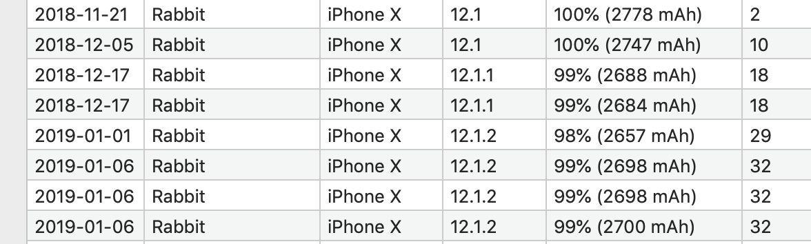

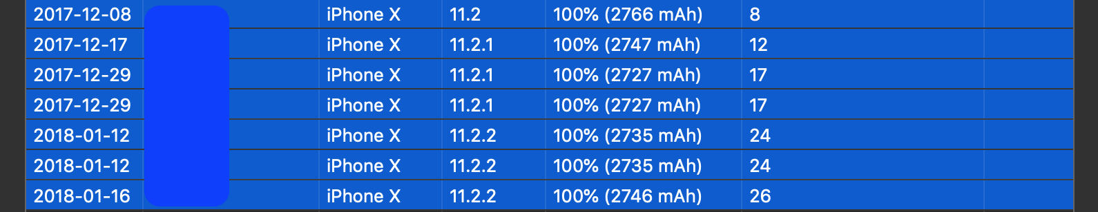

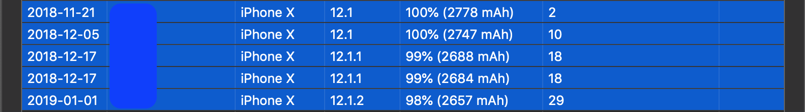

My old iPhone X was replaced under warranty and the replacement unit had a new battery with 100% health. After about ~30 cycles it's already down to 98% in just over a month. Please take a look at the info from coconutBattery below. Is this abnormal or is it because of iOS 12?
Old phone:
Replacement:
I have the exact same issue and in the exactly same conditions new device that got replaced and after 37 charge cycles I'm down to 97% and I've always used the stock charger and wire!!!
Someone help me please $1400 is not that easy to come by and I really don't expect to face so many issues especially due to the high price tag! If someone did find a solution please help us out
I talked to Apple Support; they ran diagnostics and said the battery is fine. I started turning the phone off overnight every 2 days and also decided to charge it only after it goes below 20%.
coconutBattery says the capacity is 99% again but iOS still shows 98% so you got that right.
