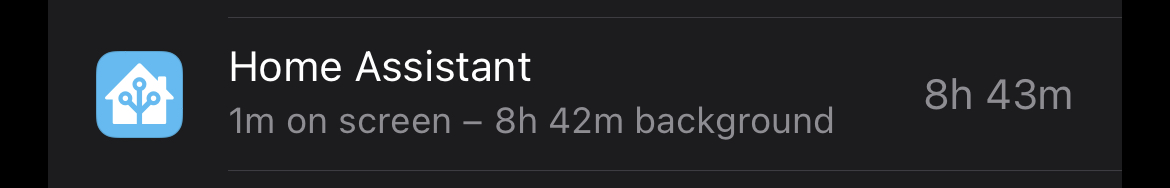

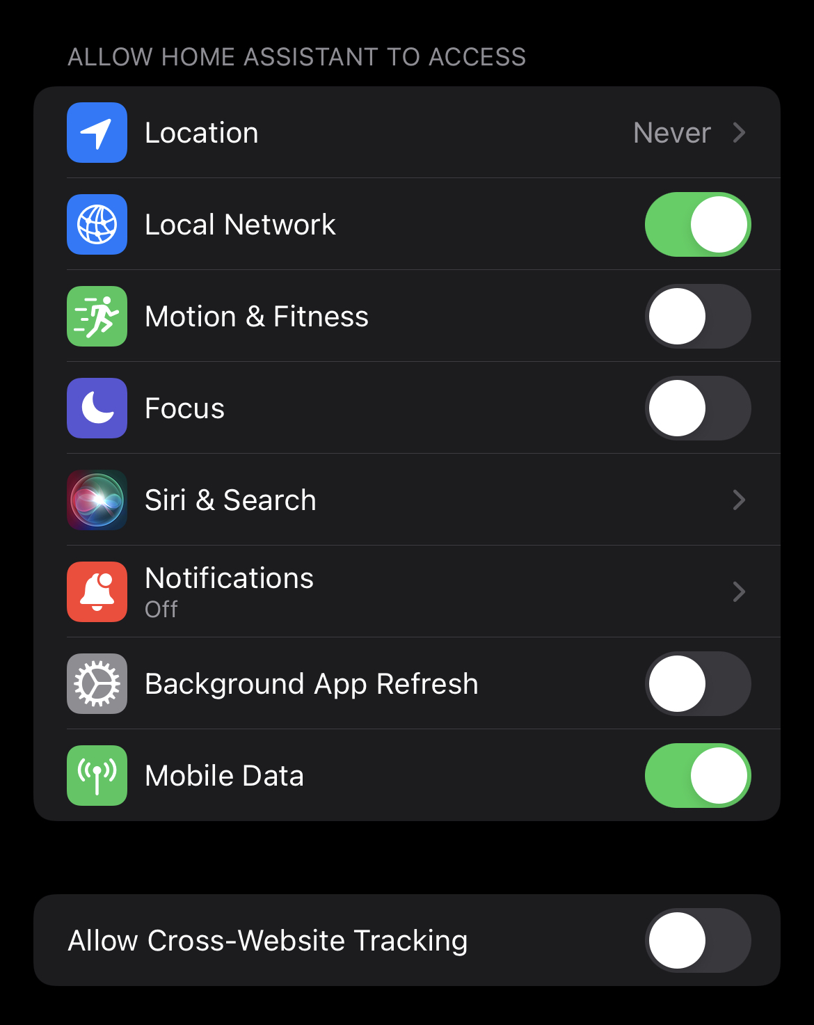

After a few days I found the problem. It was the „home assistant“ app. When I first installed it, I have it all the access to sensors and so on (mostly to try stuff with automations).
I already restricted the access to sensor data, background refresh and so on. But it seems that the app still was able to do those things.
As soon as I deleted the app, the battery drain went down.
Today I reinstalled the app and didn’t give it any access to anything.
Funny thing is: the app never showed up in the battery overview.
So how is this possible?
