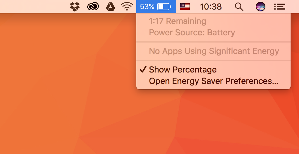

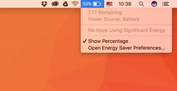

This seems problematic...

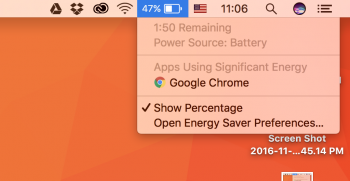

Quit Chrome for about 10-15 minutes and web browse with Safari?
Chrome is horrible for memory and battery...granted, i'm not telling you to not use Chrome...i'm simply trying to rule out the program that is using significant usage.

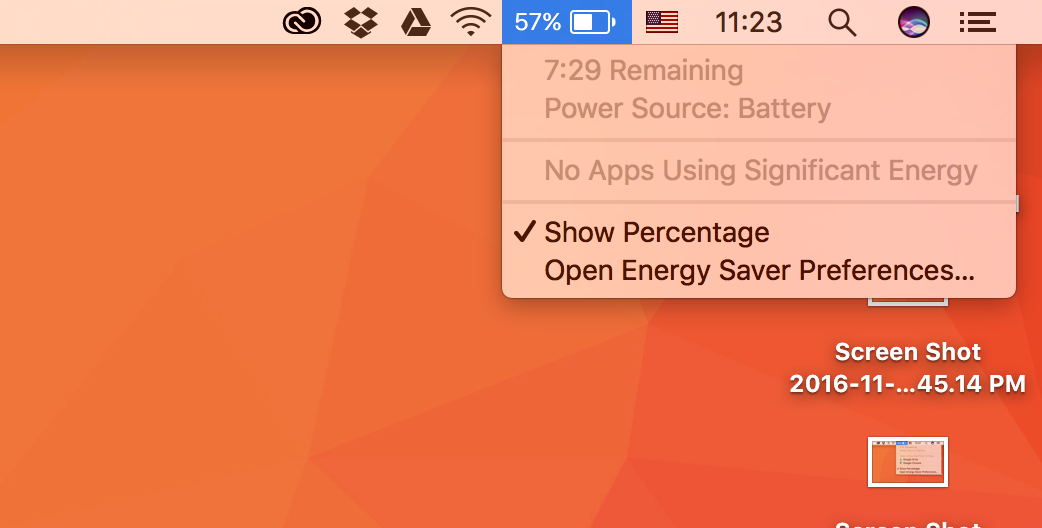

So... this now got more interesting. Now it shows 7:30 remaining?!? I'm so confused...
One problem is you plugged in after turning off. That should turn it on (the new way this works).
Turn it off (keeping it plugged in) and run through the steps again (but don't mess with the power cable).
yea u did the smc correct since its showing that now , when i did it i actually didn't connect the charging cable at all so it don't turn on the computer but i can tell it work for you so now jus charge it to 100% and then go from there.

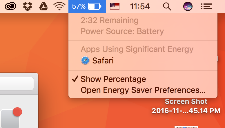

Just did so as you suggested. Lemon? Here's what it's showing now:
I don't think you have a lemon (more so than anyone else). Charge your computer to 100%, pull it off the charger. Use it for about 20 minutes and then look at how long it estimates.
