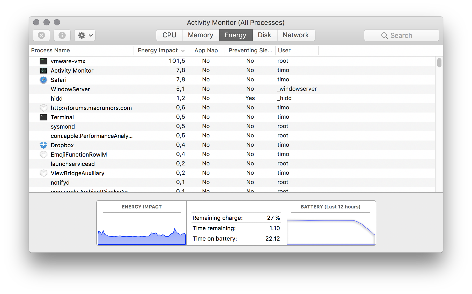

13" non-TB i5/16GB/1TB, fresh install and SMC/PRAM reseted.
About 17 hours in sleep and last 2-3 hours under quite heavy use because of VMware Fusion and Windows 7 installation and updating.

Hey guys, so here are my stats 24 hours after reinstalling the OS.
I am pretty much happy with the stats, best thing is, its not draining the battery in sleep now.

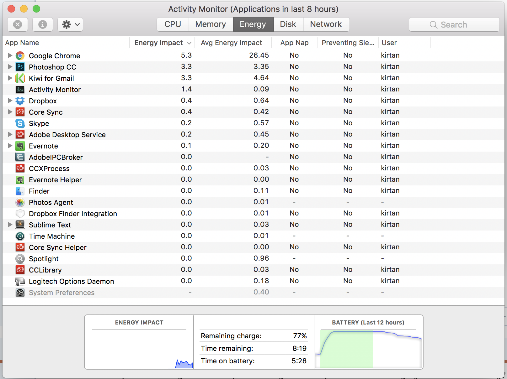

Did you do the step of seeing what's draining the battery? If you run the battery monitors, even just the built in Activity Monitor, you can see what the offenders are. It might surprise you that otherwise considered lightweight apps are drawing significant power. You can than make the call if you can live without that app constantly running. Normal draw for me is about 5-6 watts. You must be in the 8-9 range based on your battery life. Something is killing it.
