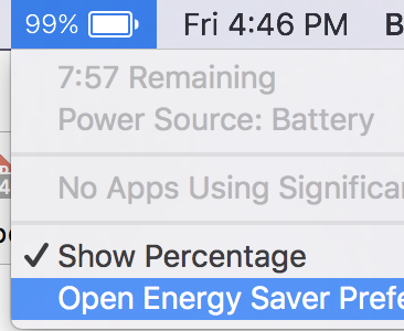

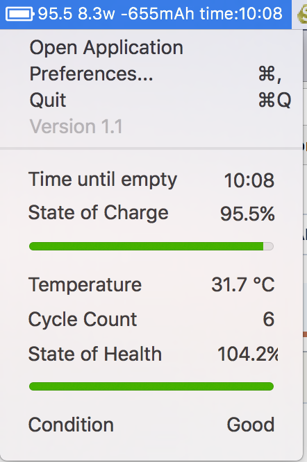

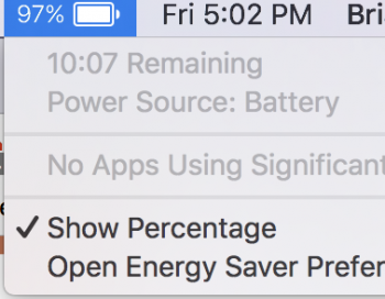

I did a reinstall of 10.12.1 (not beta) which kept all my stuff (just wiped/installed MacOS). Now my battery remaining is in the bar, and it's saying 5:57. Coconut is saying 10hours. Which is way more than it was saying before. Also watts are only 5.7 in Chrome. I recommend making a boot USB and reinstalling MacOS to see what it does for you. Can't hurt.
edit - keeps going up.

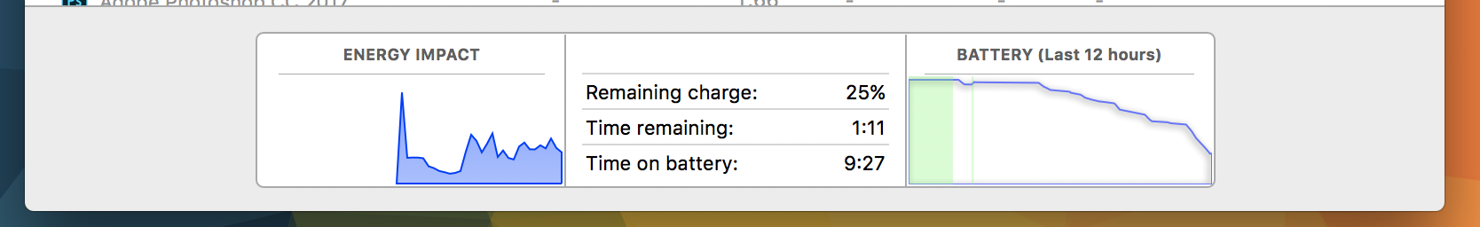

And this is real and totally accurate... 9h 27m ON BATTERY with 25% remaining. The remaining time makes no sense but the 9h 30m is confirmed from a stopwatch.
You can see in the chart this included well over an hour of what appears to be standby time?
Nope, been using it the entire day.
For about an hour+ my battery % didn't change whatsoever, including Coconut Battery... seems like a software glitch far more than hardware.
