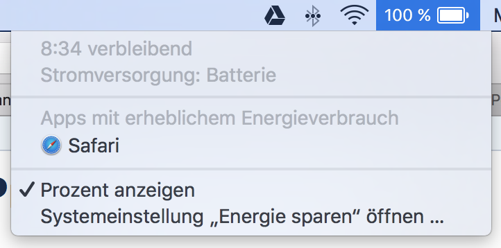

So another try with a full load.
Just browsing and it's showing 8,5h , which would be okay for me. About 60% Brightness.
Clean install without migration, Sierra fresh install, Rest NVRAM&SMC - 13'' i7 16 512
Let's see how it goes... it really seems now to be a software thing.

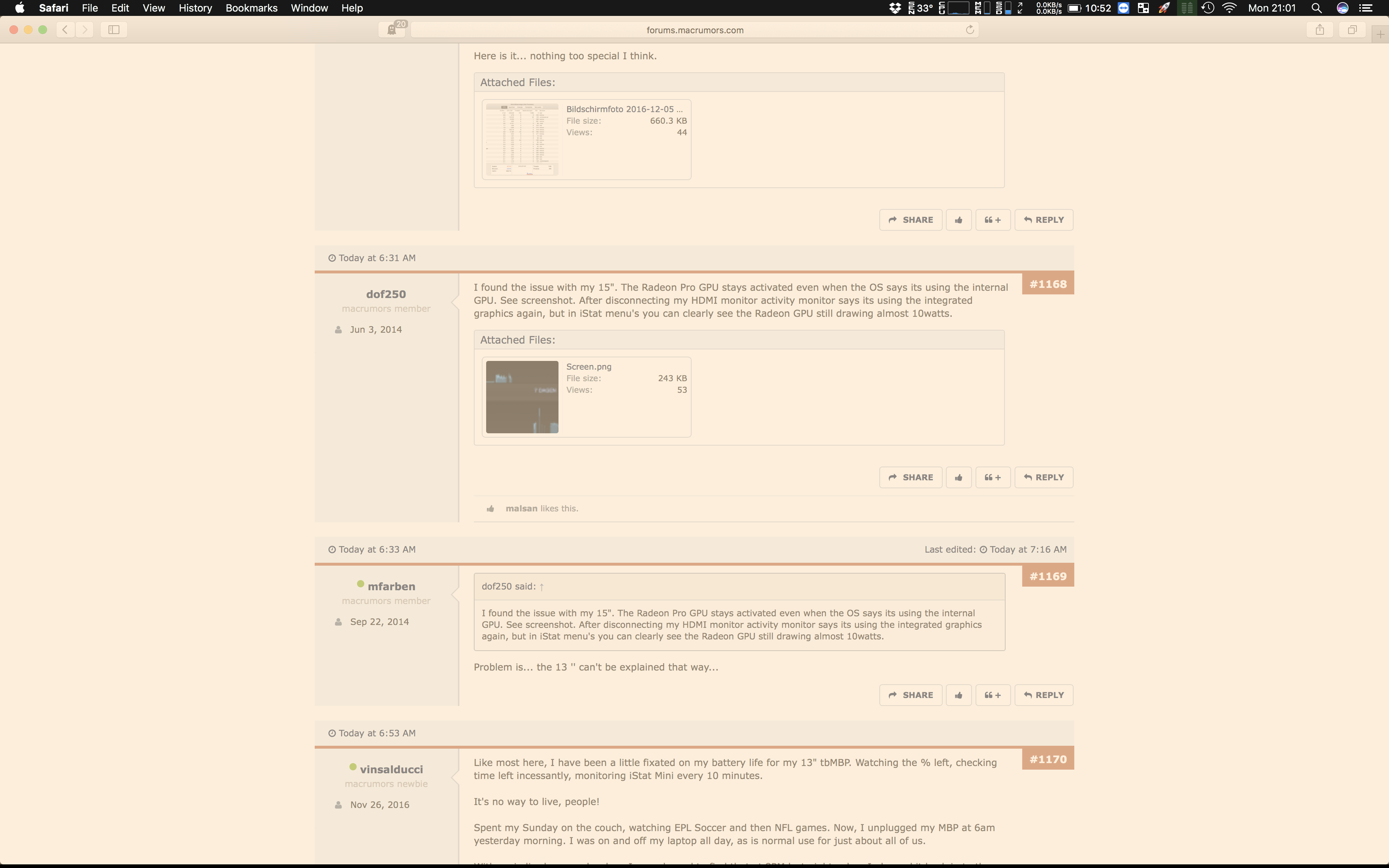

I am also seeing better battery estimates after about a week with the machine (15"/2.7/1TB/460). Coconut tells me between 4-10W average, and a big eye-opener for me was switching off of using Chrome and giving safari a shot. Chrome is a HUGE battery hog.
Also, saw a weird problem this morning when the system was reporting constant use of the 460 GFX card even with only one or two apps open (safari and maybe Spotify). Closed the lid, let it sleep for a minute, woke it up, still using the 460. Closed all the apps, waited, still using it. It wouldn't shut the 460 off and revert back to the integrated until I restarted and now it's back to integrated. On the plus side, I'm on track for easily 8 hours of use (down to 46% with an estimated 3:45 left) - light use, mostly safari with a few tabs, Spotify, Pages, activity monitor, brightness at ~75%.

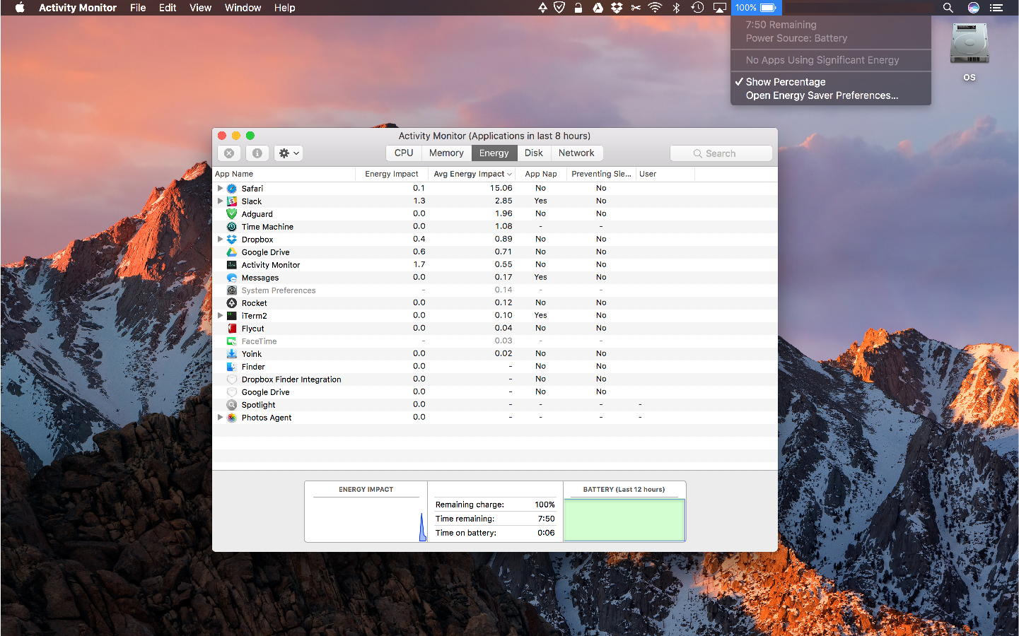

So after getting tired of hearing 'you must be using Chrome' or 'you must be exporting 4k videos' or 'you must be using an external display' I thought I share a screenshot of my battery life. This is my expected life at idle, after letting it sit long enough to calculate a reasonable estimate (which falls in line with what I've been seeing with actual usage). There's simply no way this computer can get 'up to' or 'close to' 10 hours of battery life. Also, my display is set at 75% and has been powered on all day. 13" MBP TB 16GB/512GB/Core i7
Reactions: Toadsfather

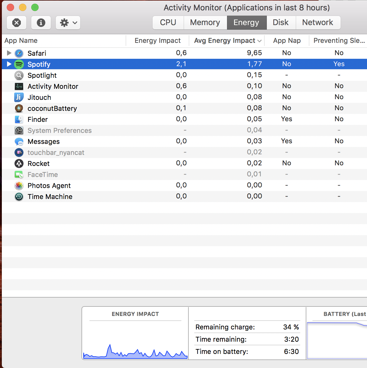

Can we rely on the Energy Impact Data? That would be good news for me if we can...
13" MBP TB 16GB/256GB
