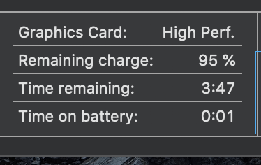

So on 95% I have around 4 hours is still okay?

I have the base mode i7 16" I can literally go 1.5 days without a charge pretty unreal, wondering if the i9 is similar? 16"?

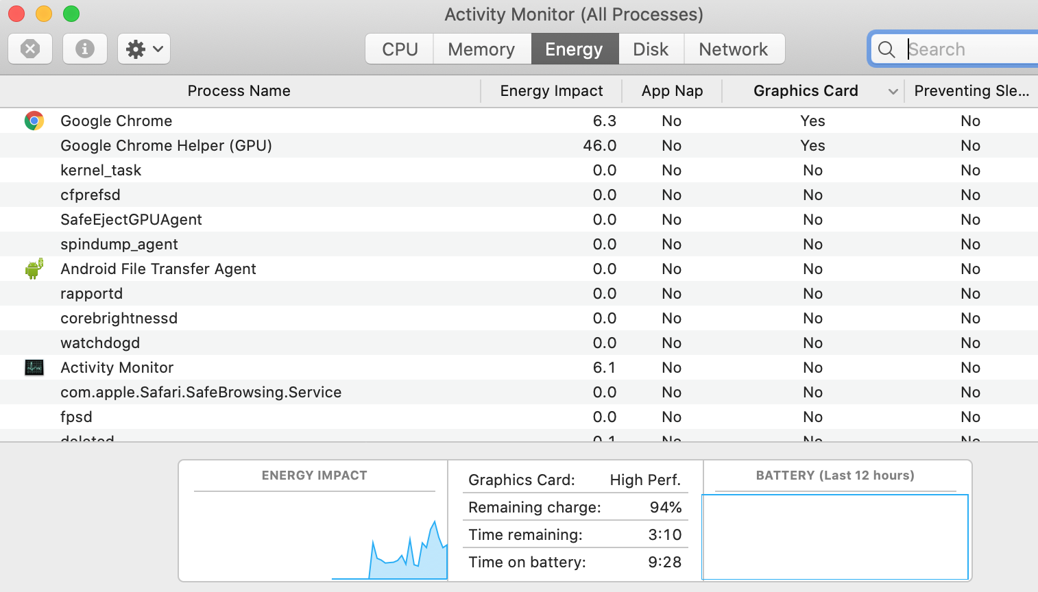

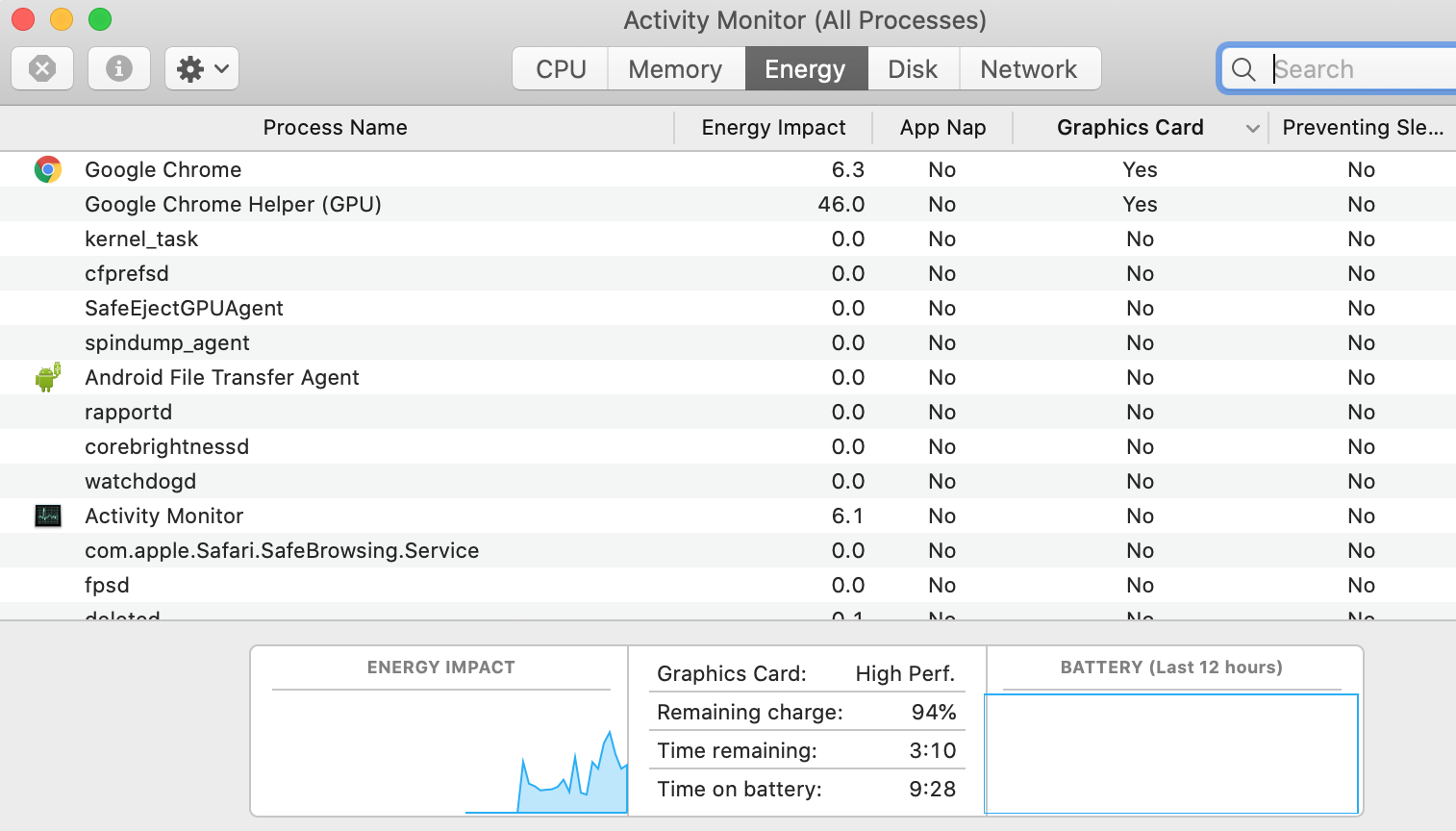

Sort your Activity Monitor by the Graphics Card column and just see if there's anything running there that is requiring your dGPU to be on. While that is active you won't get good battery life.
Just looking for anything that says "Yes"
For now all apps shows NO
