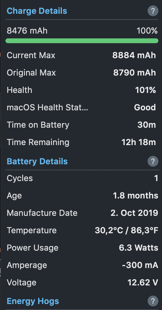

Brightness on 50%, battery fully charged, browsing this forum in Safari and having Mail open, power usage is shown at 3-8 Watt. Time remaining at approx. 13.5 hours according to Battery Health 3. (i9 2,3 GHz model here)

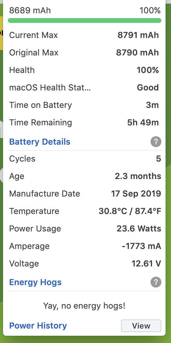

Safari open, 2 tabs, 70% brightness, Battery Health 3 says 14w draw. 4hrs remaining. 99% battery.

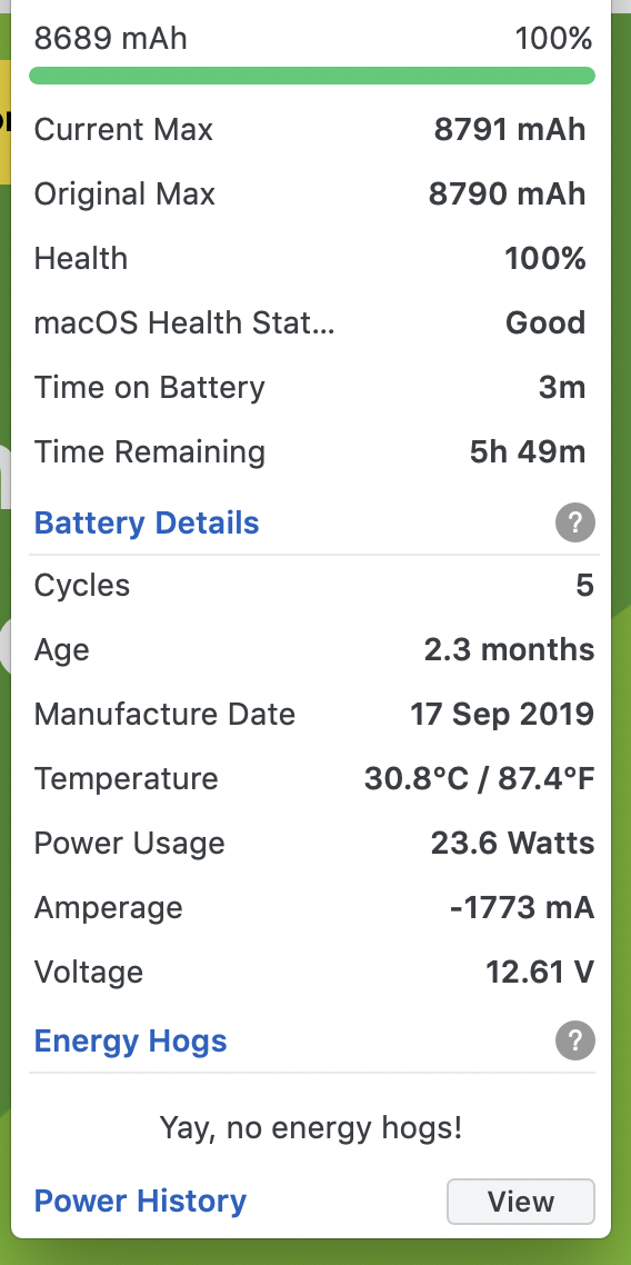

After a full charge, and just safari open with 2 tabs this is my current battery state.
Sounds like I should be taking it back if I'm not seeing 12 - 16 hours remaining ?

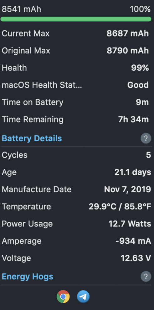

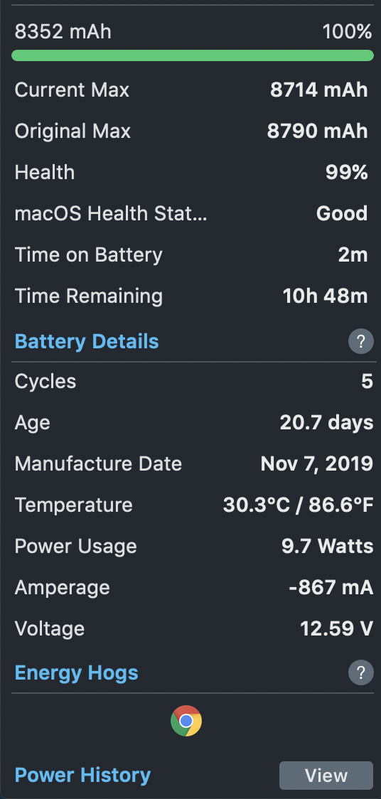

I have the 2.4/64/5500M 8GB/2TB. This is what I got with battery health, it has been all over the place with its Current Max but it has always been below its designed 8790
I took this with like 8 chrome tabs open (a combination of youtube, this forum, and various newsites), telegram up in another desktop as well as terminal in that same desktop. I would continue to monitor your computer and I will do the same. I will let you know if anything changes on my end

I have the 2.4/64/5500M 8GB/2TB. This is what I got with battery health, it has been all over the place with its Current Max but it has always been below its designed 8790View attachment 879628
Woah. You battery age is so recent. Mine is 14th October manufacture date. Same experience with the "Current Max" its gone from 8660 to 8799 and down again. Always changing.

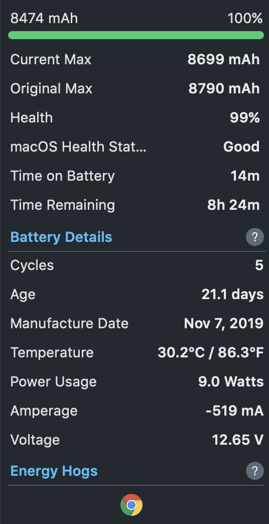

Brightness was at like 35% as it was done at night when I got those results. Here is it with brightness above 50% (60). The same environment as the first one: Chrome was open with multiple tabs including youtube (video playing), this forum, some new-sites, etc.), another desktop with telegram and terminal open.

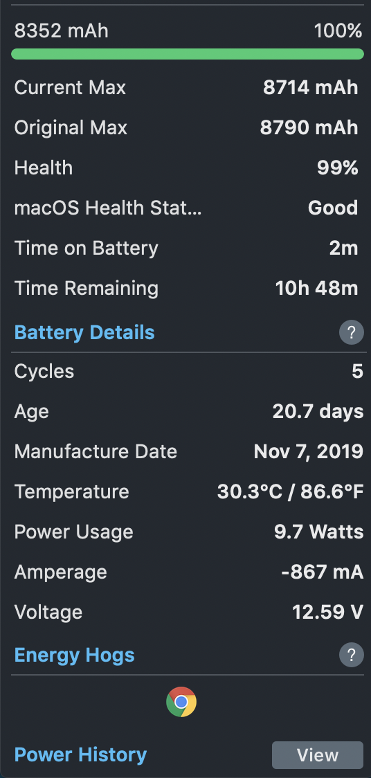

I also just tested the same environment but upped the brightness to 75% and played apple TV and got this
