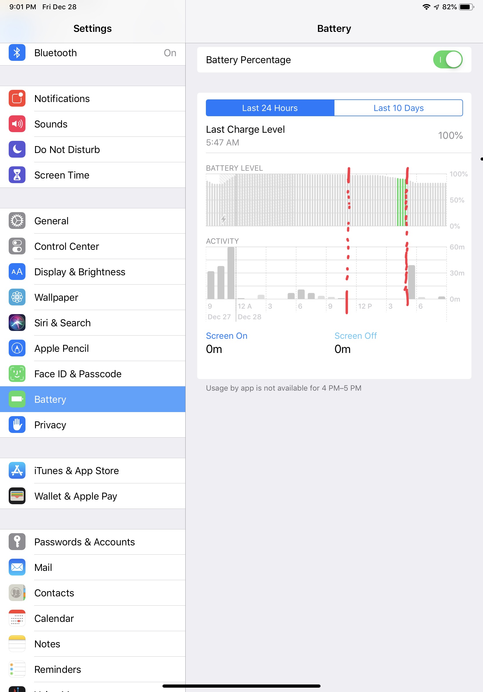

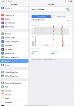

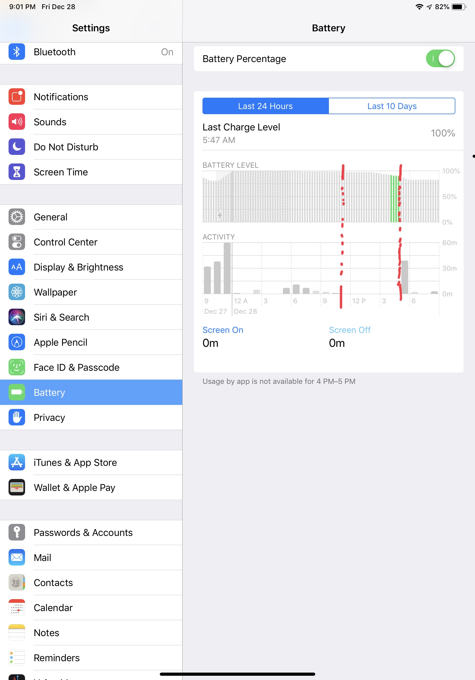

So after reviewing the battery applet, it’s pretty evident that I had 0 usage for a 3 hour period this afternoon and saw about a 10% drop during that period. I’ve added a screen shot. I was not connected to WiFi during this time (as always with my 10.5 iPad) and did not use it during this period. I pulled it out today around 5pm and used it for 40 minutes with normal drain watching TV.
It was steady at nearly 100% until around 2pm today.

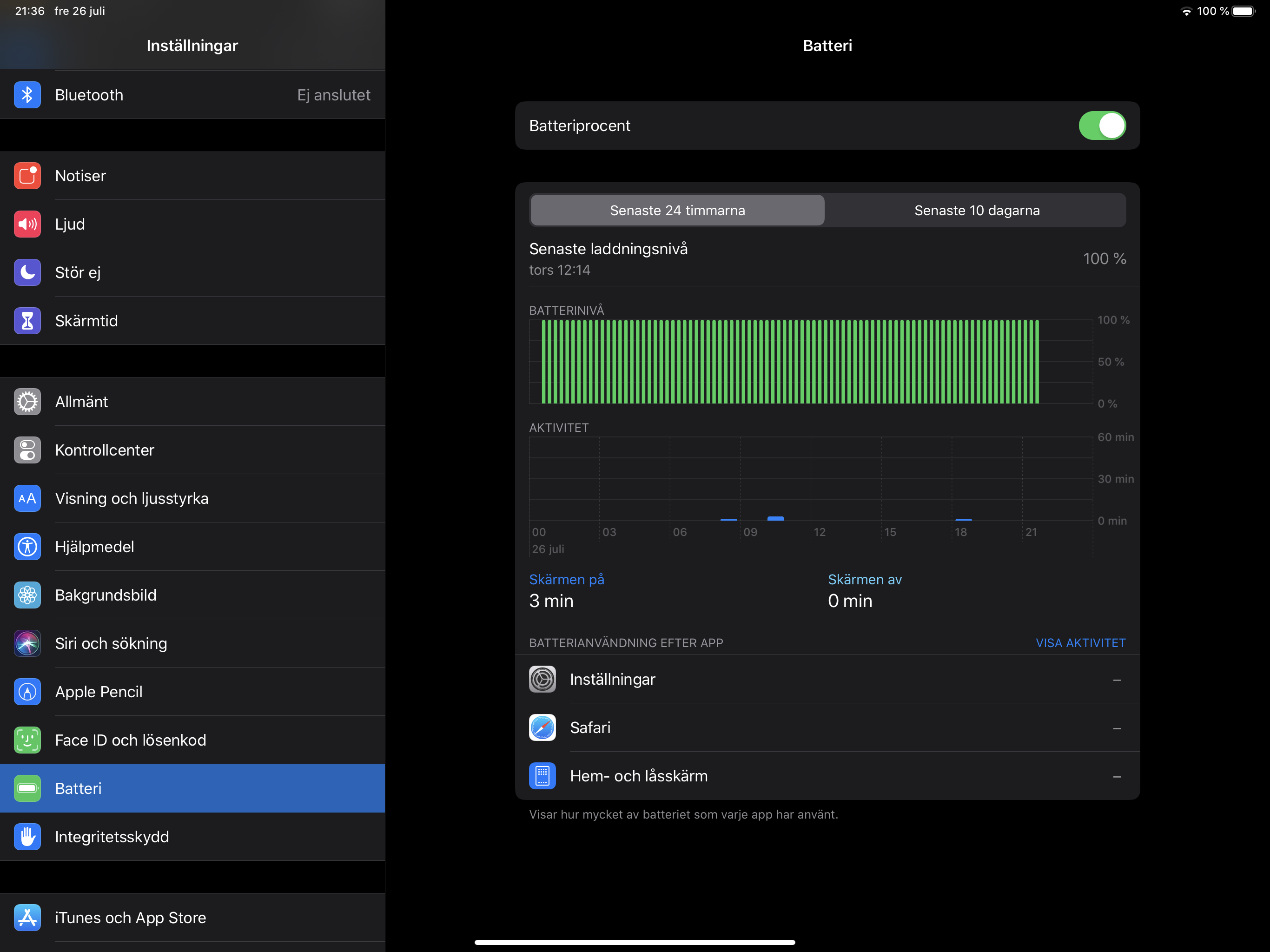

With beta 3 of iPadOS Has consumed 0 % in almost 34 hours. So they must have fixed something. Even with wifi on. This is how it should have been. My picture is in swedish but Torsdag means thursday.
Which iPad is this...?
