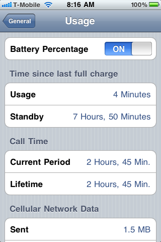

Yesterday I charged my iphone fully and turned off Activitor also turned off pushing and my data also wifi. The only thing that was on is SBsetting and my phone. Left it for 4 hours and I had 0 minutes of use time and 100% battery left.
So then I decide to turn on wifi and see what happens. After 7 hours I had about 4 minutes (i played with the phone a bit) of use time but still 100% battery.
Today ill try to have data/wifi/phone sbsetting on during the night and see if there is any change. If not ill include pushing too.
EDIT: Oh yeah forgot to add I also have ultrasnow installed.

I drained the battery last night and started my testing at 4am. By 1pm I was down to 7% and here are the stats:
Usage 6h 2m
Standby 9h 12m
Pretty much occasional web browsing and push email with a few Facebook updates and about 20 minutes of phone calls. The first hour was over wifi and used about 14% battery and the rest was on 3G.
That's about an hour of usage short of what happened pre-jailbreak.
