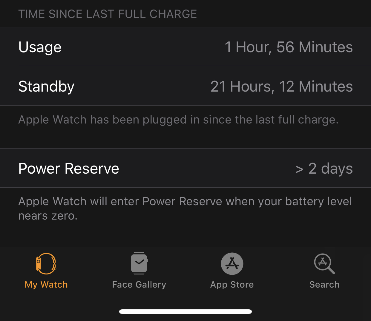

Check the usage and standby numbers. If your usage numbers are high then you have a process that isn’t properly shutting down. Usage for me after a battery drain to 20% should be about 4 hours - 4.5 hours. If you see your usage number is substantially higher then it could be that problem.
Start by doing a hard shutdown. If that doesn’t fix it, do a re-pair. If that still doesn’t work try uninstalling all apps and a new pairing. If that works you can then start installing apps individually, making sure each app is not the culprit.
Btw, after recharging to 100% you can very quickly see if the problem is persisting. Once you take it off the charger if you notice 15 mins, 20 mins, 30 mins standby and almost the same in usage, then you know the problem still exists and you would continue to the next step in your troubleshooting.

I’ll try some things. Right now it’s at 47%. It was at 60 when I came back from a walk with music connected to AirPods and no phone with me and took it off right after.

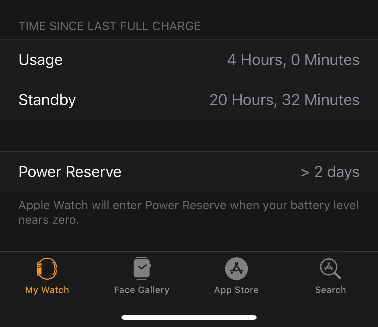

Same thing. Drained overnight to 18%. Don’t know why
[doublepost=1541681812][/doublepost]This is what I got right when I plugged it in

It sounds like you have a runaway app.
I generally consume 5%-10% battery while wearing my watch overnight. That's a 44mm. The 40mm can consume a little more (due to smaller battery I think), but usually less than 12%.
I use the dock to force quit any running apps, and I put my watch into "theater mode" and "do not disturb."
Any apps you have on your watch face as complications will run and use "background app refresh" even if it's turned off.
You might want to start by looking at any third party apps, especially if you have them as a complication. Maybe it would help to set up a simplified watch face, that you swipe to at night, with minimal complications.

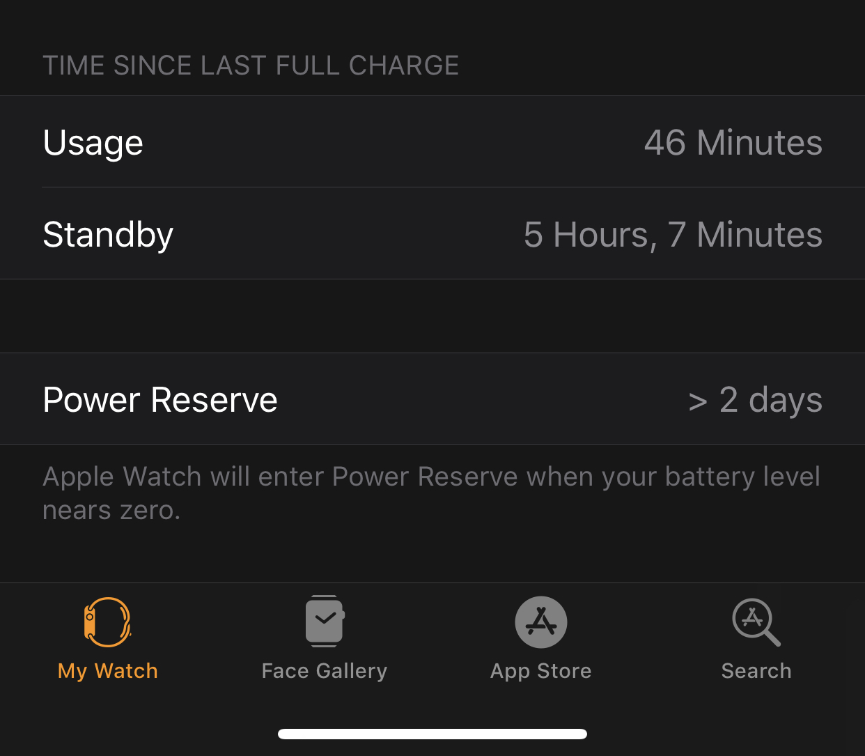

Just an update. So her 40mm series 4 is at 61% now at 2:59pm. No walk or swim today. She also disabled a bunch of notifications and background app refreshes as well. I’ll let you know tomorrow what she comes back with.
This is what I got today using the face I used to use on s3 lte. Still seems way off compared to my s3 lte 42
It’s at 15% now
So I brought it in to the Genius Bar. Their diagnostics say it’s fine. But they say it should be lasting longer than how I’m using it. They don’t have replacements there nor do they replace batteries there. So they sent it off to either replace the battery or replace the whole thing is what they told me.
