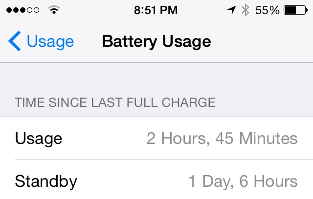

Is the usage and standby time exactly the same? If so then it probably is a rogue app, however other options that might cause it are e-mail or network settings. To solve that you can do these three things:
- do a hard reset
- a network settings reset
- deleting and reinstalling your email accounts
See also this topic.
image-jpeg.596748
It should look like this if no rogue app is causing battery drain:
