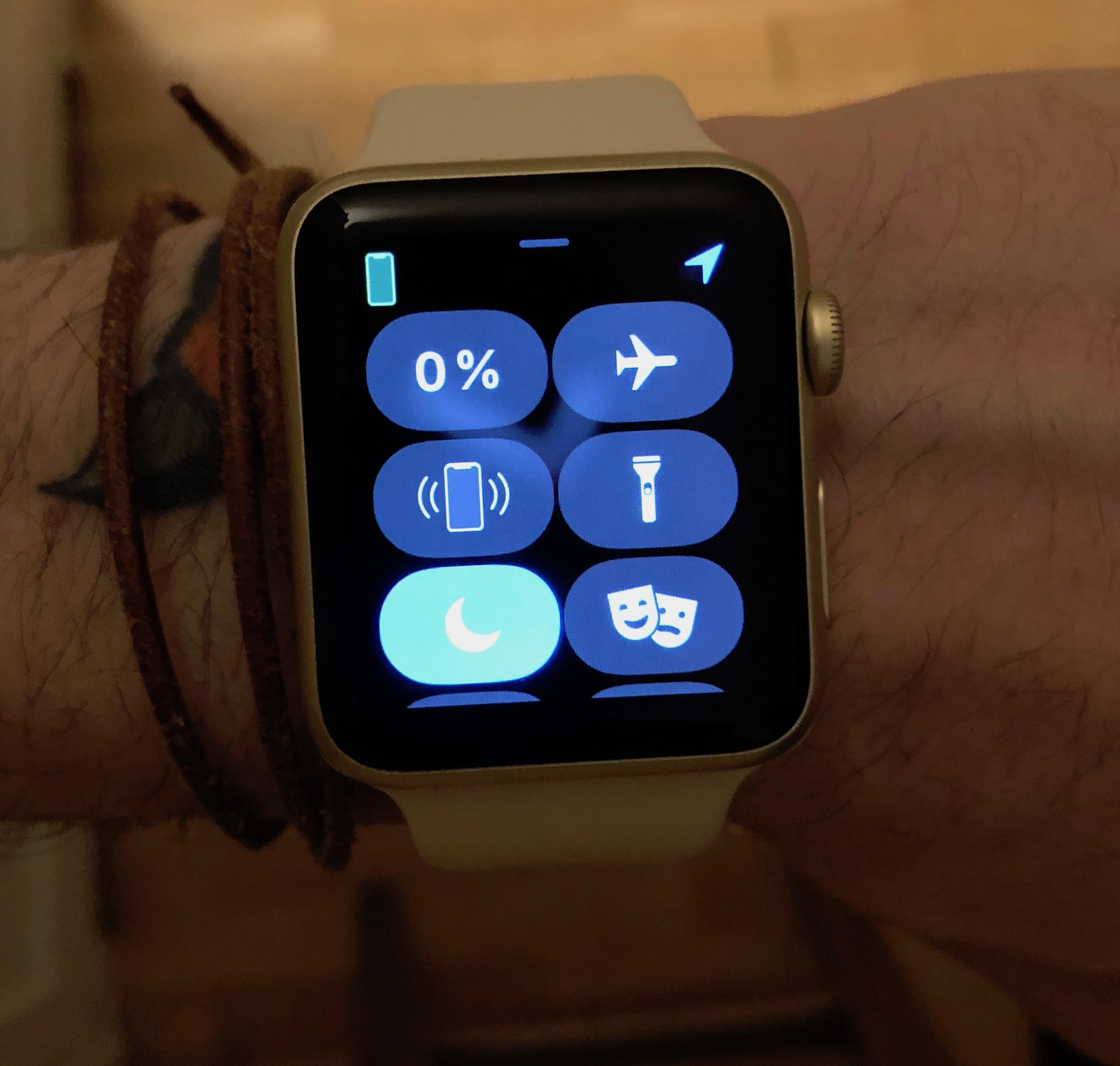

Ok guys , morning update for you & don’t seem good in terms of battery loss.
Drained watch yesterday & recharged. After reaching charge at 22:15 went to bed at 22:30 with full 100%. This is about usual time for me.
Nothing different. Theatre Mode activated whilst wearing through night.
Alarm off at 06:25. Check battery & reading 79%.
So lost 21% in 8hrs. No activity , no notifications lighting up screen etc , yet lost 21%.
Now with exact same behaviour pre 4.2.2 I’d be on early 90’s in the morning.
So as I said yesterday , certainly a hit for me so far on this update. 10-12% going somewhere.

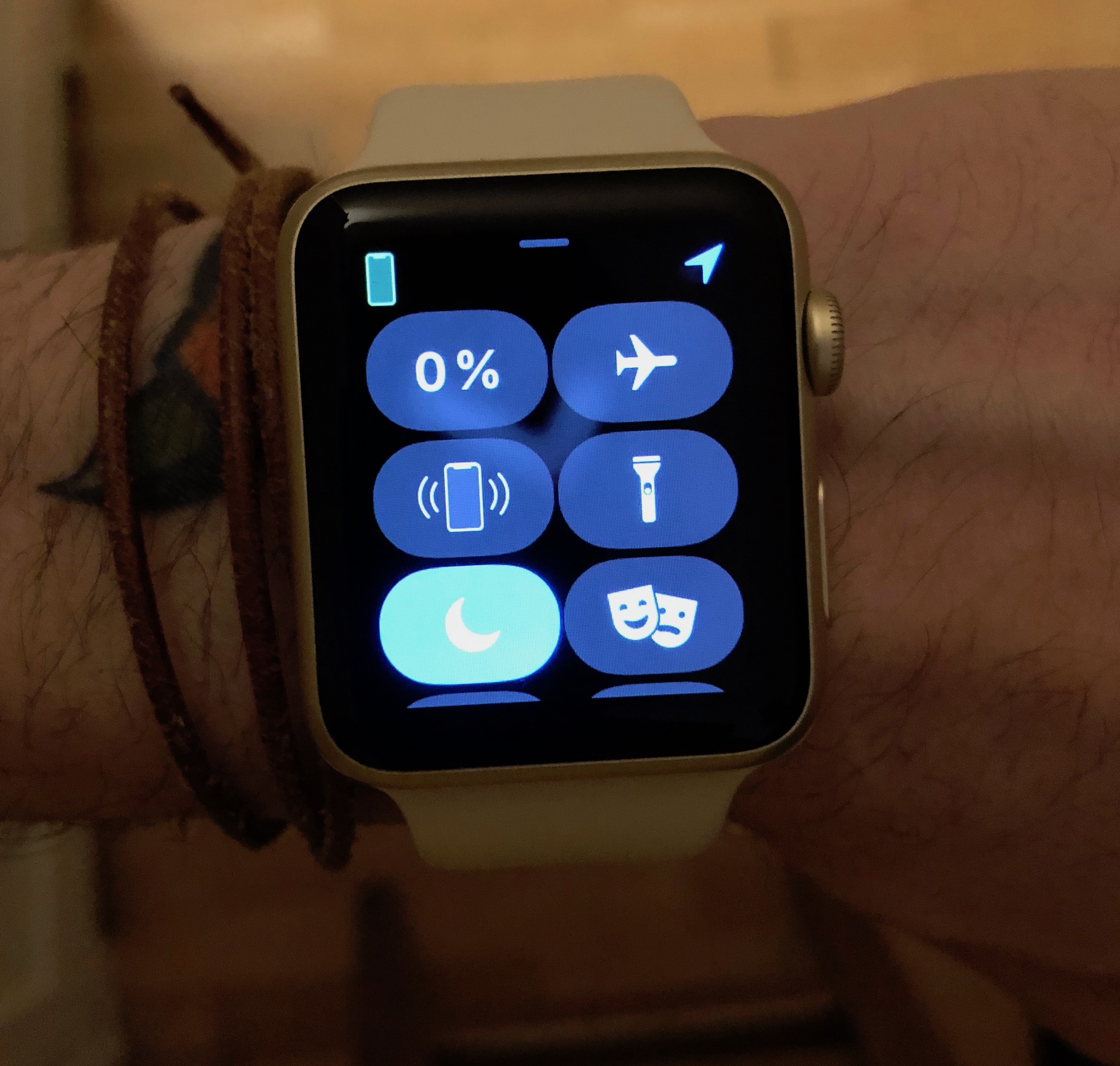

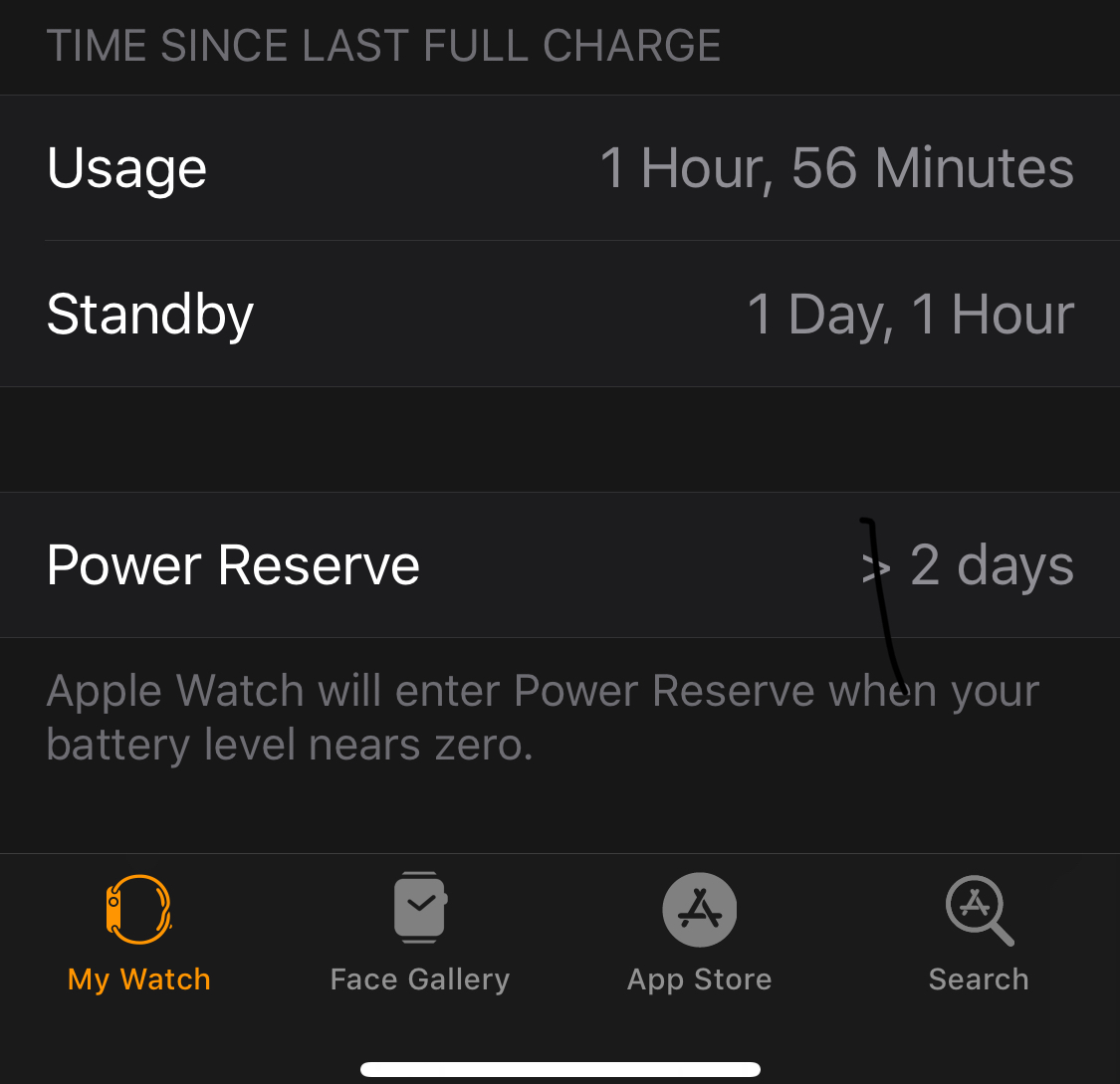

I don't think it's the update that's causing this.. I think this happens sometimes after doing an update. Probably a process that's not terminating properly. One way to tell is by checking your usage and standby times. If the watch is performing correctly your standby time should be much higher. If not you'll see a usage time that is uncharacteristically high. For example:
Usage: 3 hours
Standby: 4 hours
The screenshot below is mine. Notice the very low usage time.

Just checked
Usage - 15 mins
Standby - 1 Hour 42 mins

That looks pretty good. Your battery should have a better cycle this time.

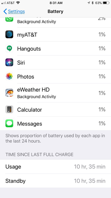

@Mikeeee I had the usage time and standby time being the same happen on my 7+ after the one of the recent updates, it went away after the next charge.
Thanks for clarifying why this happens.

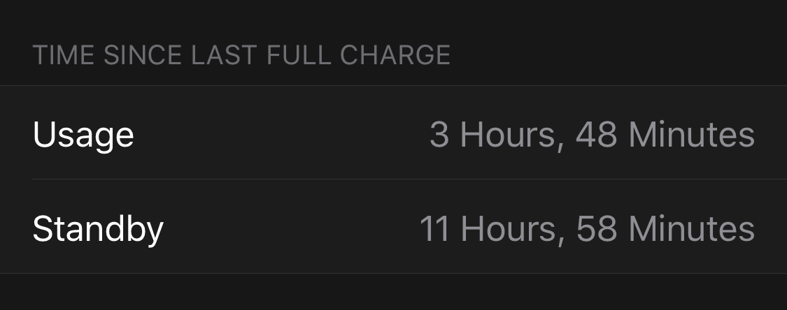

My Series 1 is basically dead since a week or so.
I can barely make it through the day on a full charge.
Usage time is insanely high - 3 hrs, 48 mins, when all I do is checking a couple of notifications.
And I'm at 0% after 11 hrs, 58 mins standby time... seriously?
I've already tried rebooting, uninstalling all apps, un-pairing and re-pairing - nothing seems to help.
Strangely enough, I had the same problem a year ago, never figured out what the problem was. One day I woke up and boom... I had amazing battery life. Not sure if that's gonna happen again this time. It just sucks so bad wearing this thing at the moment.

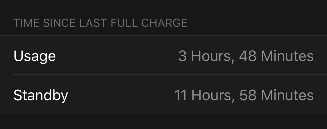

Did you install a new app before the problem started? If so, uninstall the app reboot or possibly even re-pair after uninstalling the new app.
Seat of the pants observation is that battery life has significantly improved with this update. Very pleased! Thanks Apple for continuing to improve this great watch.
Haven’t changed anything on the watch for 4 months or so. Battery basically got bad over night.
And I’ve tried all that already. I’ll call Apple next week if it won’t get better over the weekend.
