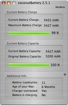

i just calibrated. gained a whopping 7 mah. 🙄
i have been wrestling with the battery update and get the same as icecavern and smartalic34.
i've reinstalled, deleted, redownloaded, reinstalled, checked permissions, recalibrated, etc etc several times and still i only get a folder. no file, no lego blocks, no change in battery.
