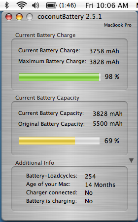

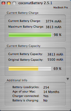

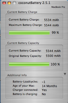

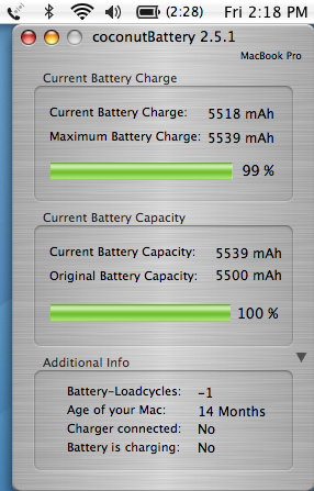

Just recieved a new battery from Apple. Still only charges to 99%. Not much difference as far as time goes.
I took these screen shots for a comparison:
Right after I took the last one, and as I am typing this, the time dropped down to 1:57.
