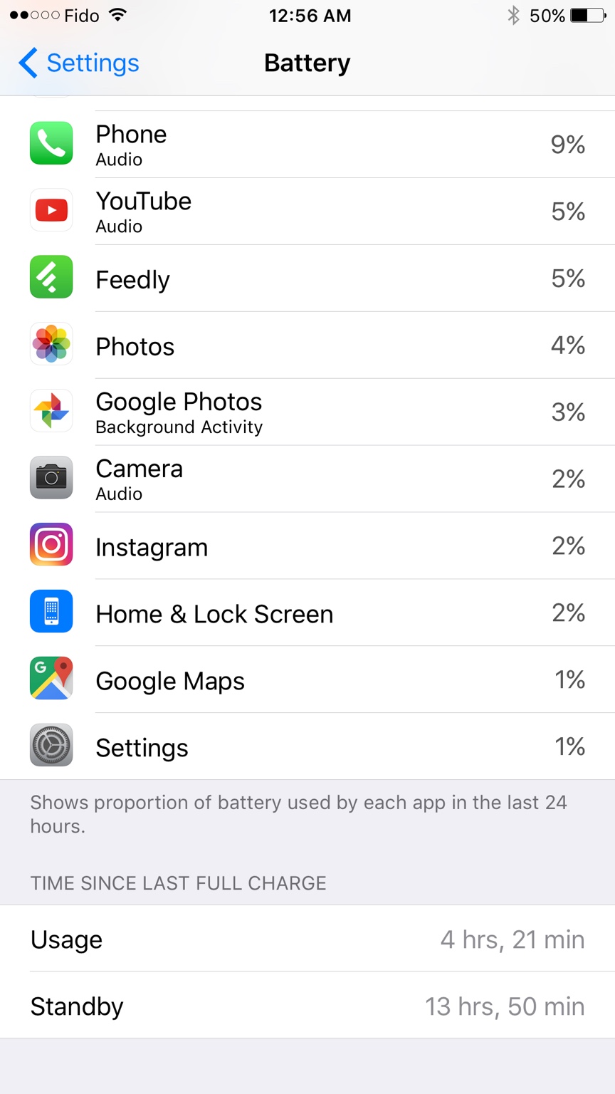

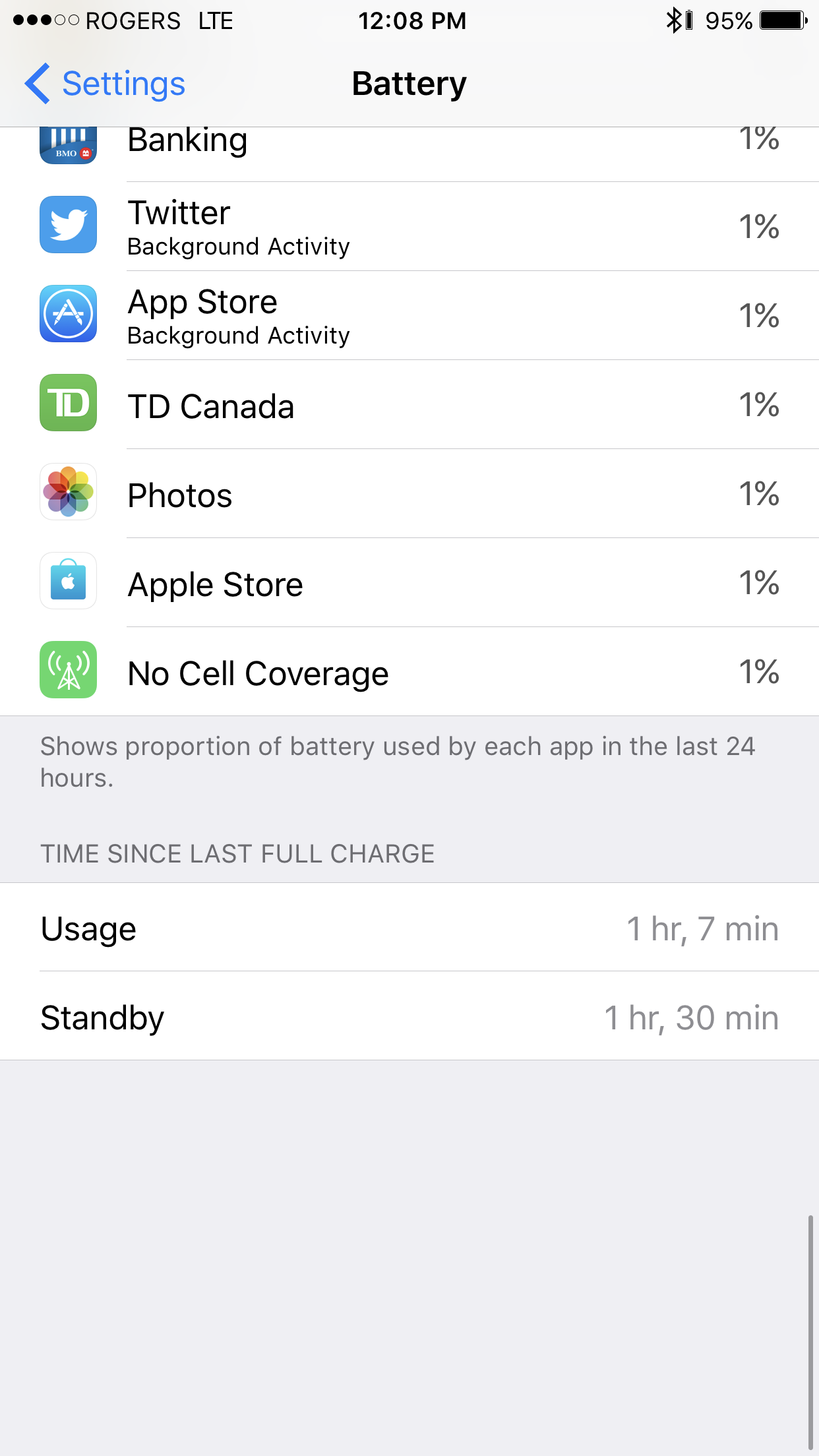

So I had mine charged up to 100. Took it off, been using it for an hour and a bit off the charger for an hour and a half now. Fairly intense use, bluetooth headphones connected, calls etc.
That's the kind of battery life I was expecting. I think I should go and get my phone exchanged then as right now the battery life is pretty poor and the standby drain is way worse than my S7E which is notorious for poor standby drain.

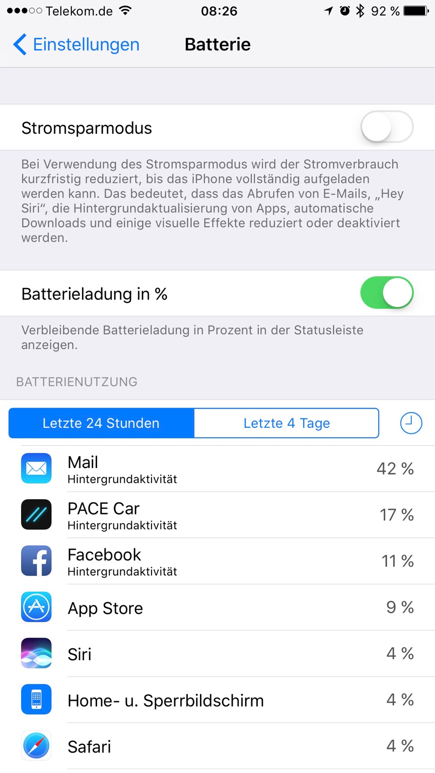

iPhone 7plus poor battery life , mail is at 42% i don't know why ,before I have a 6plus there was between 8 and 10% and I have no more emails as before, the settings are same
