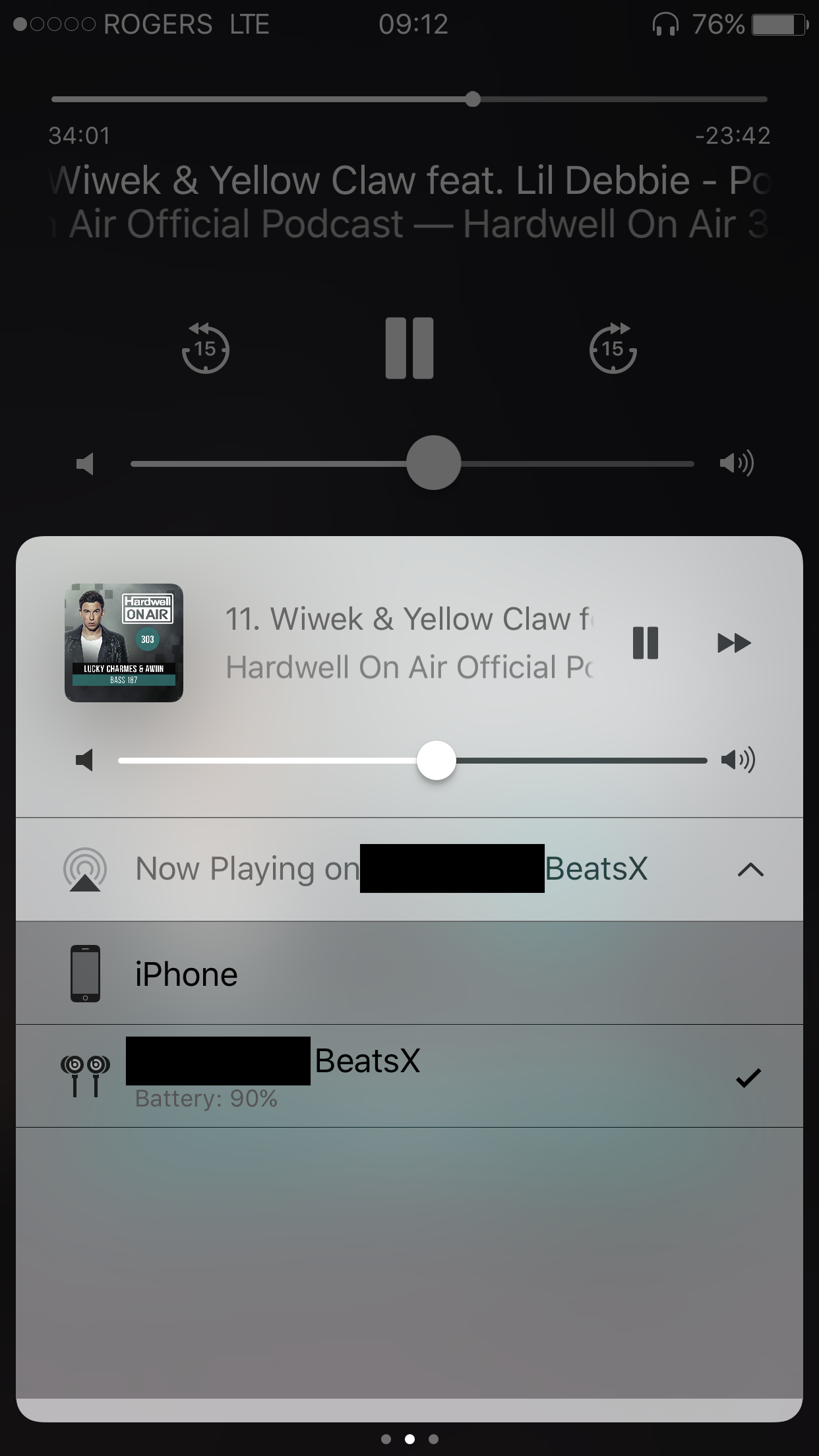

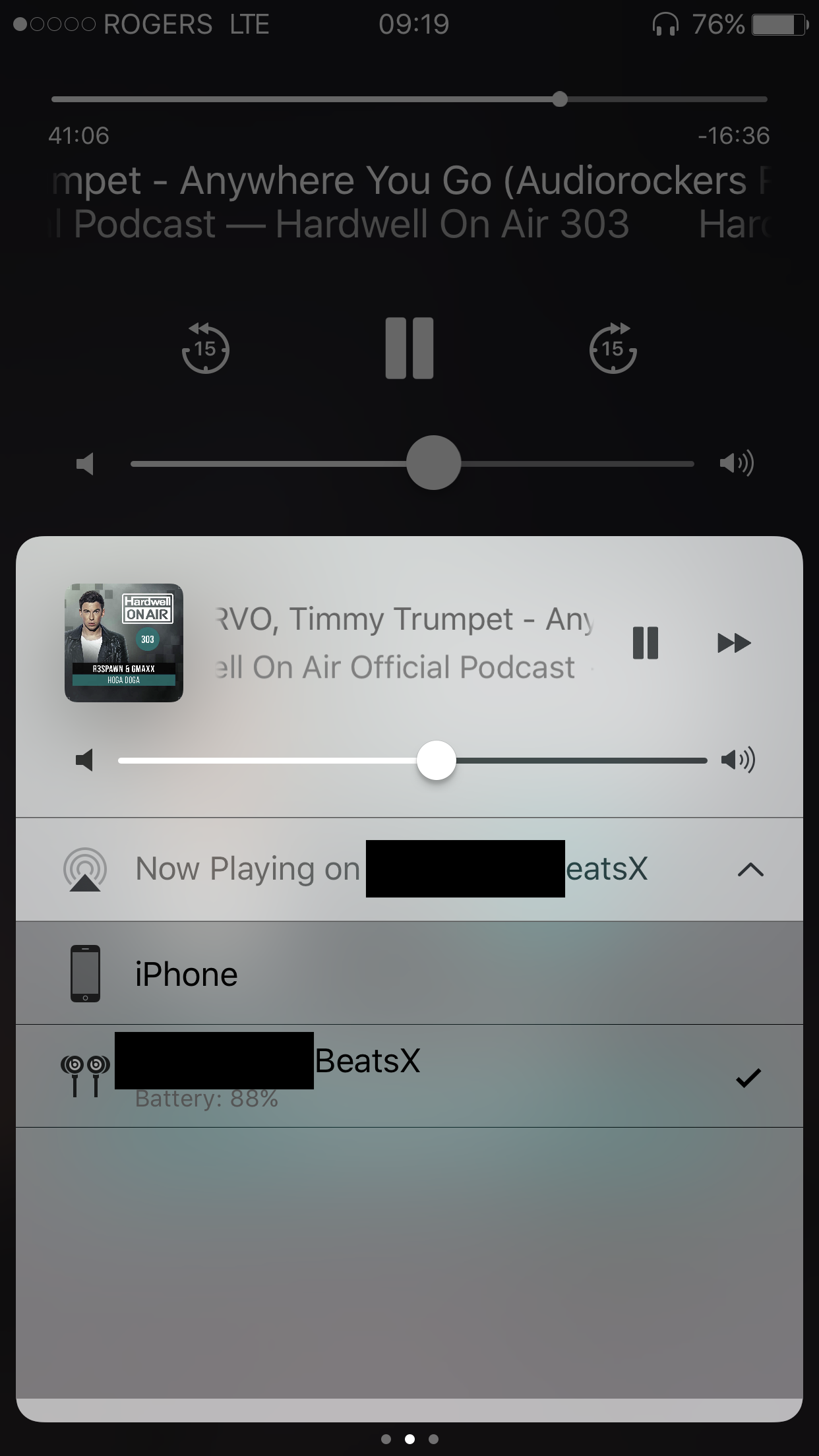

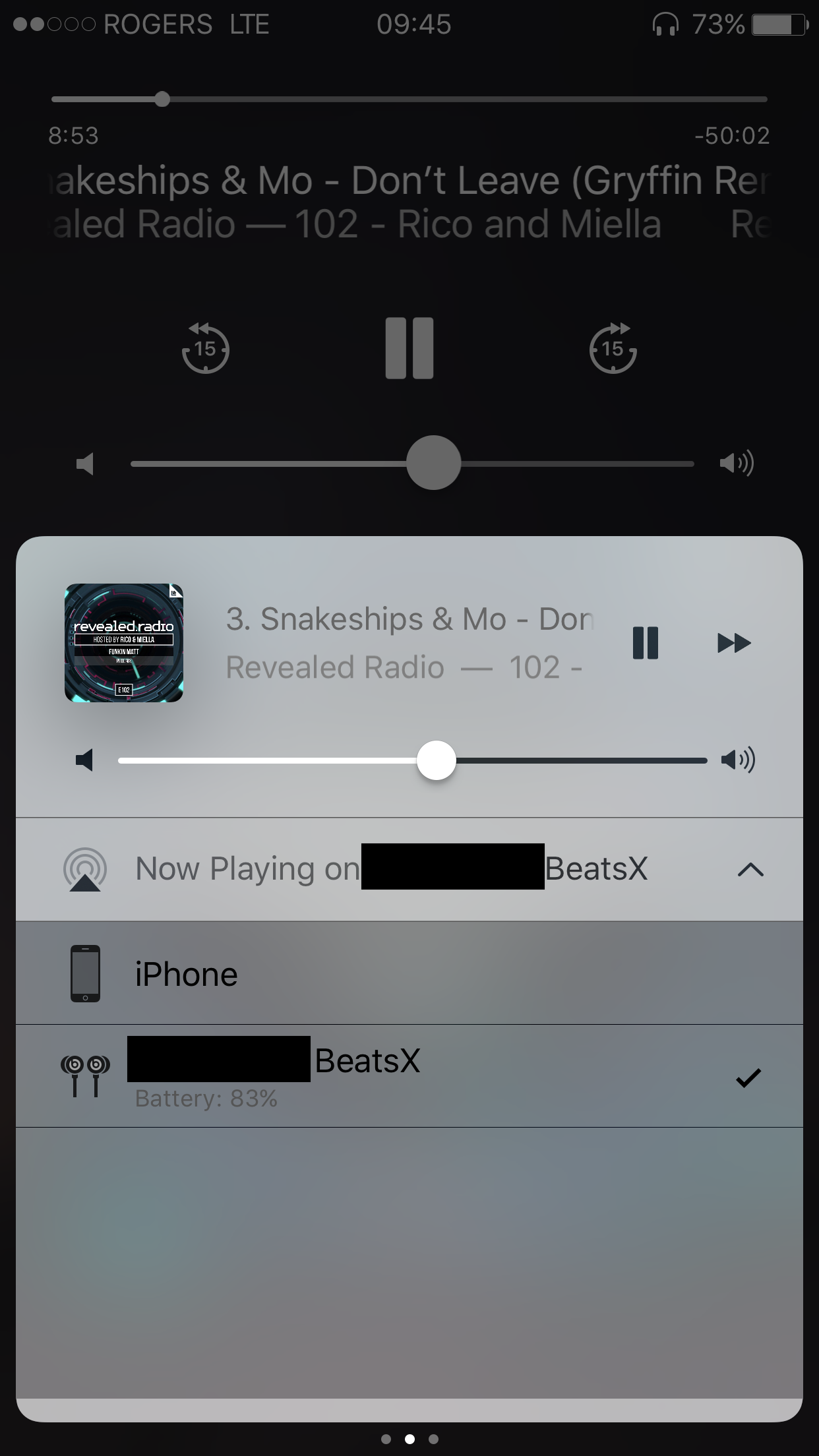

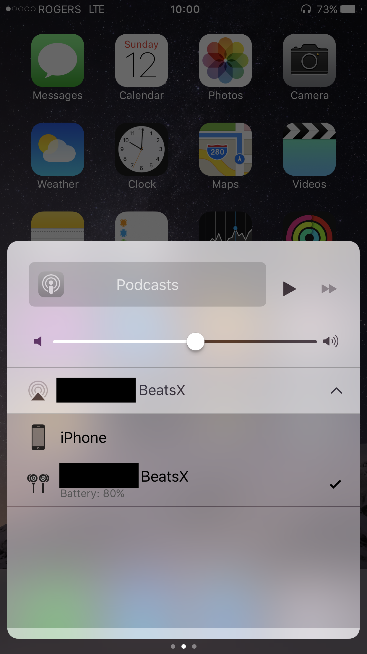

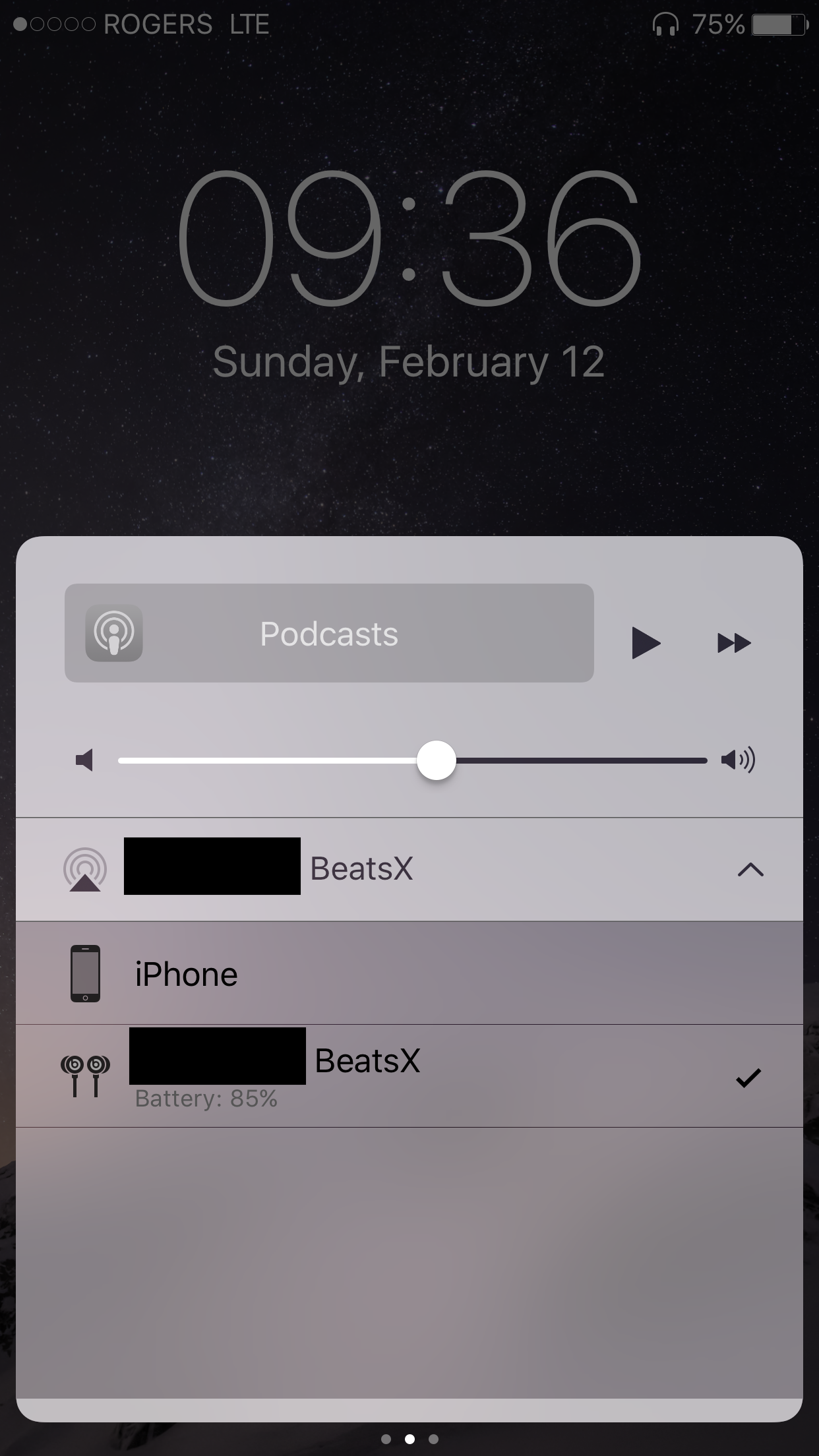

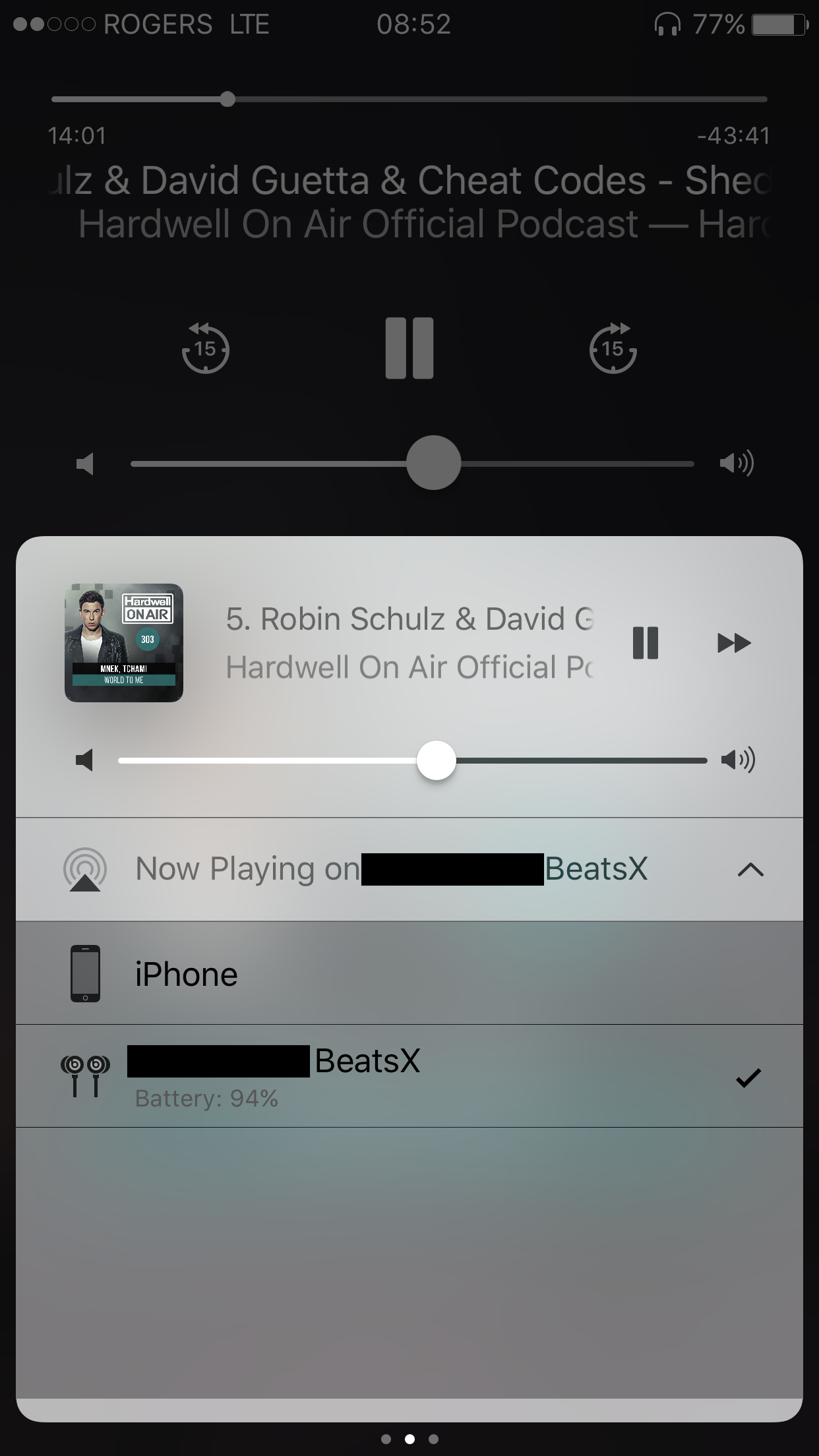

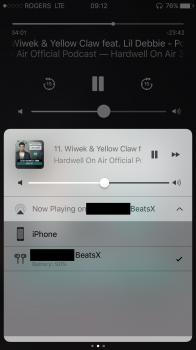

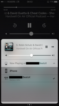

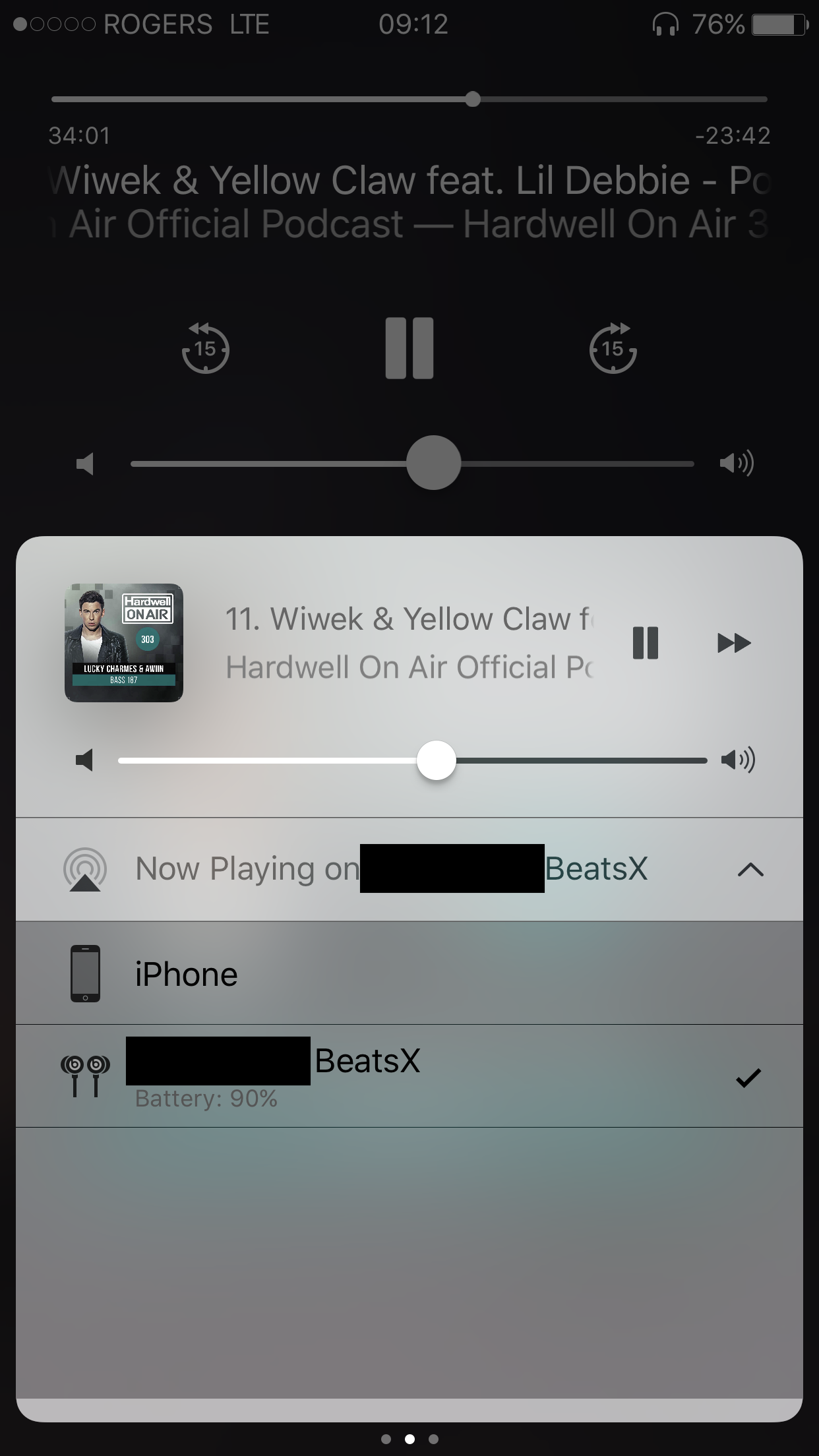

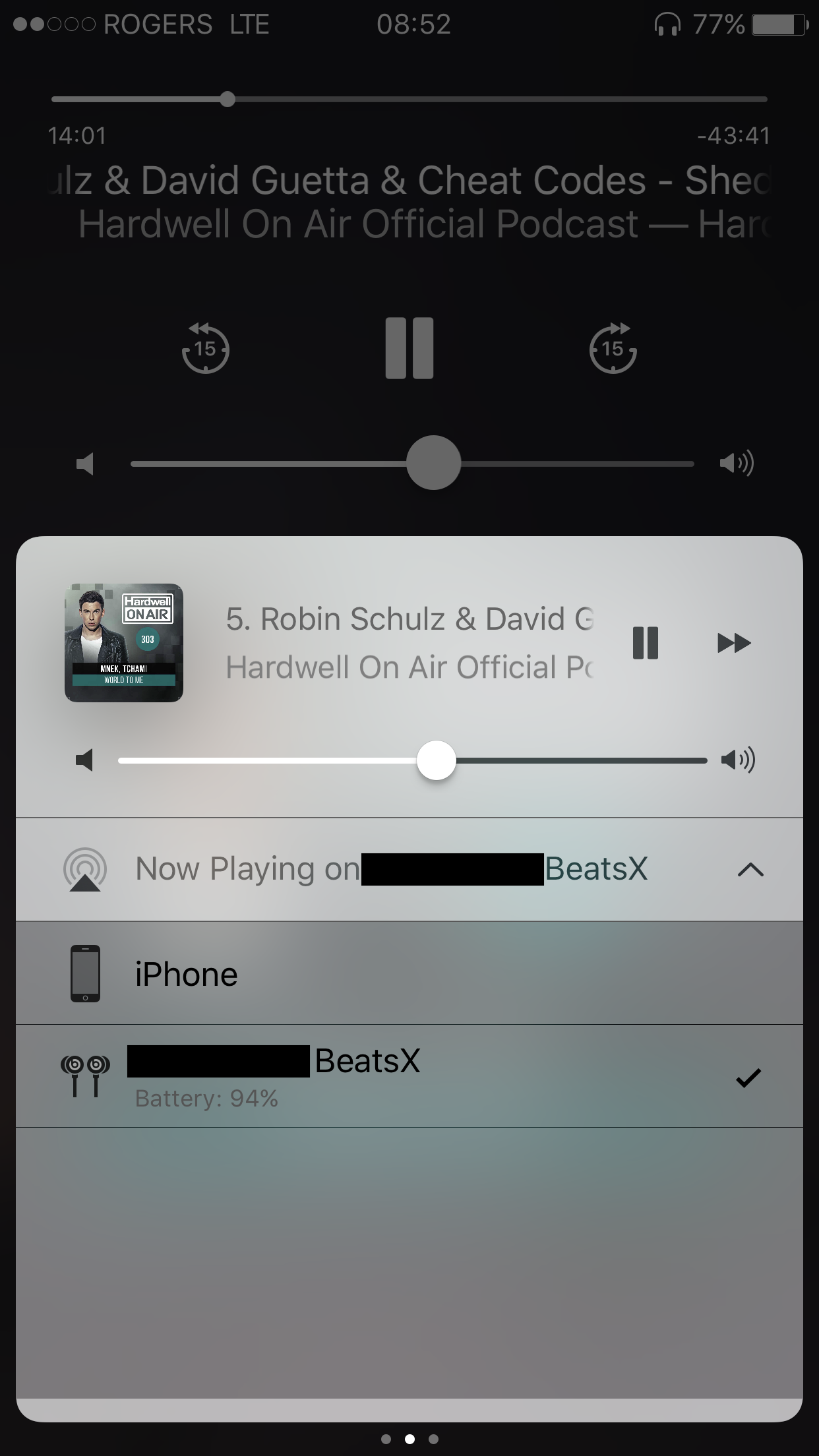

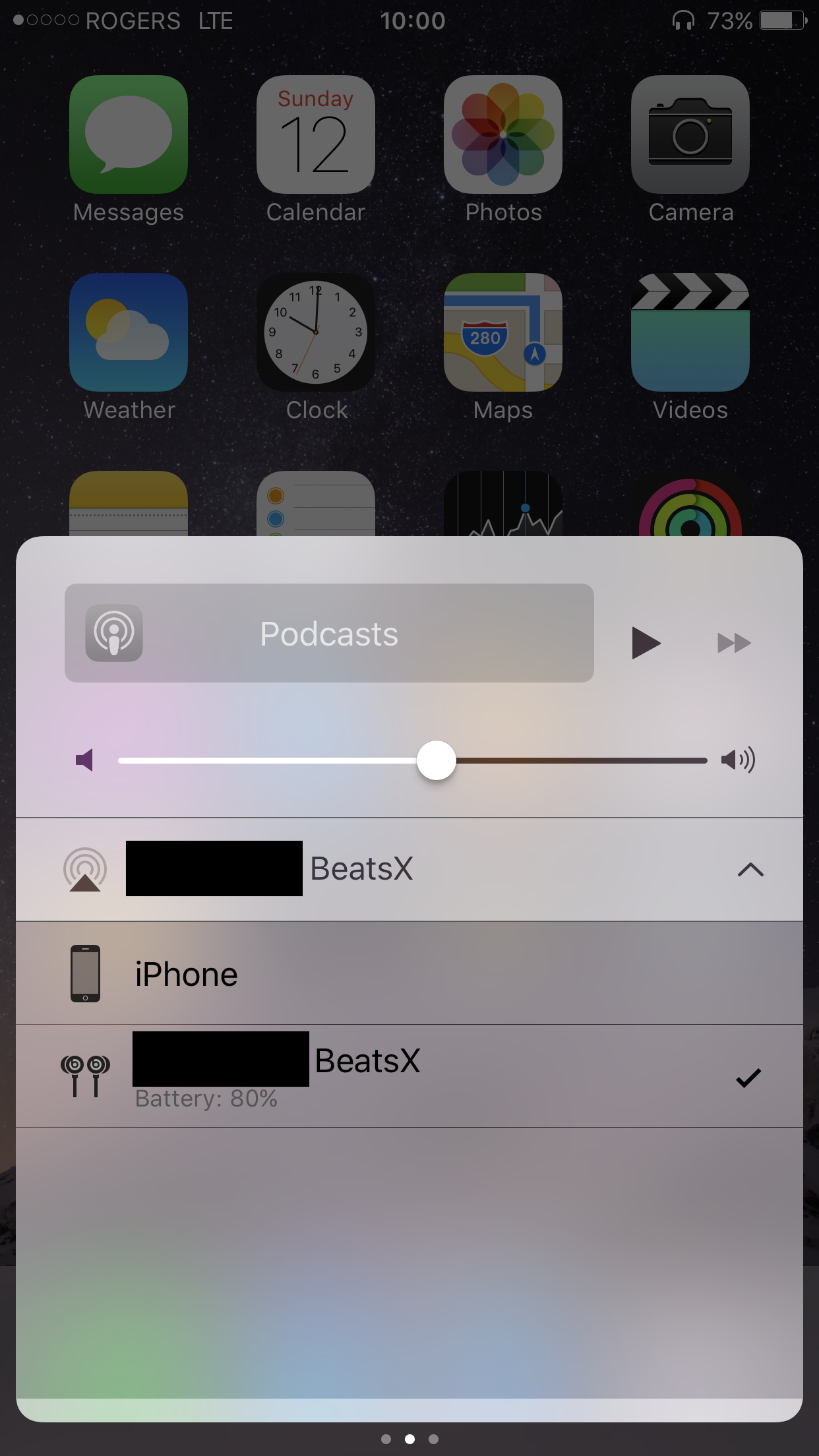

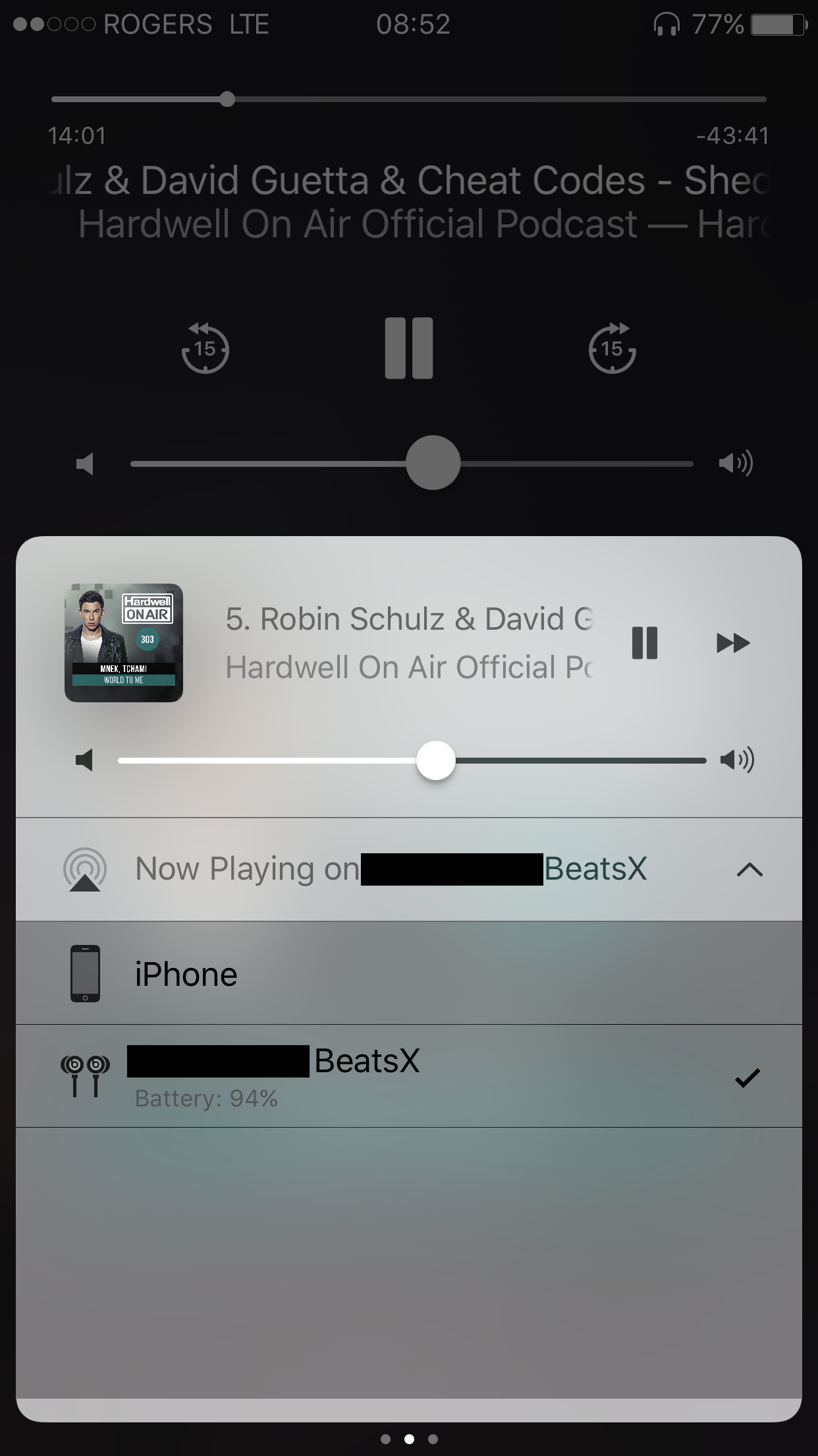

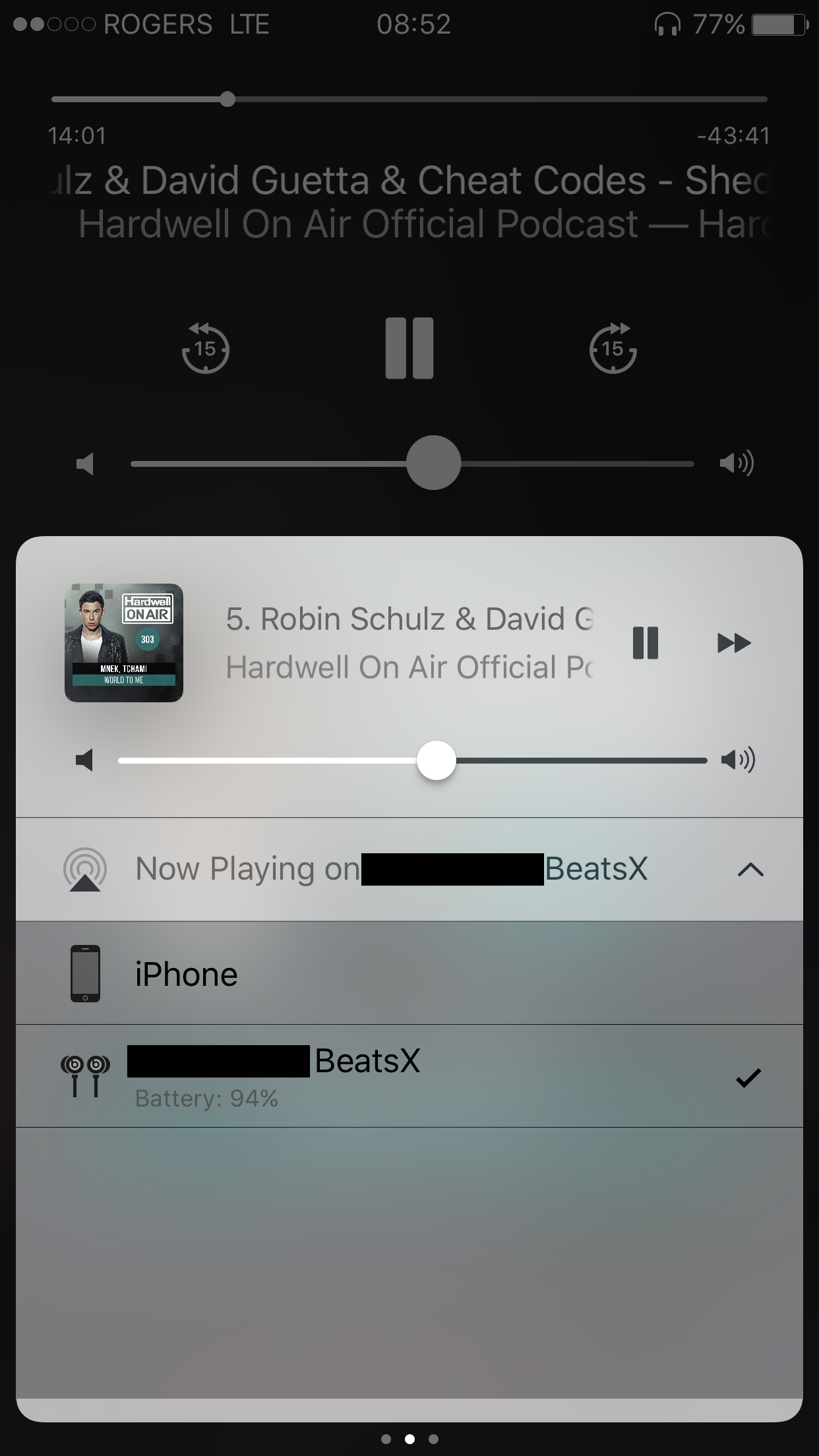

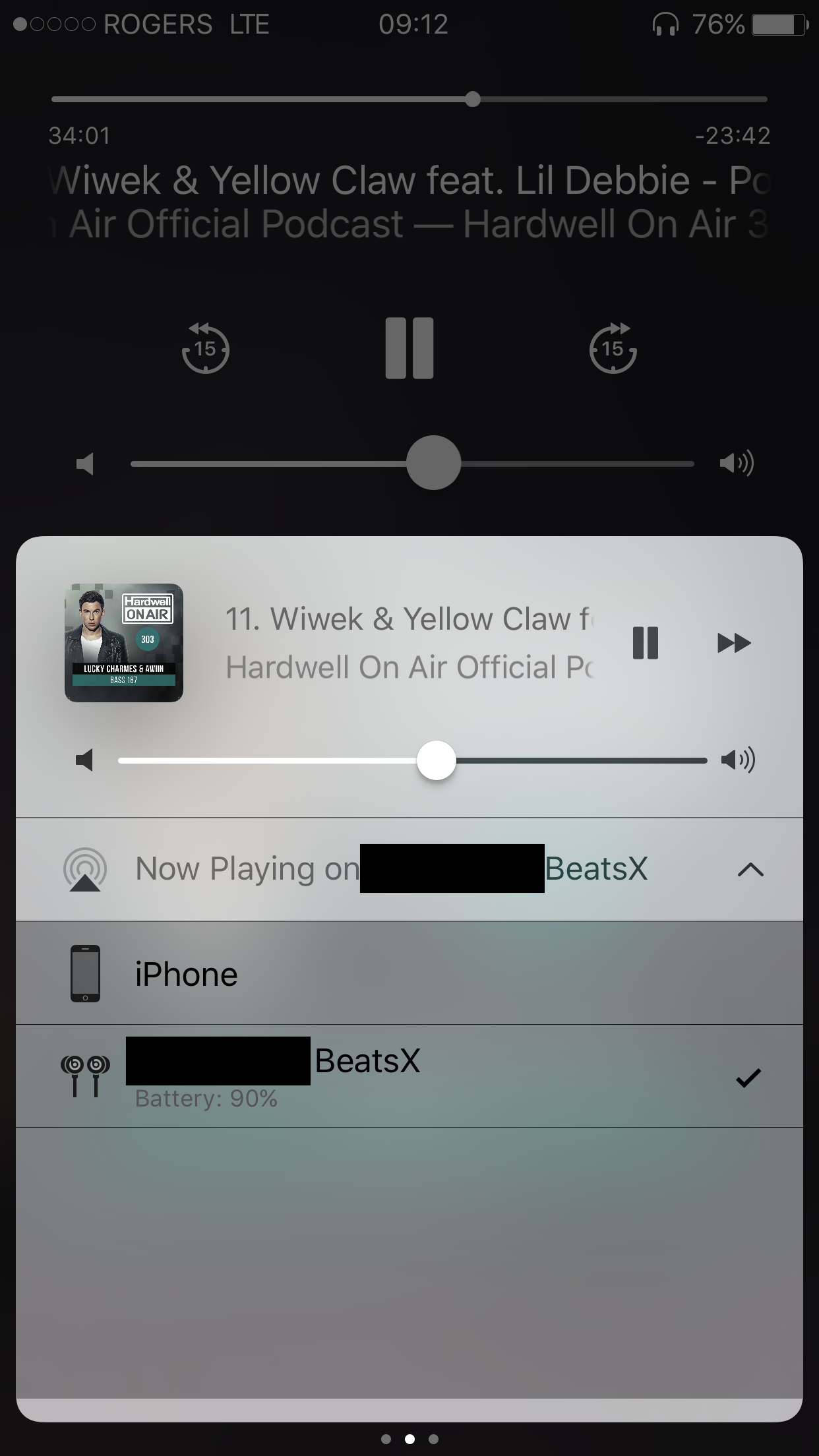

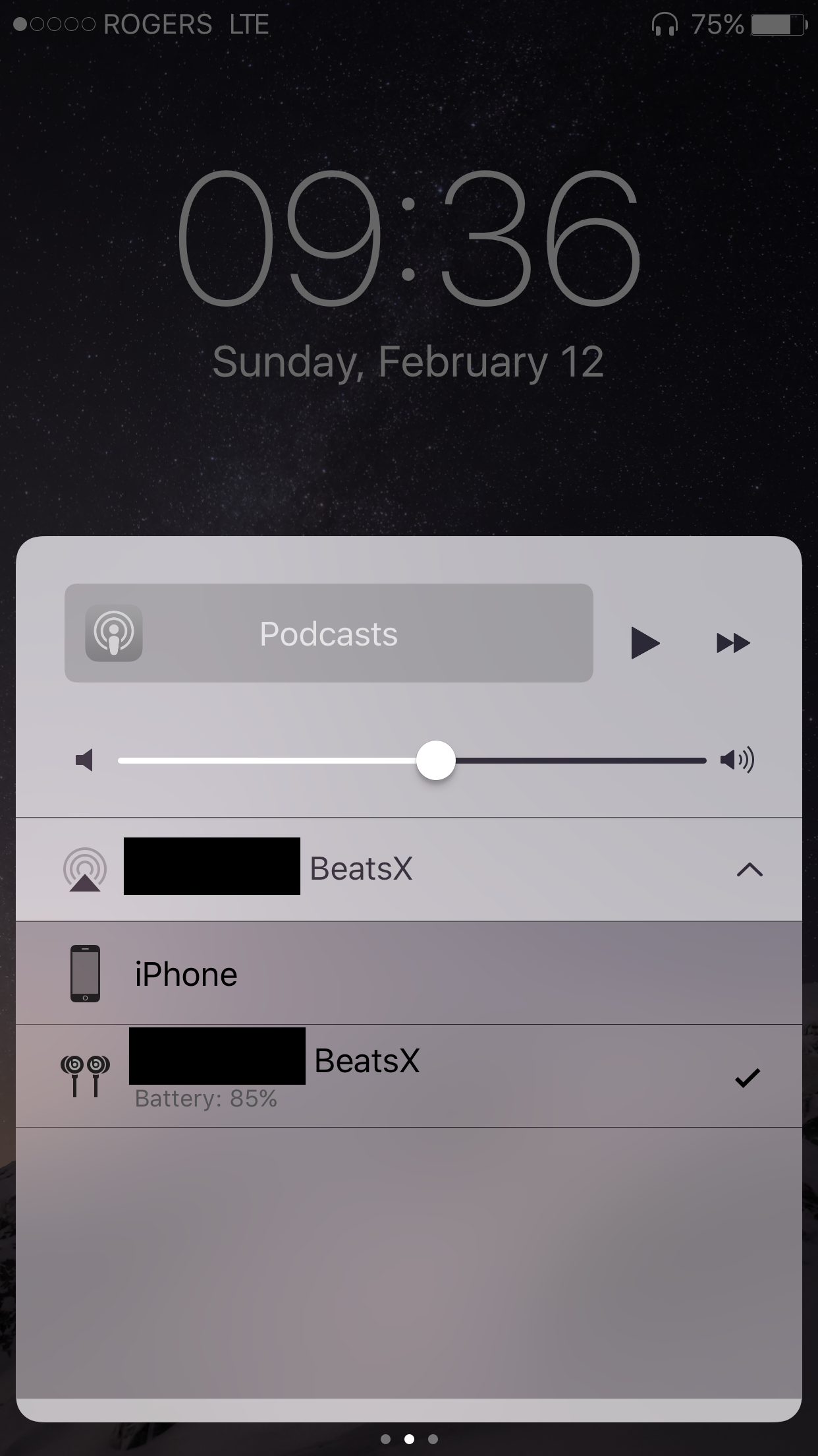

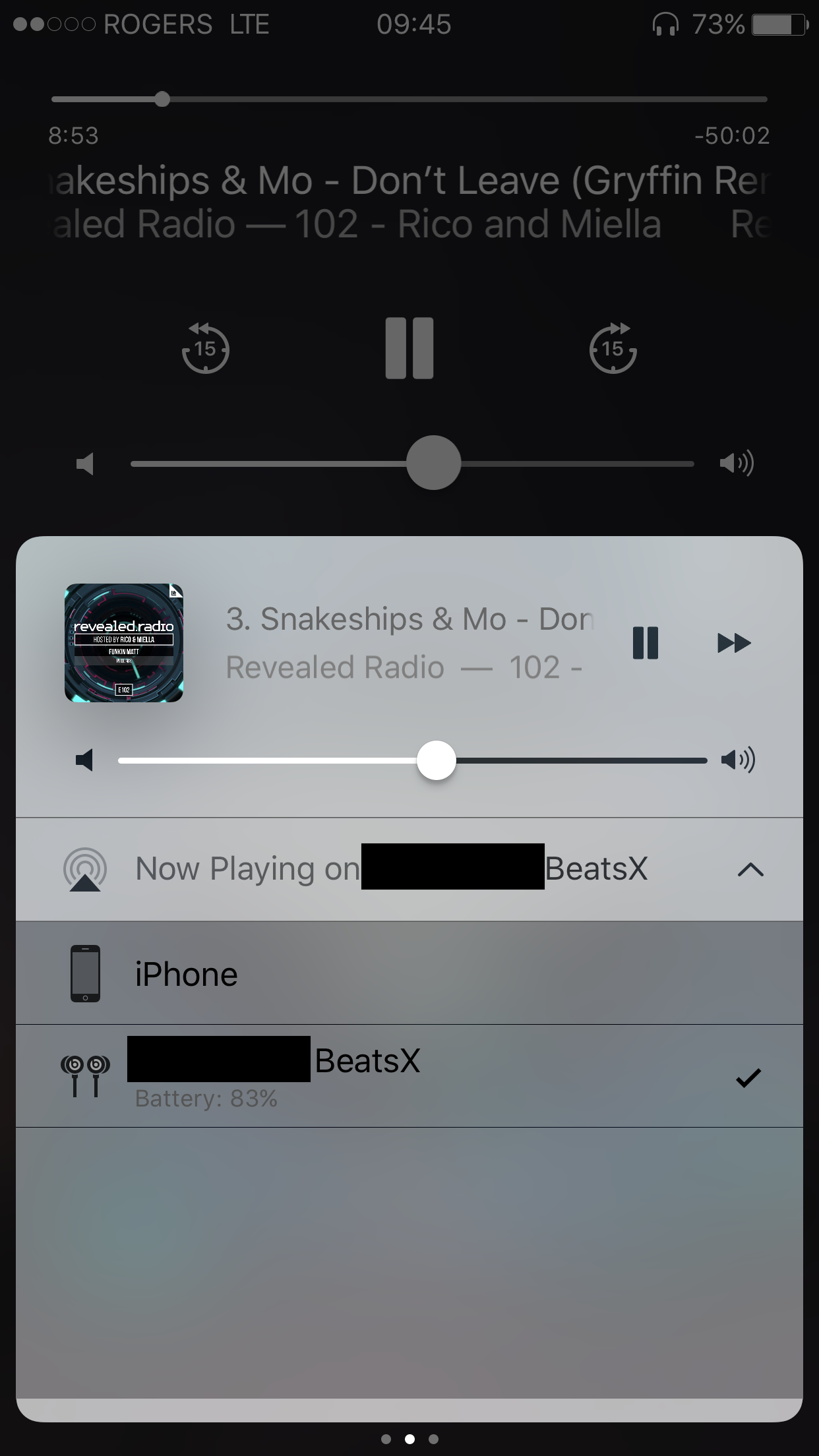

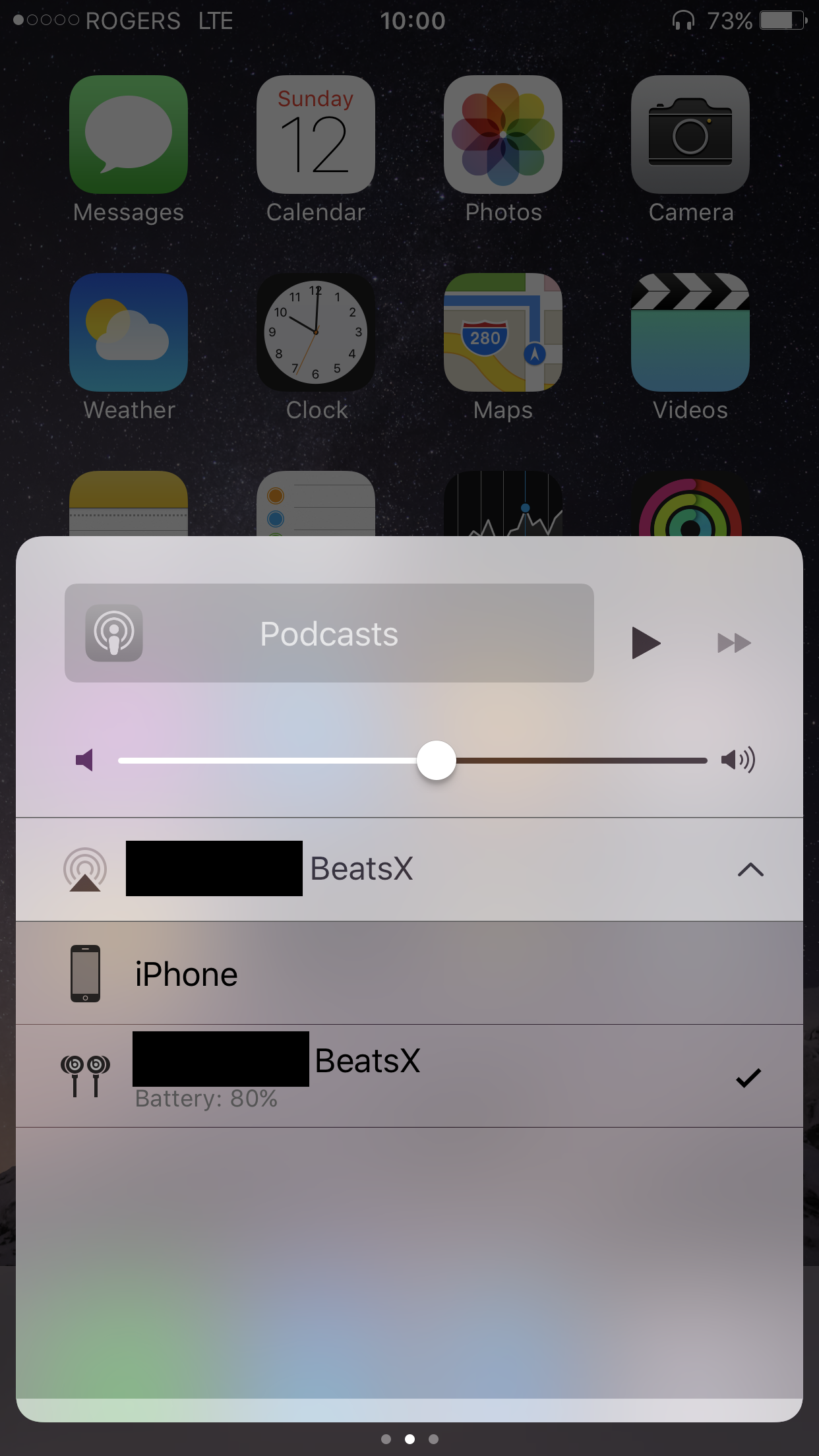

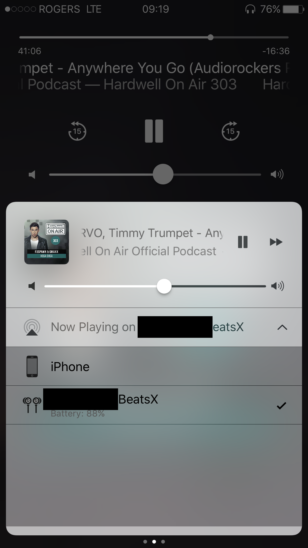

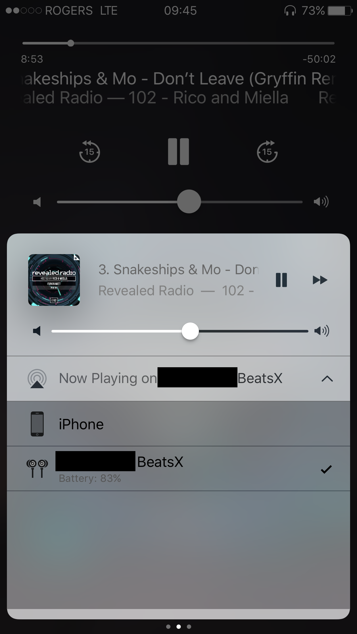

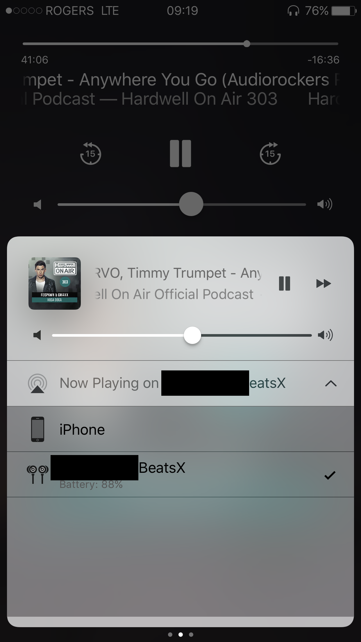

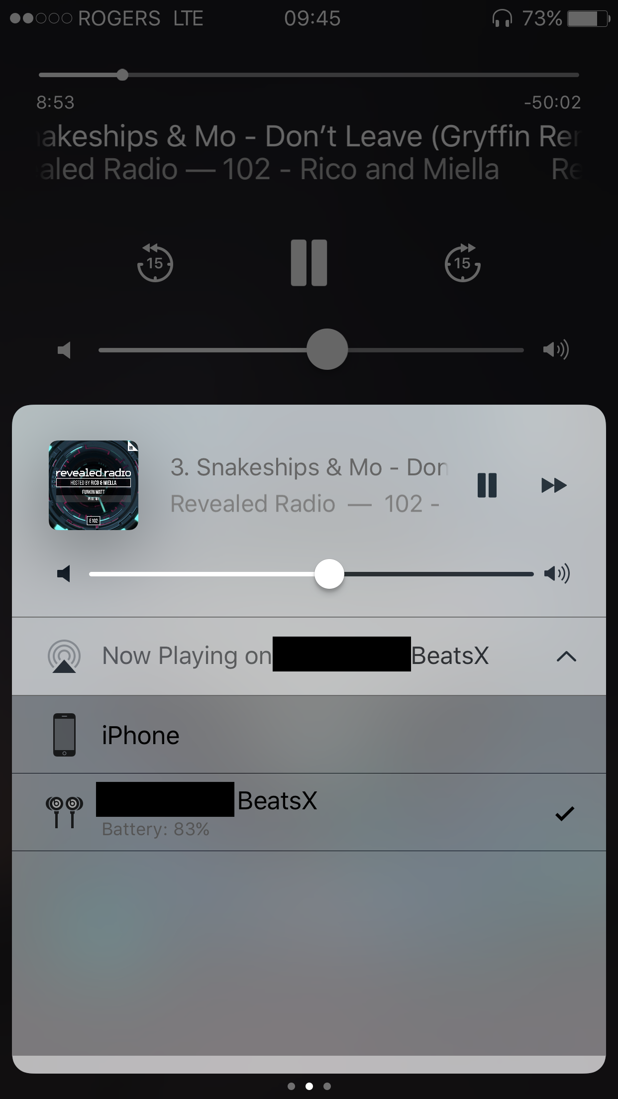

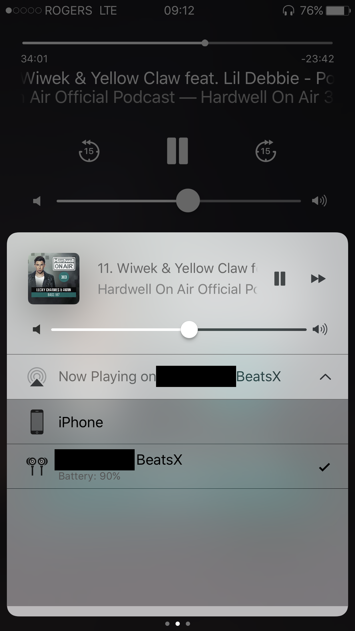

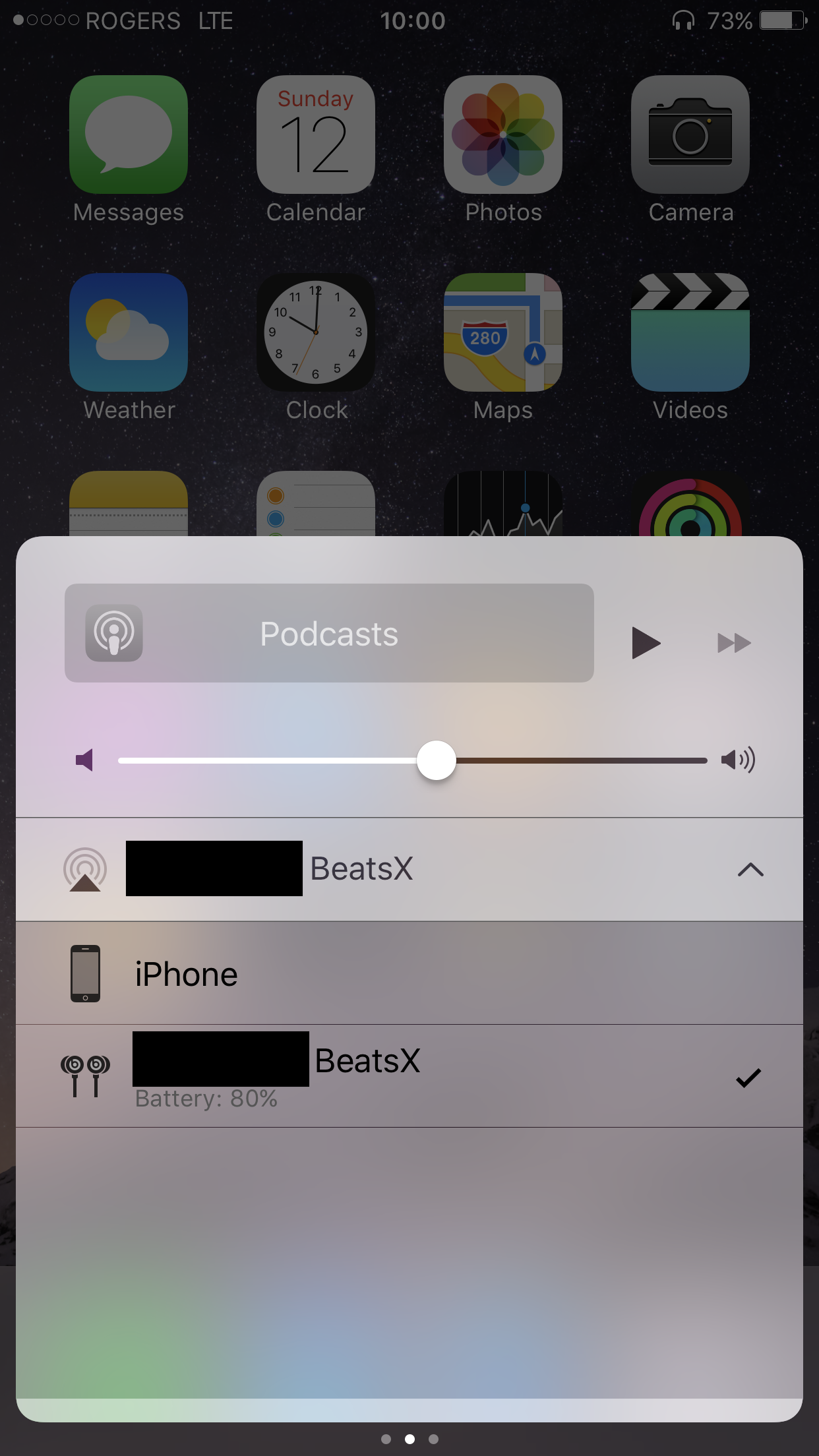

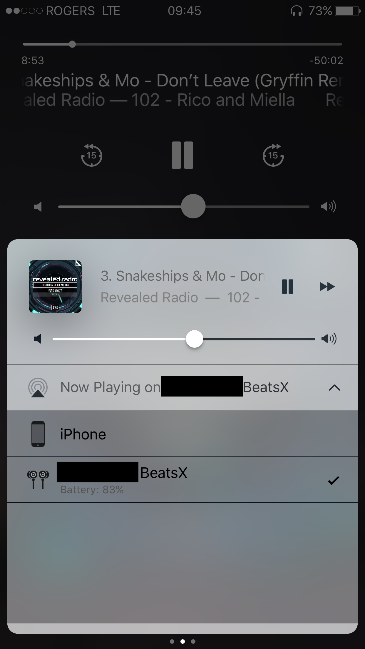

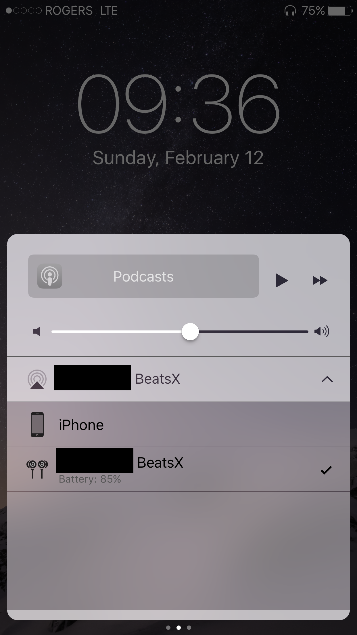

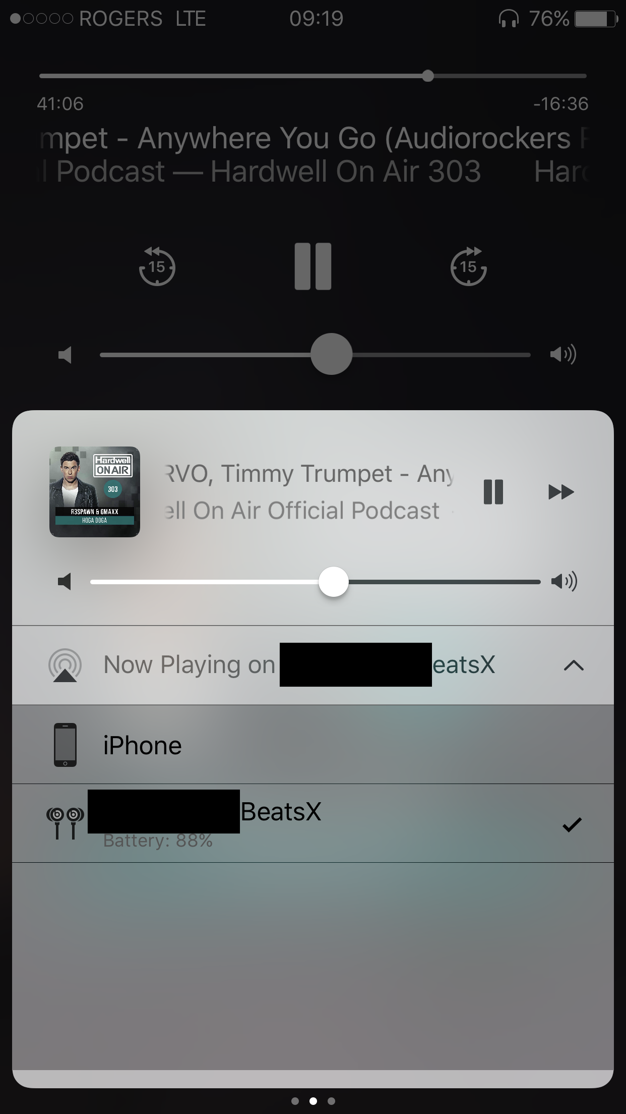

Fully charged my BeatsX on Friday evening, and shut off them right away. Picked them up this morning and they were at 97%. So they lost 3% while shut over a 28-30-hour period.
This morning I used them for my gym session and here's what I got out of them.
8:52 AM - 94%
9:12 AM - 90% (4% in 10 minutes)
9:19 AM - 88% (2% in 7 minutes)
9:36 AM - 85% (3% in 17 minutes)
9:45 AM - 83% (2% in 9 minutes)
10:00 AM - 80% (3% in 15 minutes)
Total: 68 minutes = 14%
Theoretically this would give: 485.71minutes/8.09 hours for a full charge
**Was about 2 feet away from my phone for about 40 minutes, then 10-20 feet away for the remaining 28-30 minutes.
So far so good, curious on the long run how they will maintain this 8-hour life.
8:52 AM - 94%
View attachment 688217 View attachment 688218 View attachment 688219 View attachment 688220 View attachment 688221 View attachment 688222
