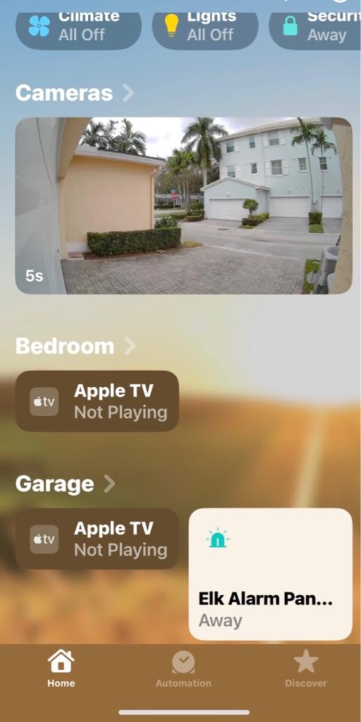

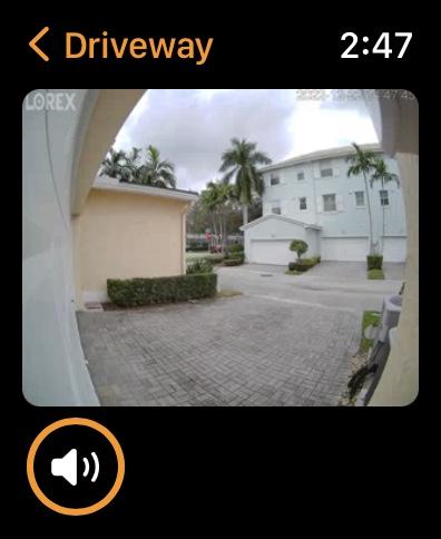

I don’t own a single HomeKit compatible device in my home, but I use Homebridge running on a dedicated Ubuntu VM and associated plugins to make my devices (lights, security panel, cameras/doorbells) compatible so I can view and control on my iPhone and Apple Watch. And I didn’t have to pay a premium or recurring extortion fee for the privilege.
