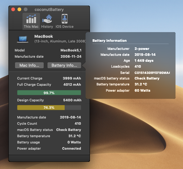

My 2-power battery seems to be of a reasonable quality and still has a decent performance after 4 years.

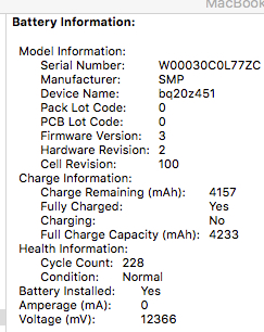

I have a couple of these (a late 08 unibody mb and a mid 09 mbp), one upstairs and one downstairs. I replaced the OEM battery in the 08 with a cheap SMP $20 battery off ebay a couple years ago when it started to bulge. This cheapo seems to be working pretty well. I've had the mb since new and I dont ever recall it getting much over 3hrs unplugged anyways. I get around 2.5-3 now depending on what I'm doing which the vast majority of that is basic DD stuff like old computer forums or YT. The mbp I get closer to 4 hours (with the battery it came to me with) which shoulders additional photography duty from time to time as well.
The late 09 macbookpros were cool as those touted impressive 2009 battery life in excess of 8 hours, so with that model if you needed to maximize unplugged time (I don't) I think it could make sense to pay up for a name brand replacement battery like newertech as they tout 8% improved capacity and limited 1yr warranty which is a nice touch.
For my needs, cheap SMP batteries from Ebay have served these machines and their mostly lap warmer lazyboy arm chair surfing role well.

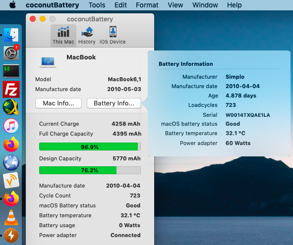

I suggest getting an original Apple battery whatever the cost is because they are reliable no matter how old they get. Here is the 13 years old battery on my MacBook late 2009:
You see even after 13 years and 723 cycles it's still in good condition.

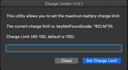

The bigger issue with the old unibody MacBooks is that there seems to be no way to limit charging via software solution. It is very easy to do on Mid 2012 MBP but my Late 2008 have to sit at 100% charge while in a clamshell mode.
Have you tried the Charge Limiter.app? It enables you to set the max charge percentage.

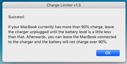

Yep it works. For instance now I've set it to 90% and here is the dialog:
The OS is Mojave 10.14.6
The fun part is that I also got a "Success dialog" message but it proved to be meaningless as it seems that it only relates to "successfully run terminal command" even though the desired outcome of running a command is not achieved.
Late 2008 and 2009 MacBooks have an identical hardware so I am not sure why 2008 MacBook is being so stubborn with regards to the setting a charge limit.
Well, in my MB late-2009 it works without an issue. I've just tried it by unplugging the power chord and wait until the percentage dropped %90 I've plugged in the power chord and the charging LED went red for a second or two then green meaning the power adapter doesn't charge the battery, as it is intended. Here is a screenshot showing everything in action. The version of Charge Limiter.app I use is 1.5
