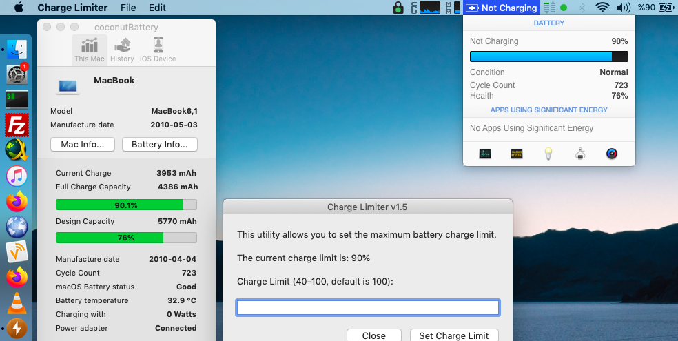

Well, in my MB late-2009 it works without an issue. I've just tried it by unplugging the power chord and wait until the percentage dropped %90 I've plugged in the power chord and the charging LED went red for a second or two then green meaning the power adapter doesn't charge the battery, as it is intended. Here is a screenshot showing everything in action. The version of Charge Limiter.app I use is 1.5
The only difference that I can think of between our MacBooks is the firmware which probably makes all the difference.
The fun part is that I also got a "Success dialog" message but it proved to be meaningless as it seems that it only relates to "successfully run terminal command" even though the desired outcome of running a command is not achieved.
Late 2008 and 2009 MacBooks have an identical hardware so I am not sure why 2008 MacBook is being so stubborn with regards to the setting a charge limit.
The predicament you describe also limits the early 2008 MBP, as I just tested (running High Sierra).
Despite installing the Swift 5 runtime support prior to, the BCLM parameter is not present and the Charge Limiter utility will not work. This is probably because the firmware, pre-late 2009, lacks this (nvram) parameter — not unlike how, in the PowerPC days, tinkering with sleep/hibernate modes on even later G3 models running Tiger, has no impact/does not work, as those parameters were not yet defined by the firmware at that time.
In other words, the BCLM parameter maps to nothing on the older systems like ours. I must say I’m somewhat disappointed, having gone through three aftermarket (i.e., dodgy) batteries on my A1261 since 2021, and I was asking about something relating to this quite some time ago, back when I was still on the first of those batteries). Per the definitive, final answer by @AphoticD, it seems the cut-off is around that late 2009/2010 window, and Swift runtime is involved.

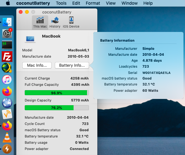

I suggest getting an original Apple battery whatever the cost is because they are reliable no matter how old they get. Here is the 13 years old battery on my MacBook late 2009:
You see even after 13 years and 723 cycles it's still in good condition.
Have you tried the Charge Limiter.app? It enables you to set the max charge percentage.

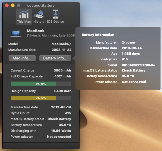

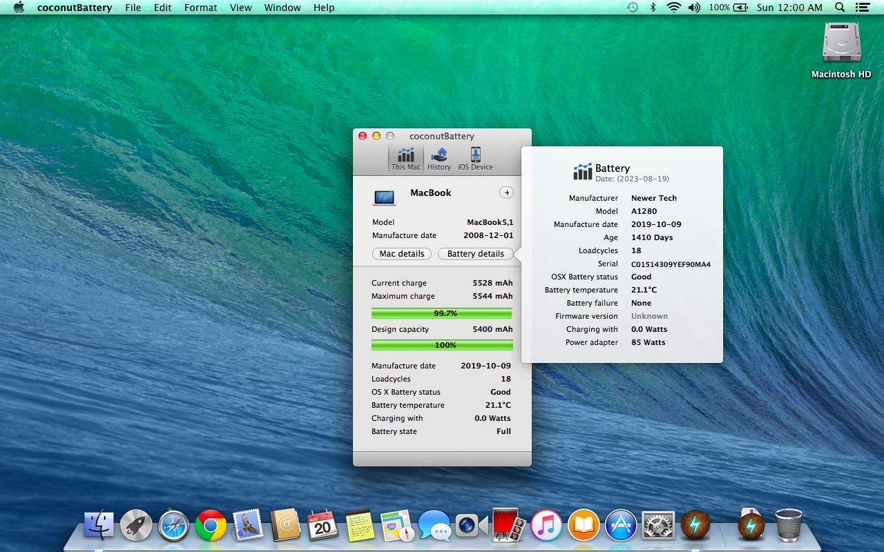

The NewerTech battery that I purchased from OWC is now 4 years old and still has 100% capacity.
While many variables can affect battery life and longevity, disconnecting the computer it from the mains during non-use/storage and keeping it in a cooler environment (50-70 F) should help extend its life. I do this with all my old laptops and have had good experiences. Hope this helps.

I've been thinking about this since I picked up this model for a project not too long ago.
It being a one-off by Apple certainly doesn't help. Luckily I have a battery that's still in pretty decent condition, but I've decided that I am only going to plug it in every few months to try and keep an already ~15 year old battery fresh.
It is currently at a cycle count of 90 with ~4128 capacity.
