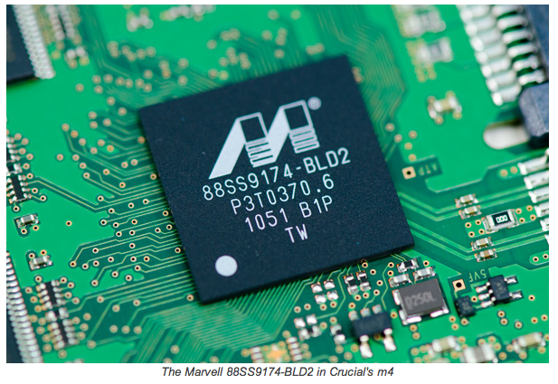

The Sandforce controllers in the M4 perform worse in real life usage, especially in random read and write. The controller compresses data and inflates benchmark scores.
Besides, you're better off getting a super reliable Samsung instead of an SSD with a Sandforce controller - a 3% failure rate in the first year is far too high, especially if you're depending on it to hold your data.

Ummm where do you get your info from? Crucial uses a marvell controller just like the intel drives...http://www.anandtech.com/show/4253/the-crucial-m4-micron-c400-ssd-review
