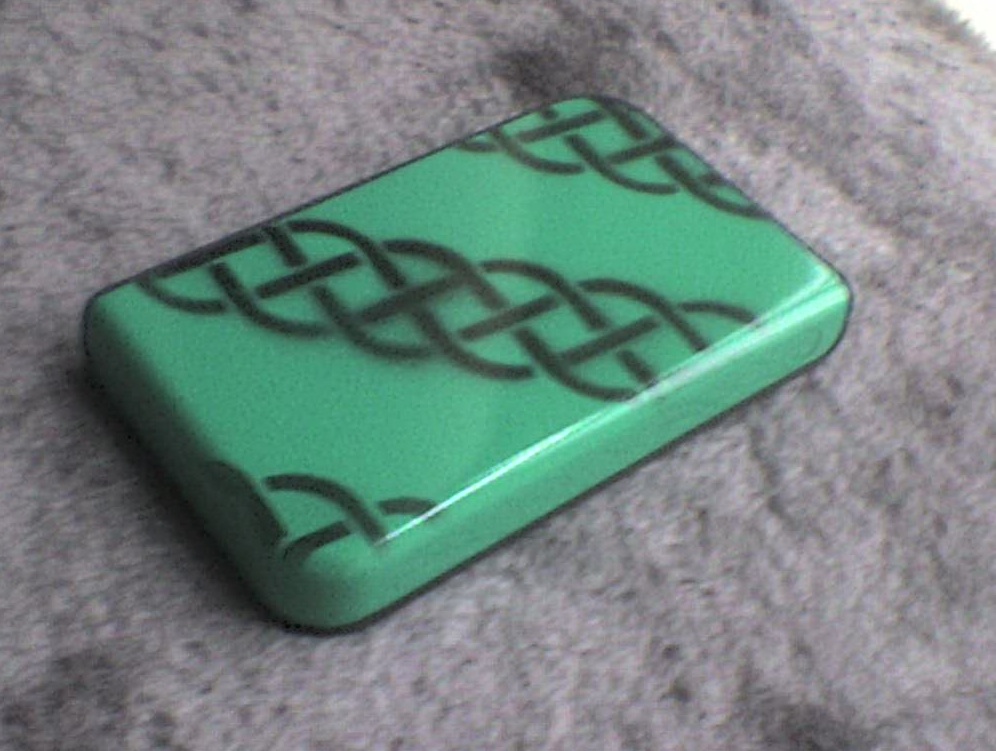

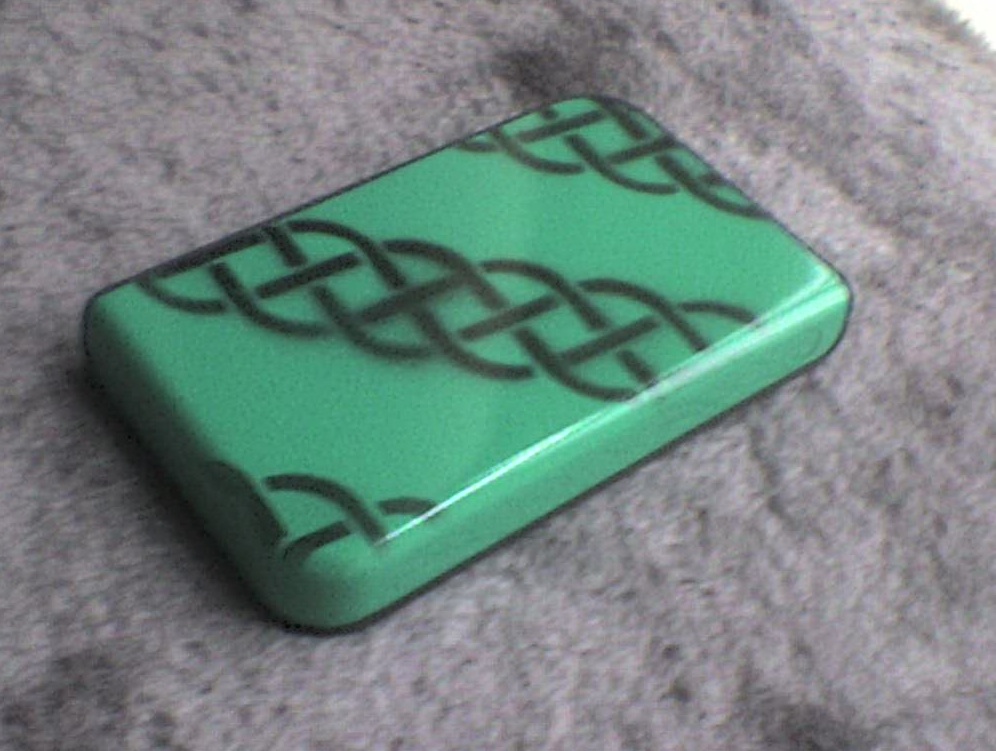

That Youtube vid has it about right. Only thing to mention is that the first time you try it - it's a lot harder ( and scarier ) than the others.
Once you've done it - hell - why not customize the plastic lid 🙂 This one I did for my other half, so I can tell her Pport from mine.
