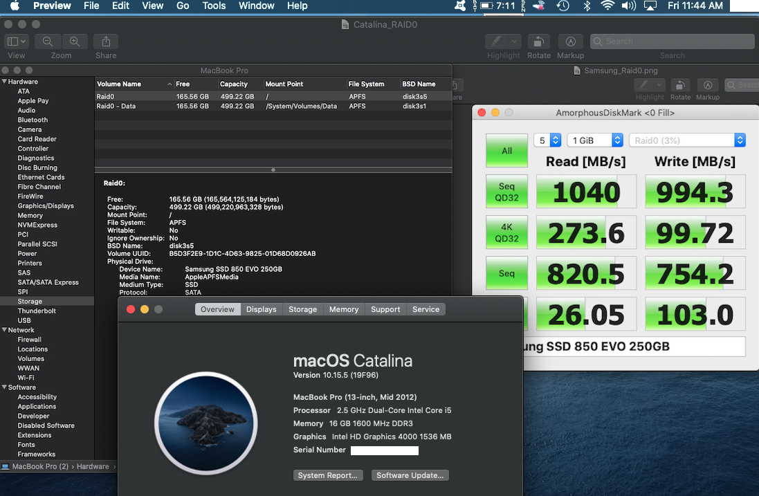

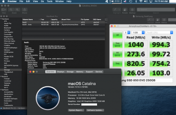

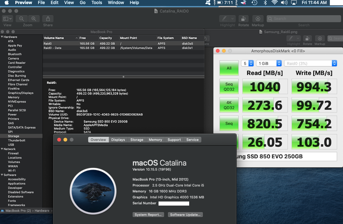

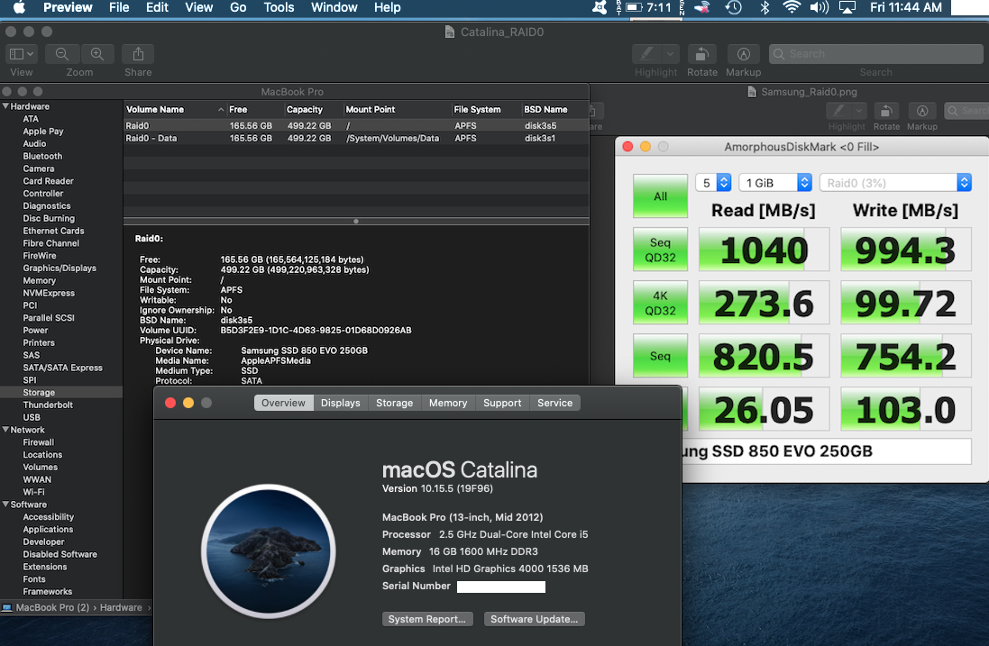

I would definitely keep 16gb crucial (2 x8gb) + both crucial SSD, i have similar Mid 2012 13"MBP (16gb crucial) although running in Raid0 setup, but very smooth with latest catalina.
