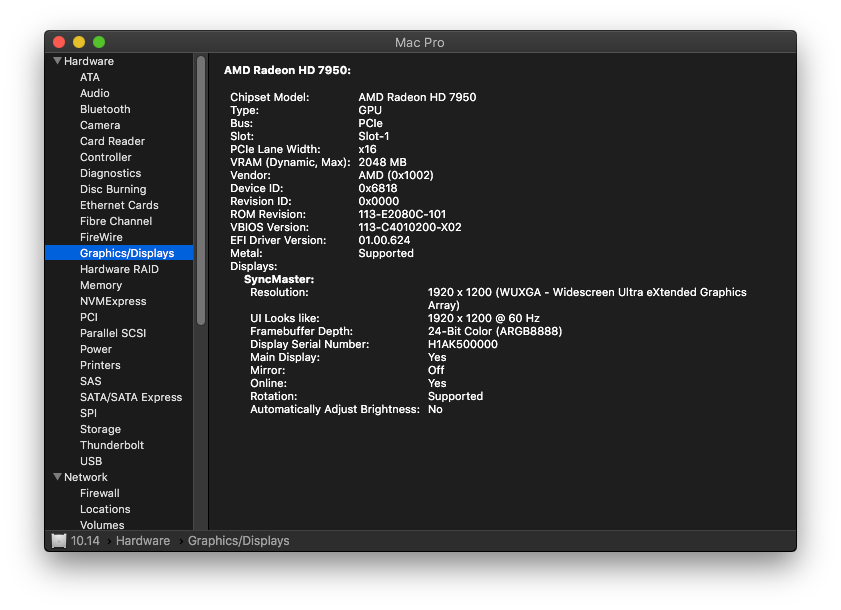

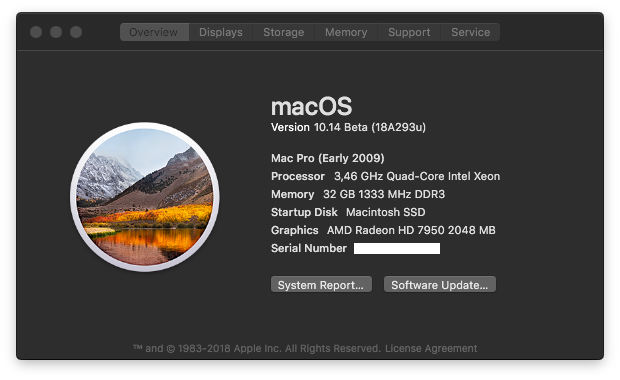

Do you know if the Saphire HD7950 Mac Edition would work with Mojave? I would like something plug and play, and that lets me use my Mac LED display (Mini display port). Any advice would be welcome

Yes, it works. Btw, any AMD GCN1.x card works with Mojave, so HD7870/7950/7970/R9-280/R9-280x and others works with Mojave and can have boot screens if you flash it.
One more thing, with you want to test Mojave DP2/PB1 you have to install it with startosinstall with AMD GCN1.x cards. At the moment, the standard installer only installs RX480/RX560/RX580 cards.
