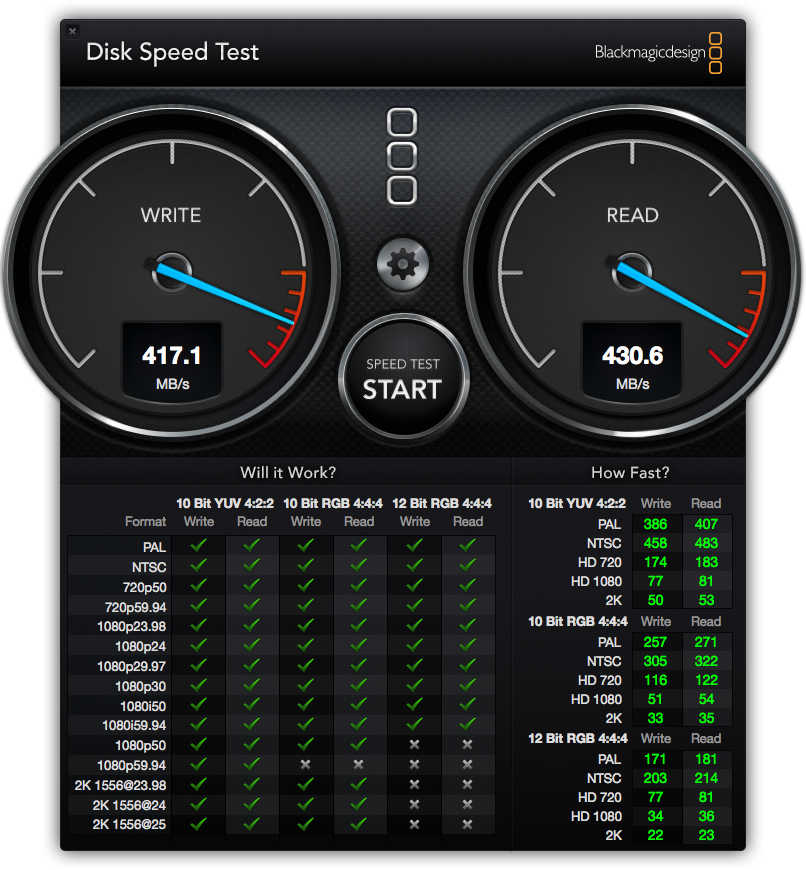

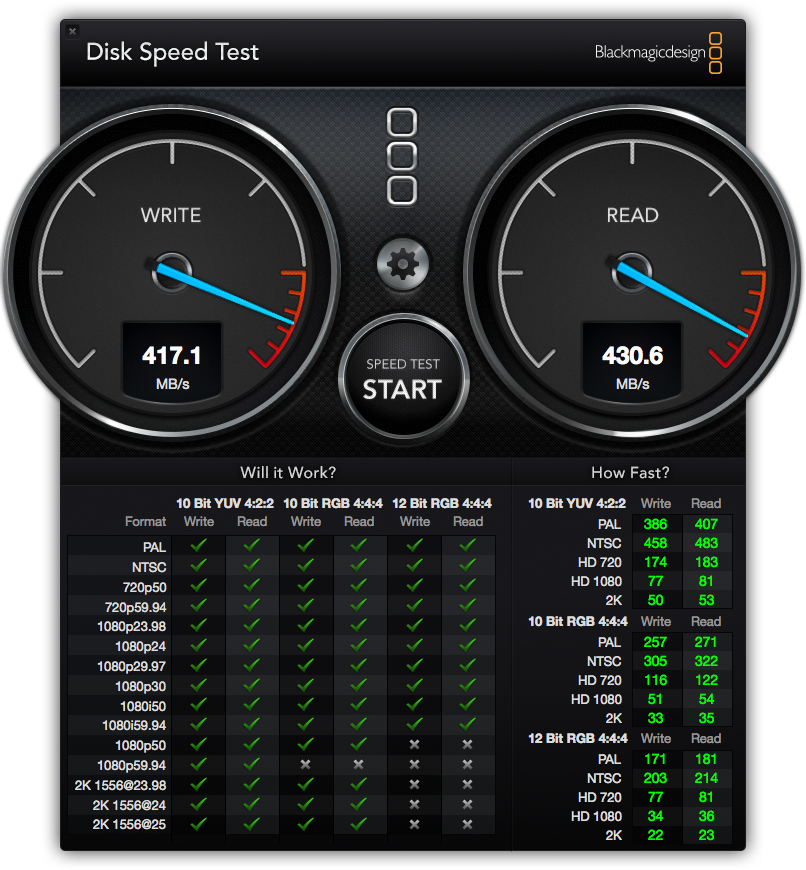

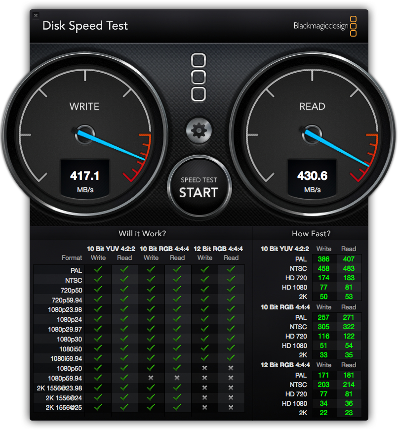

I'm not making it an external boot disk, but I just got the MX100 512gb and put it in the Inateck UASP enclosure from Amazon to be used to put photos on instead of a WD external. This is what I'm getting for blackmagic results. This is on a late 2012 iMac.
Impressive speeds. Everybody who has bought that enclosure seems to have good speeds with it.
Yeah that's great speeds. The problem, as mentioned earlier, is no TRIM support on the SSDs, so that performance is going to degrade substantially over time with USB 3, so good that you're not going to use it externally there.
