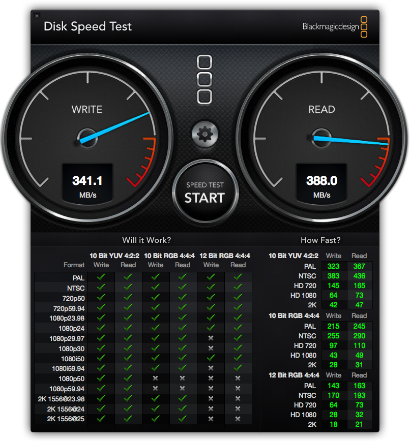

I have posted the DiskSpeedTest for the 1TB EVO on the Seagate in other threads, but here it is again for you: 🙂
Hmmn, thanks for the pic, you getting good speeds but was expecking more from the samsung 840 evo & the seagate TB adaptor, you got this on a 27" 2012 iMac?
