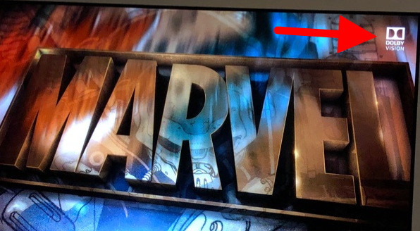

I would like to ask a similar question:
Does Netflix actually broadcast a superimposed Dolby Vision logo in the corner of the screen when you are actually receiving DV correctly? The reason I ask is because I have been trying to see that logo and it never shows up, even though:
1. I am using an Apple TV 4k and it indicates it's formatted for Dolby Vision 4k in the settings.
2. My TV is a brand new SONY XBR-75X950G LCD unit that does support DV. In fact, when I switch to a show that is supposed to be in DV, the TV responds by switching to offering me 3 specific Picture Settings in Dolby Vision (Bright Dolby Vision, Dark Dolby Vision and Vivid). So I THINK I'm getting it properly -but I have yet to see the dang logo.
I'm not talking about the tag that comes within the show's Description, the one you can see if you swipe down on the Apple TV 4K remote. I'm talking about an indicator that is supposed to pop up onscreen for a few seconds, at least so I'm told by at least one TV-savvy blogger:
I've never seen any Netflix logo on my LG showing that the title is playing in Dolby Vision. When the Apple TV starts up I do get the DV logo which then goes away. If you install the Developer HUD on your Apple TV the display shows SDR or HDR.

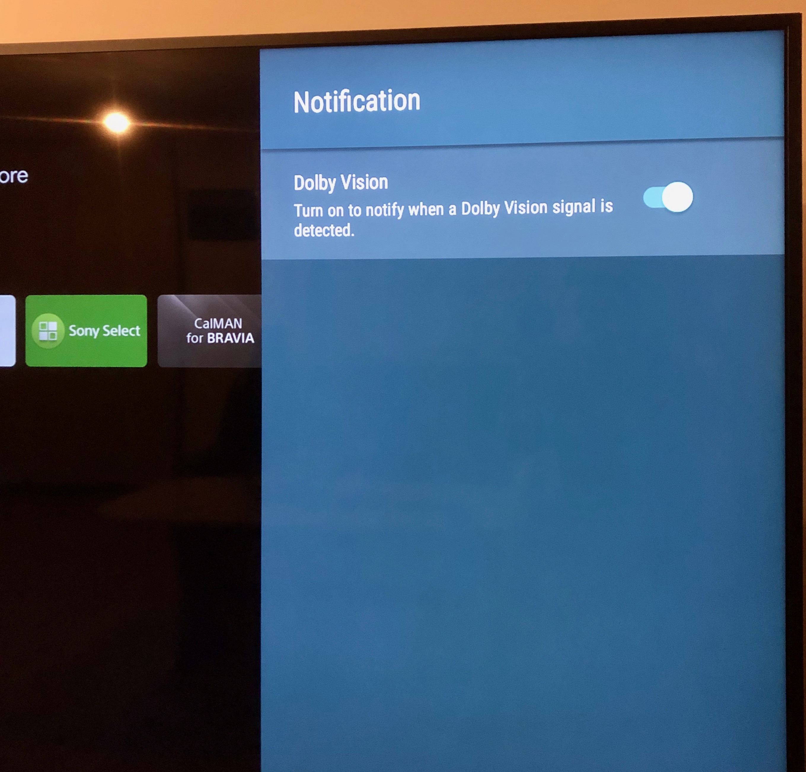

Look under
Settings > Display > Notification:
PS you can confirm that the TV is in DV mode by going
Action Menu > Picture and look under picture mode - it shall say Dolby Vision.

Unfortunately, my version of the Android software (8.0) doesn't seem to have that option. How exactly do you get notified when you ARE watching DV?
Priitv8 (or anyone),
Here's a screenshot from the article I linked to above that shows what it looks like, or at least what it used to look like when the DV logo pops up at the beginning of a show:
Is this the kind of notification you see? Or are you referring to something else?
Has anyone seen this on Netflix recently? I'm beginning to think that they no longer do this....(superimpose the logo)...
