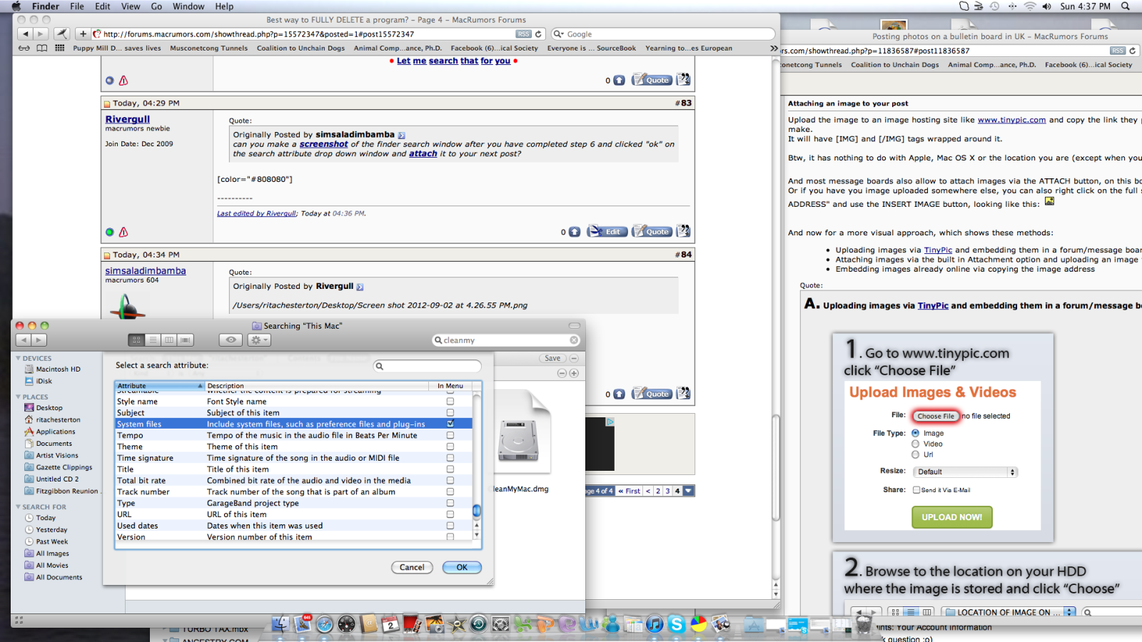

I completed #6, choosing Other (which instantly takes me to a list of Attributes; from the list I chose System Files (also choosing the checkbox to the right of that line). At that point, I'm stuck. Don't know if I should then click "OK" and be shown the option of changing "aren't included" to "are included"...or if I should have already done that earlier.
can you make a screenshot of the finder search window after you have completed step 6 and clicked "ok" on the search attribute drop down window and attach it to your next post?
/Users/ritachesterton/Desktop/Screen shot 2012-09-02 at 4.26.55 PM.png
Your screenshot is still on your local HDD, thus no one can see it.
How's this?
How's this?
How's this?
The screenshot shows up, but I meant a screenshot of after you have pressed the "OK" button.
I didn't know if I SHOULD press the "OK" button. I thought I needed to choose "are included" before doing that. Sorry for the large screenshots. I tried to delete them from the board .... but.... they won't go away.
In any case, I'll click the "OK" button and hope that the choice for "are included" will appear.
Okay... the option for choosing "are included" did appear. (your directions were a wee bit confusing because you didn't say click "OK" ;o)
NOW.....#8 says something about sorting. I already see all of the file icons for Clean My Mac, so see no reason to sort by name, kind, date, etc.
I think I'm ready to 'select all' and Delete. I will hold onto my Trash for awhile to see if all is fine.
Thank you SO much for helping me!!! Wish I never downloaded CMM at all...and realize now that Mac OS X cleans itself basically and I don't need to do anything else. -Rivergull
As shown in the video I embedded, it appears after you press OK, as you only add attributes via the method shown in step 6, thus why I posted this:I didn't know if I SHOULD press the "OK" button. I thought I needed to choose "are included" before doing that.
Can you make a screenshot of the Finder search window after you have completed step 6 and clicked "OK" on the search attribute drop down window and attach it to your next post?
Use theSorry for the large screenshots. I tried to delete them from the board .... but.... they won't go away.
As you probably already have clicked that "OK" button, you should see that selection now.In any case, I'll click the "OK" button and hope that the choice for "are included" will appear.

or after. I did succeed in sending all Clean My Mac items to the Trash. I still can't seem to delete those screenshots though, as I don't understand your directions. I clicked on "Edit" button and boxes appear, asking for a 'Reason' for deleting and a 'Title'. Not sure what to enter in those boxes and there's no "Delete" button anyway. Grrrrr. Must take some lessons on posting to MacRumors.
tag, which is the closing tag.As shown in the video I embedded, it appears after you press OK, as you only add attributes via the method shown in step 6, thus why I posted this:
Use the Image button below the post with the large screenshots, you may have to scroll to the right via trackpad, RIGHT ARROW or scroll bar to see it, to edit your posts and remove the images (start with IMG and end with /IMG, with [] brackets surrounding that) or add a T infront of every IMG tag as shown before.
If not, we can help further.

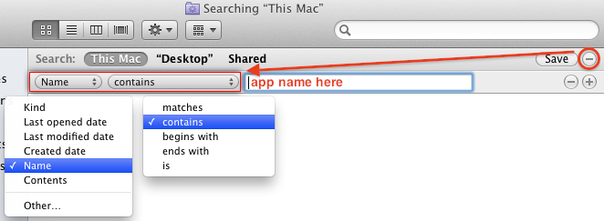

- In Snow Leopard and earlier, click "File Name" instead of "Contents" for better results.
In Lion and later, click the + button below the search term, then select "Name" "Contains" and enter the app name. (see image)
