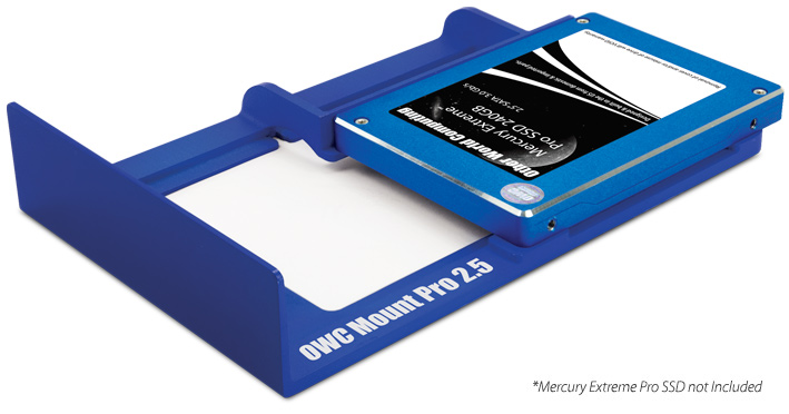

After some research on the forums, it looks like there are three main ways to interface directly with the SATA connector in the Mac Pro.
2006-2008 Mac Pro: Use MaxUpgrades' MaxConnect sled for 2006-2008 machines
2009-2010 Mac Pro: Use OWC's Mount Pro or MaxUpgrades' sled for 2009-2010 machines
Any Mac Pro: Use OWC's Multi-Mount adapters for the optical bay (scroll down for Mac-specific options)
Also, there are cheap 5.25" to 3.5" adapters on Newegg which would probably work in the Mac Pro optical bays. But the 3.5" to 2.5" ones probably won't work for the 4 SATA bays since the Mac Pro sleds attach to the hard drive from the large bottom surface, while most adapters are for the sides.
Another possibility is the Icy Dock, but I've seen lots of complaints that the adapter is flaky due to the fact that Icy Dock is not a direct connection to the Mac Pro's SATA connector. Perhaps they've finally fixed the problem.
