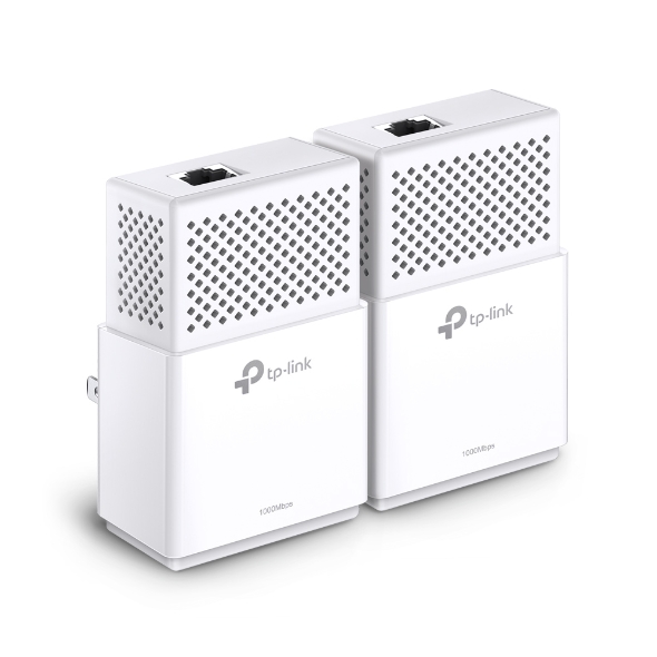

ONE MORE OPTION (probably mentioned to you in the other threads about this): those powerline ethernet connections can work pretty well.
For a relative with solid walls but needing ethernet instead of wifi for- coincidentally- stable AppleTV watching, an experiment with those yielded a fast enough connection with no wall holes/drilling. It's easy enough to try those first. Basically that would be:
  • Landlord router ethernet jack: ethernet cable to one powerline ethernet box plugged into the wall.
  • Sister powerline ethernet box plugged in in your space: ethernet cable out of it and into either AppleTV or your own extender or router... but you could test ethernet speed with your laptop.
If you try this and get it working, the next thing to try is moving your end of the connection to a plug perhaps close to your AppleTV and seeing if it works there too (with these things, some plugs can work and others won't). If so, that can deliver a wired ethernet connection to your AppleTV and your Mac, etc can continue to lean on the wifi that seems "good enough" (to you) on those other devices. I just took a peek at Amazon and none of those on the first page are more expensive than $120 with many with good ratings down below $50.
I would generally NOT expect that to work better than a direct ethernet connection and it may not work at all depending on how that place is wired... but that will be easy to try, perhaps BEFORE you drill holes and/or partner on a new router. AppleTV doesn't need super fast connections even to stream 4K video but it does need a relatively steady connection. So this might be a way to get "fast enough" WIRED without much expense or a true cable run.

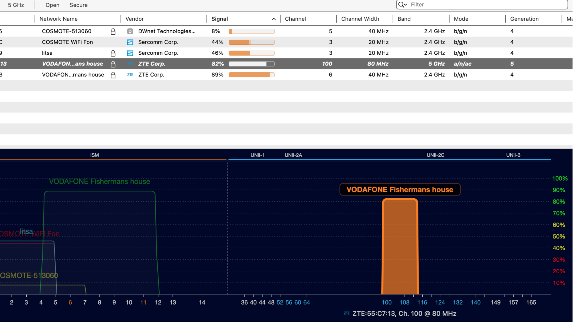

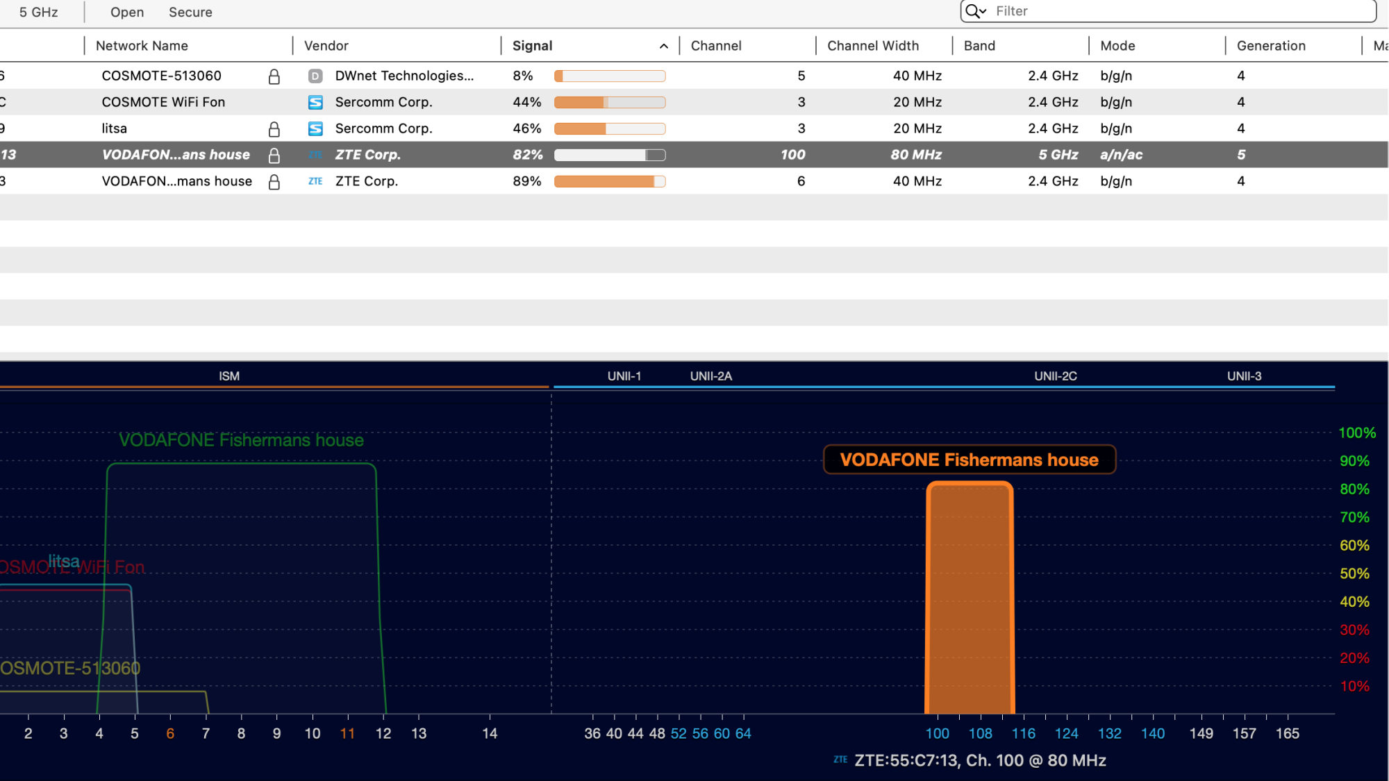

Did you spend 5 minutes of your life and do as suggested above "To check the signal strength download the free app on your MacBook "WiFi Explorer Lite"."
If/when you have done so pls attach a screenshot of the result, it will show the signal strength and specific channel usage in your location. Nobody can give you any guidance without basic facts from your side.
