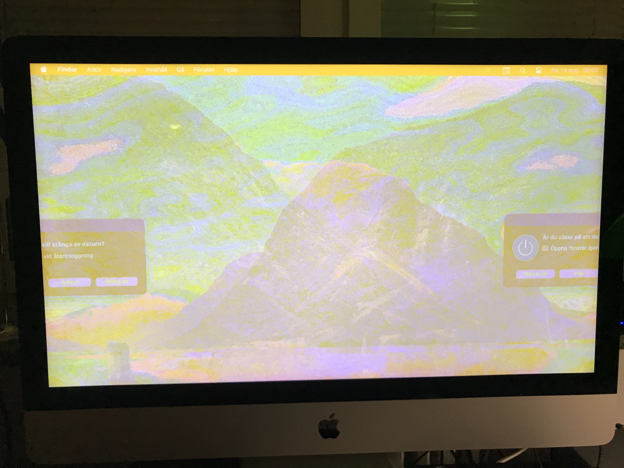

Can someone that using iMac 27” late 2015 try to start in safe mode with PB 3 installed and see if you get any graphical issue like I do? See attached picture. This happens in PB 1.
