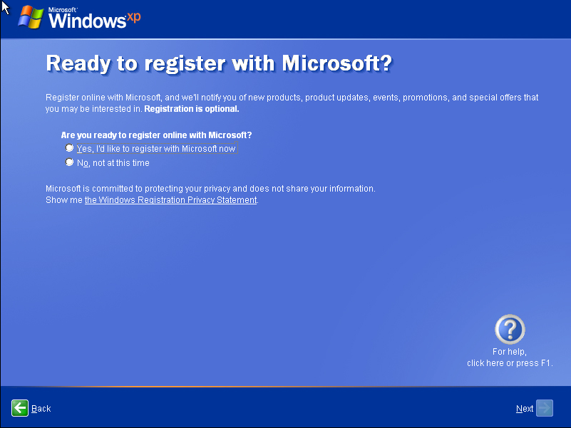

What screen is that on? You always have the option of skipping authentication when installing windows, at the screen just before where you are supposed to enter the code. Here's a screen shot:
Apples and Oranges. The Code he is talking about is required to get the disc going. It has nothing to do with talking to M$.
