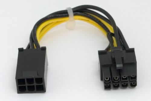

you need a 6 pin to 8 pin cable, without that you will not be able to use your card!
like this one
so apple 6 pin to 6 pin then pc 6 pin to 8 pin then 8 pin end in to GPU.
i use the 6 to 8 pin that was in my GPU box.

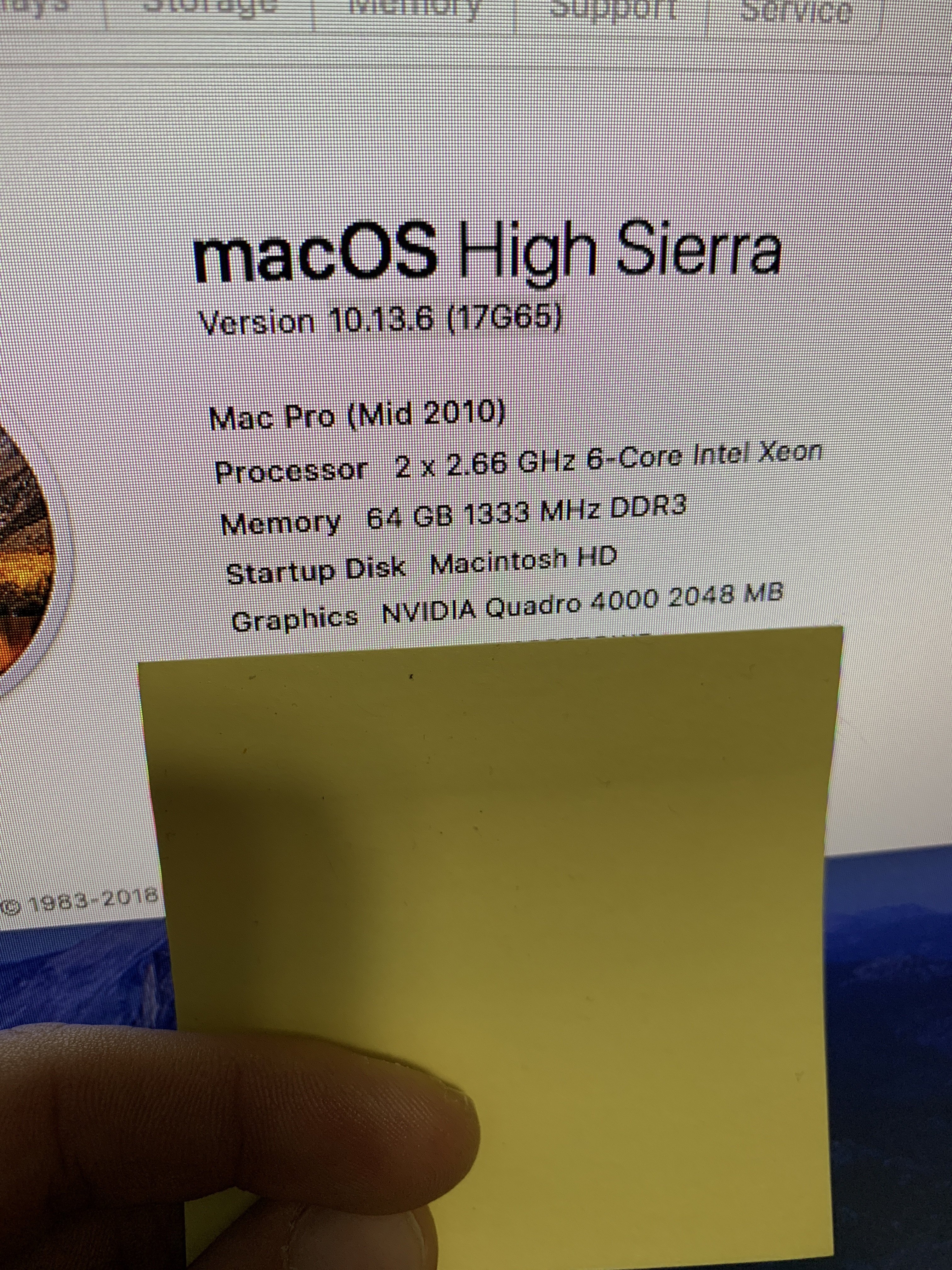

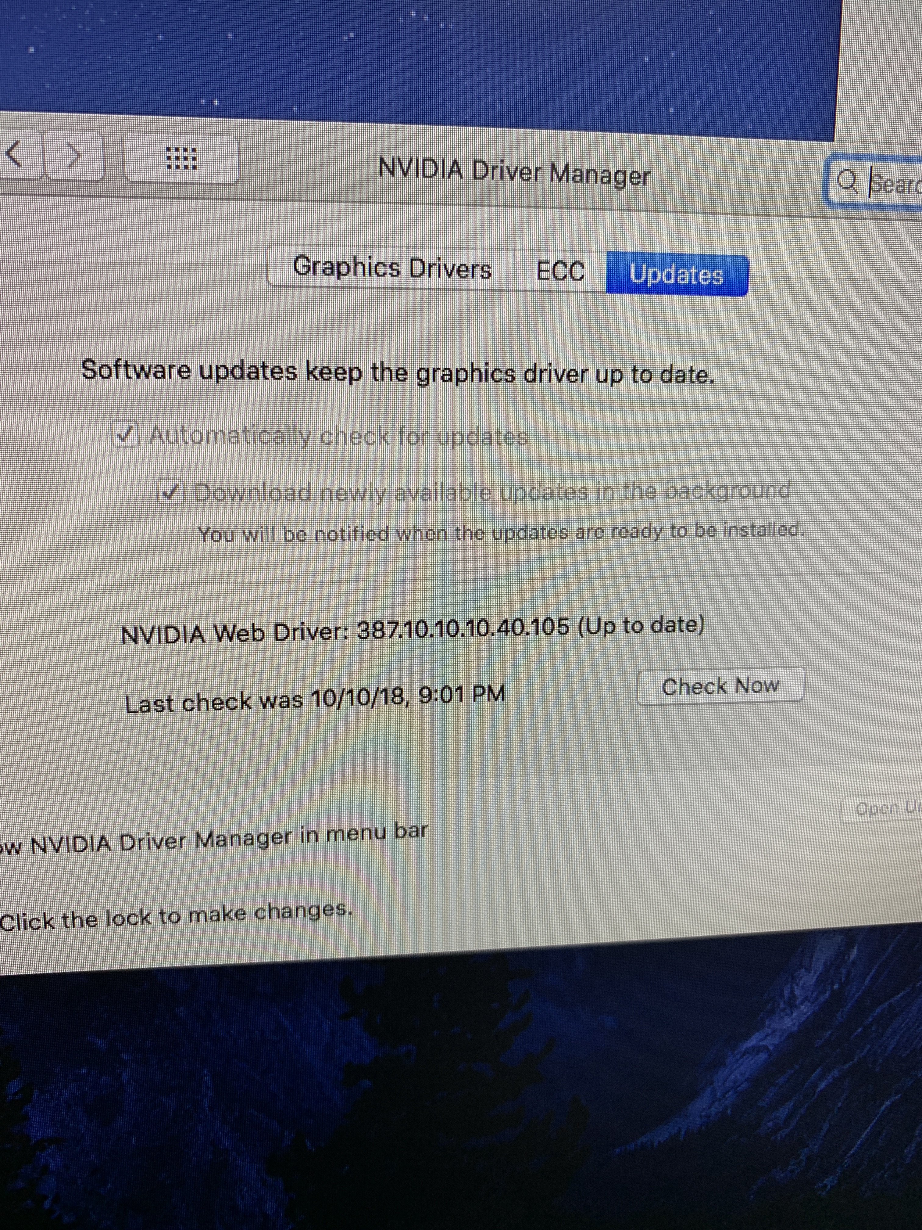

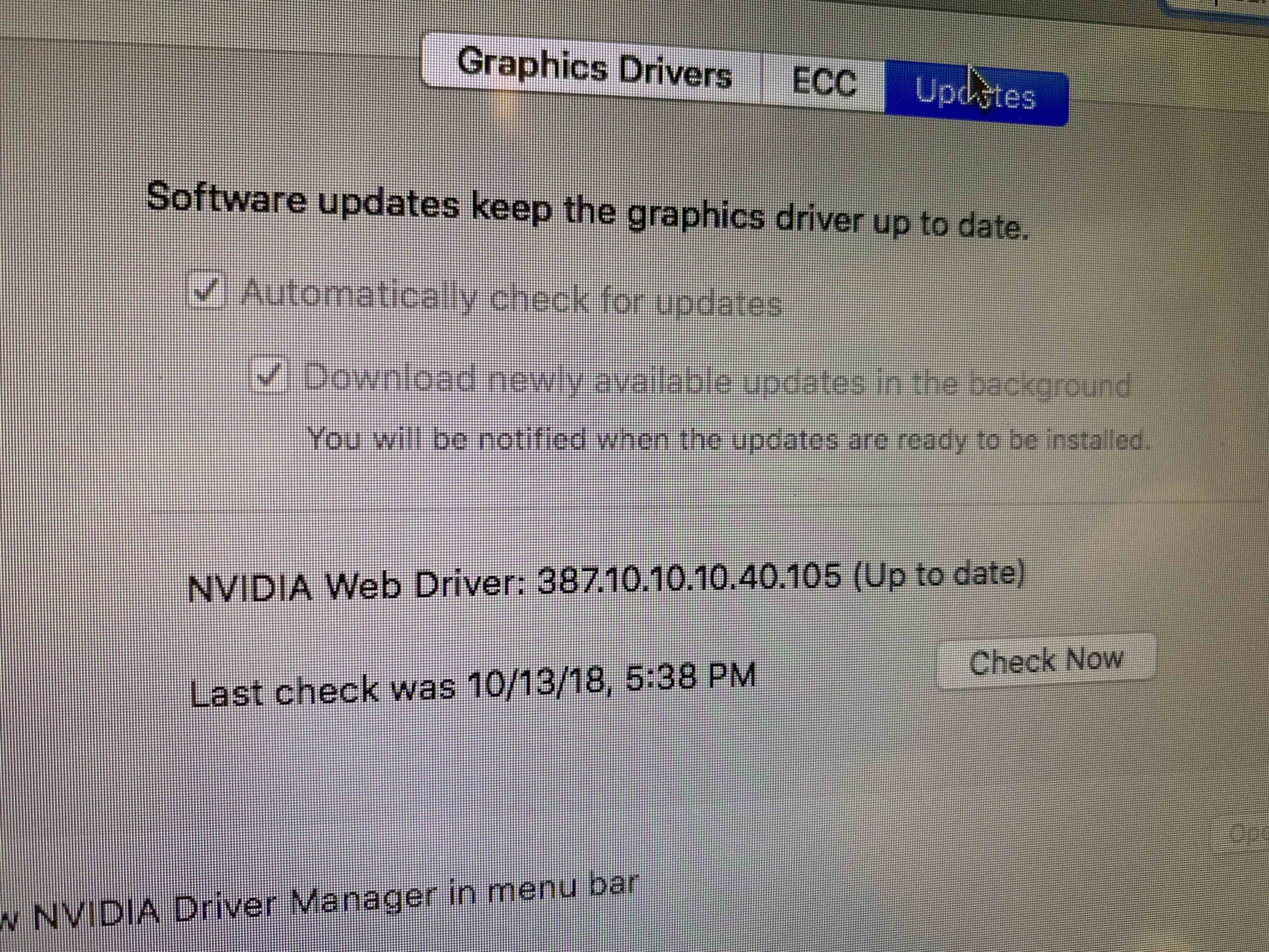

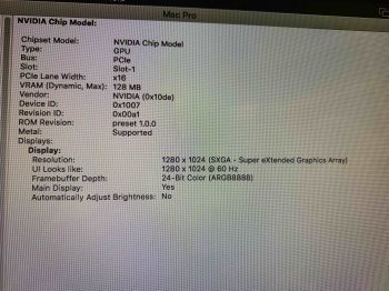

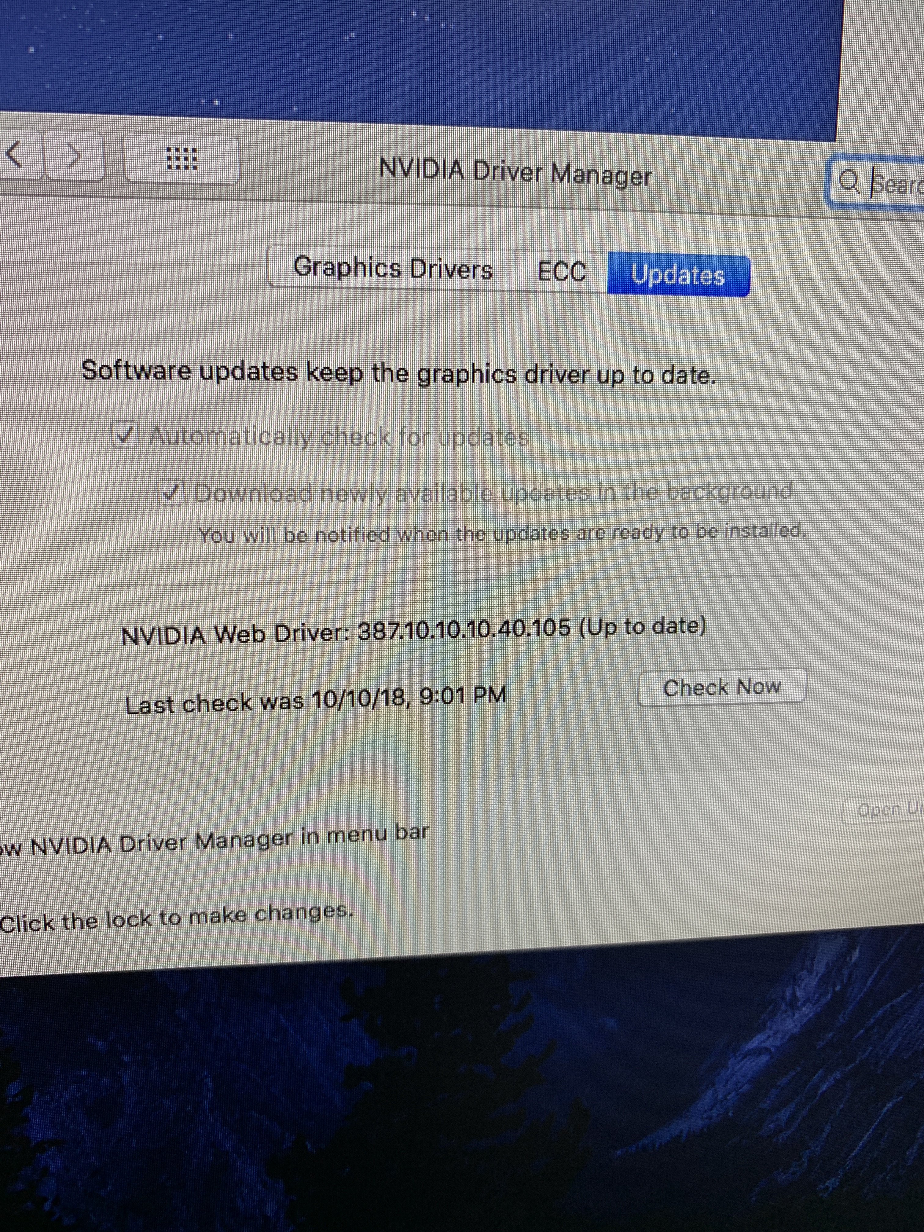

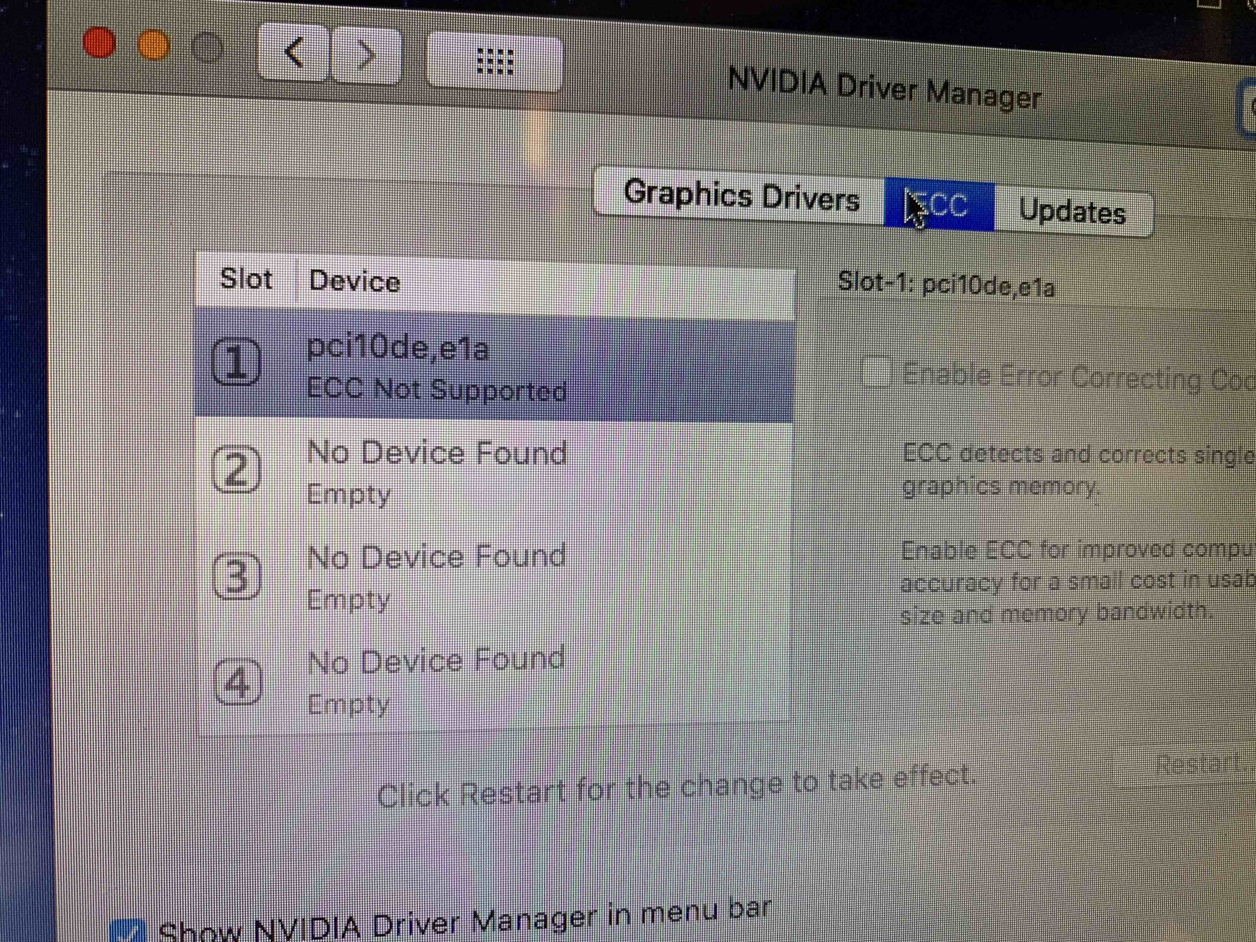

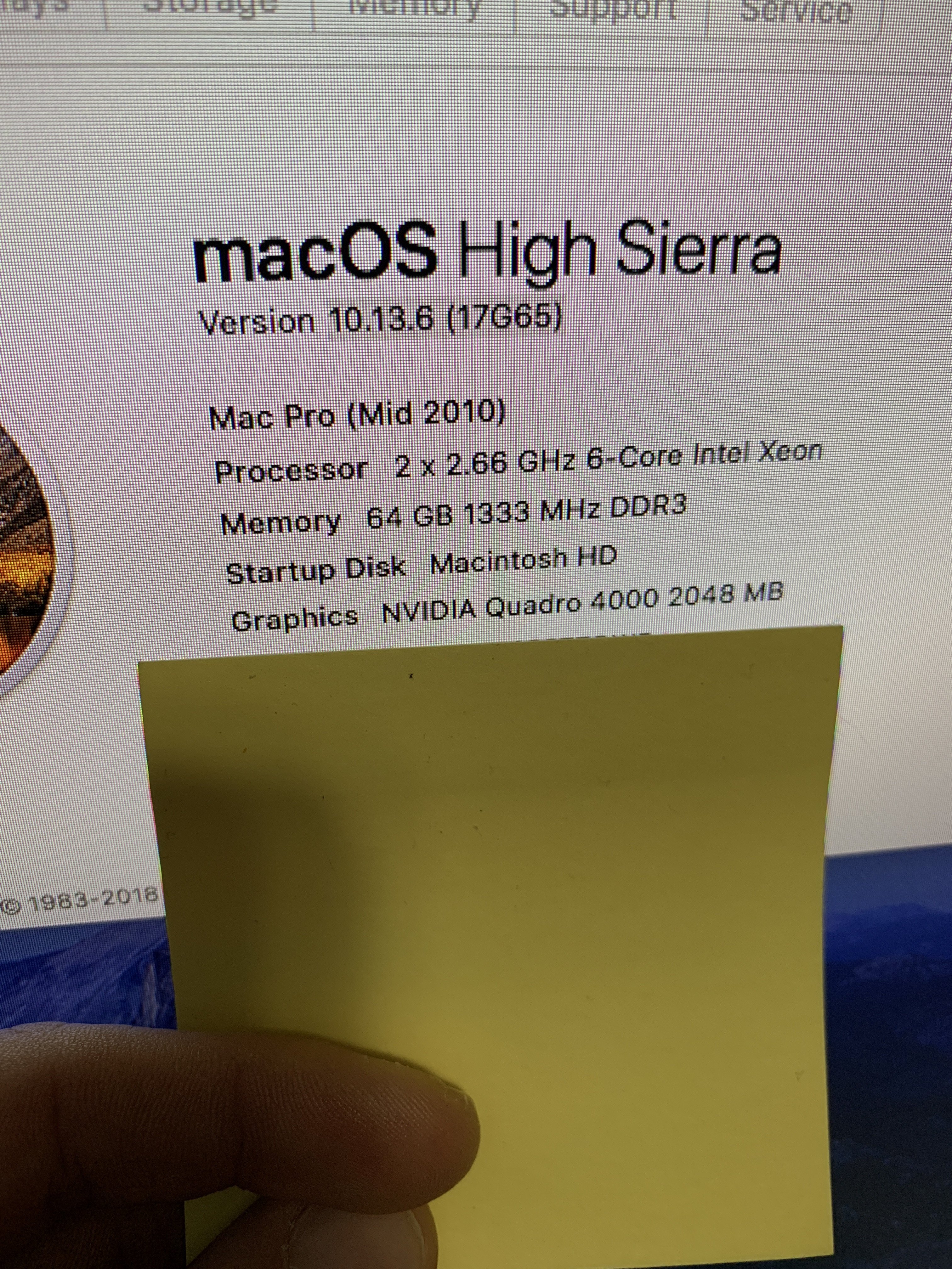

I have tried everything to get my non flashed GTX 780 6gb to work in my 5,1 Mac Pro. I am using the mini 6 pin to 8 pin adapter and the mini 6 to 6 pin. I’m on High Sierra 10.13.6 and runnng the latest cuda and Nvidia web drivers.
All I get is a black screen no matter which port I try and use.

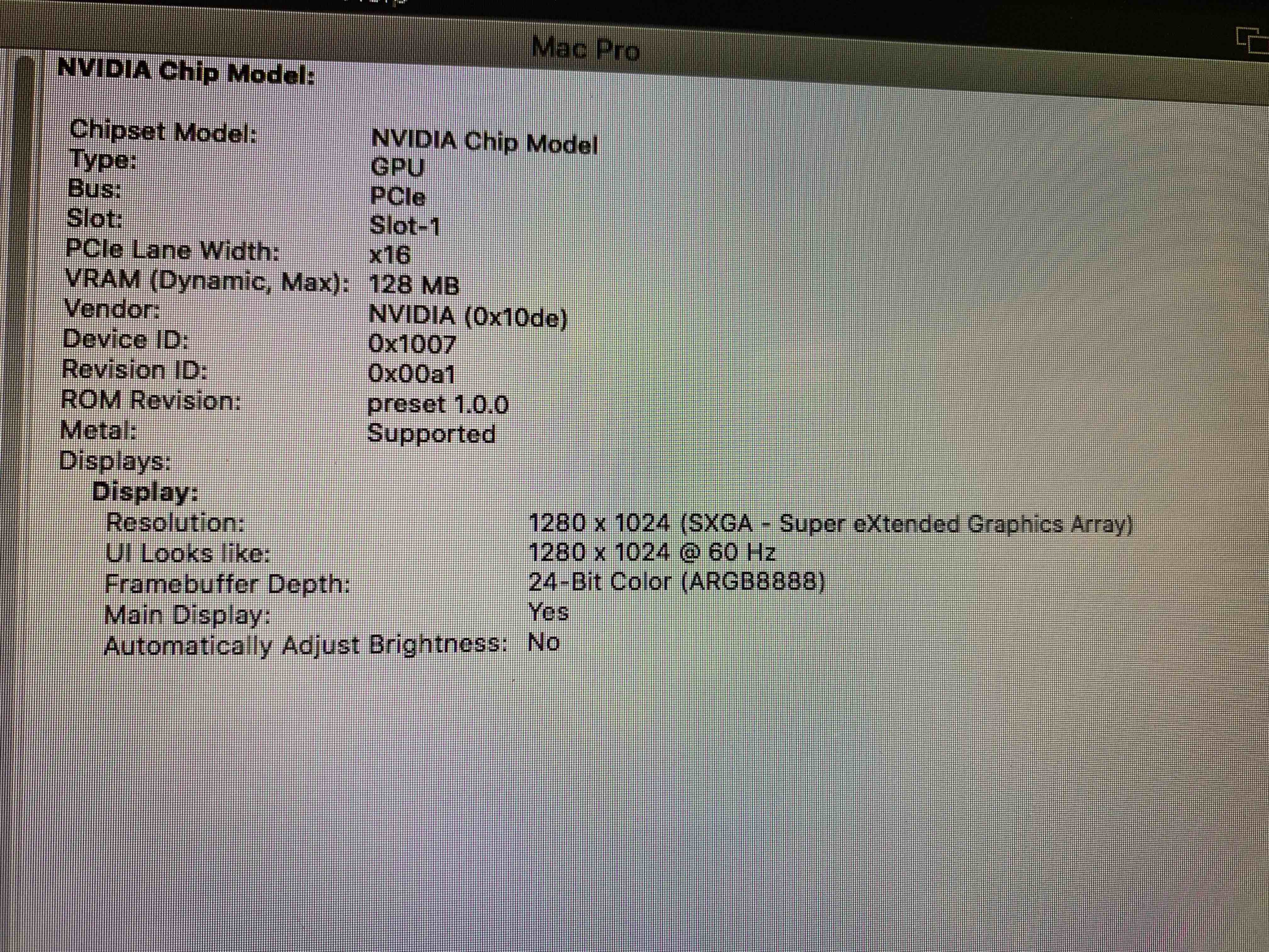

I’ve tried running screen share, and it shows that it’s not recognizing the video card. Just showing it as “Nvidia chip set”
I can’t figure out what I’m doing wrong...
(P.S. I have the IT department at my work double check to make sure that the card was working in everything. It tested out just fine.)

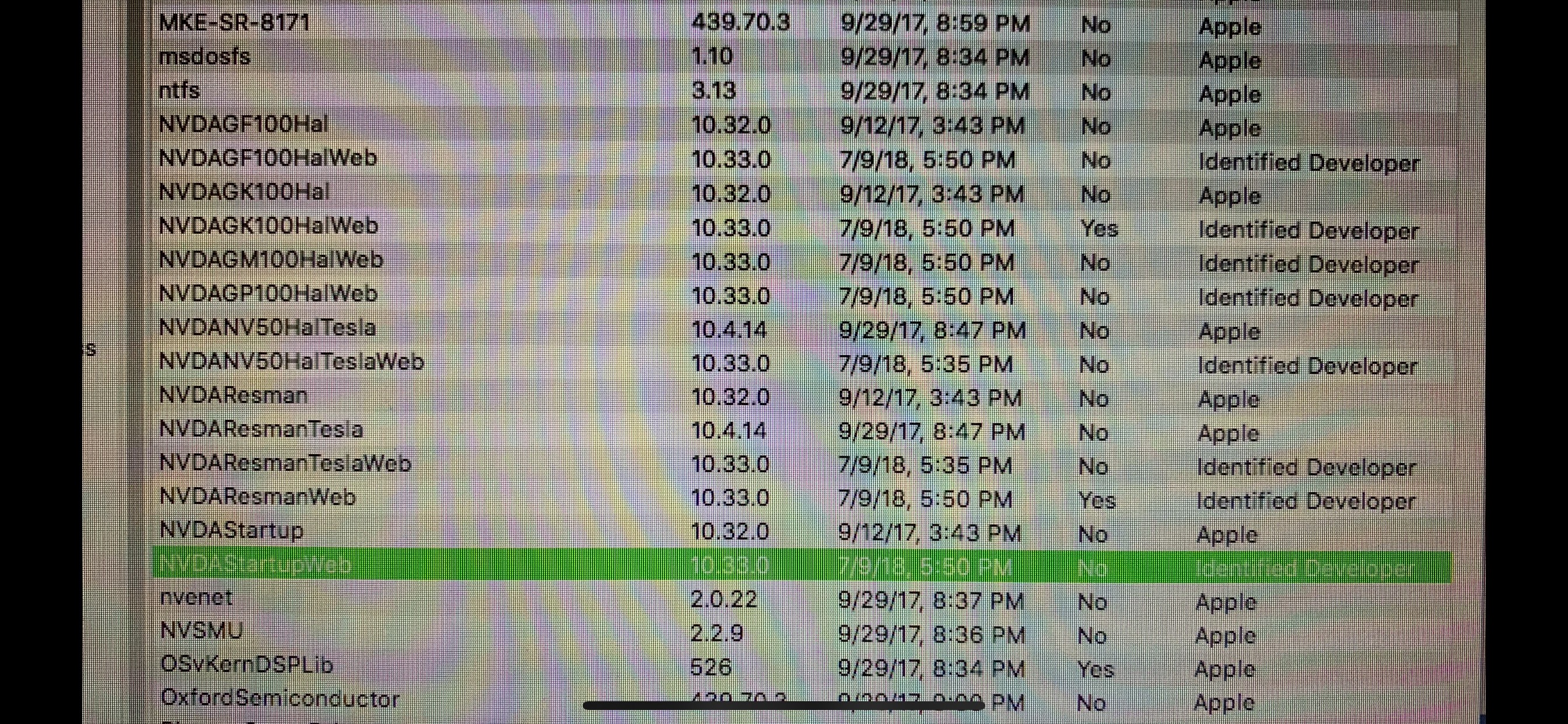

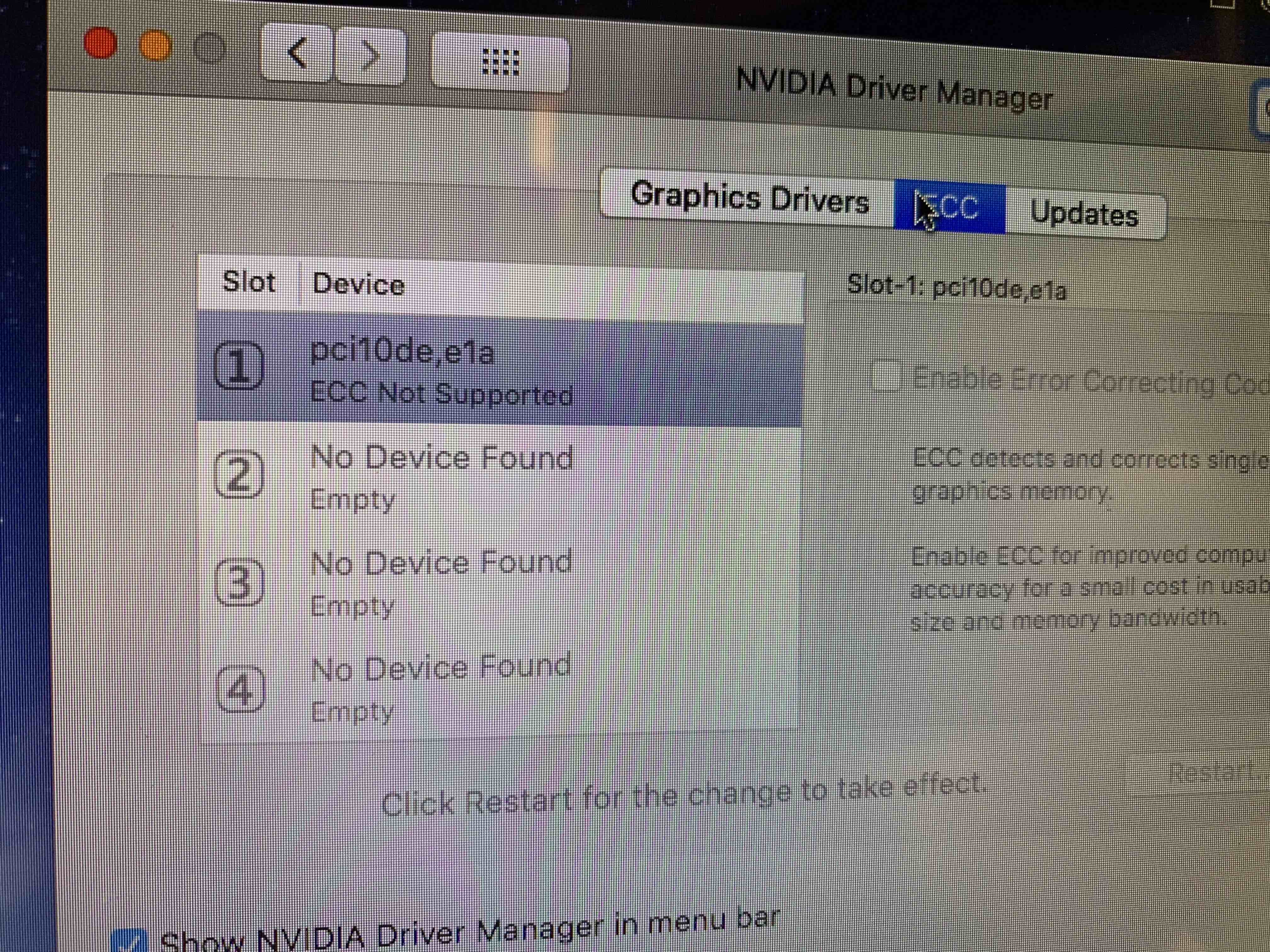

All the info is below in the attached pics. 🙂
Oh and only running 1 gpu. The quadra 4000 is what I currently have running.

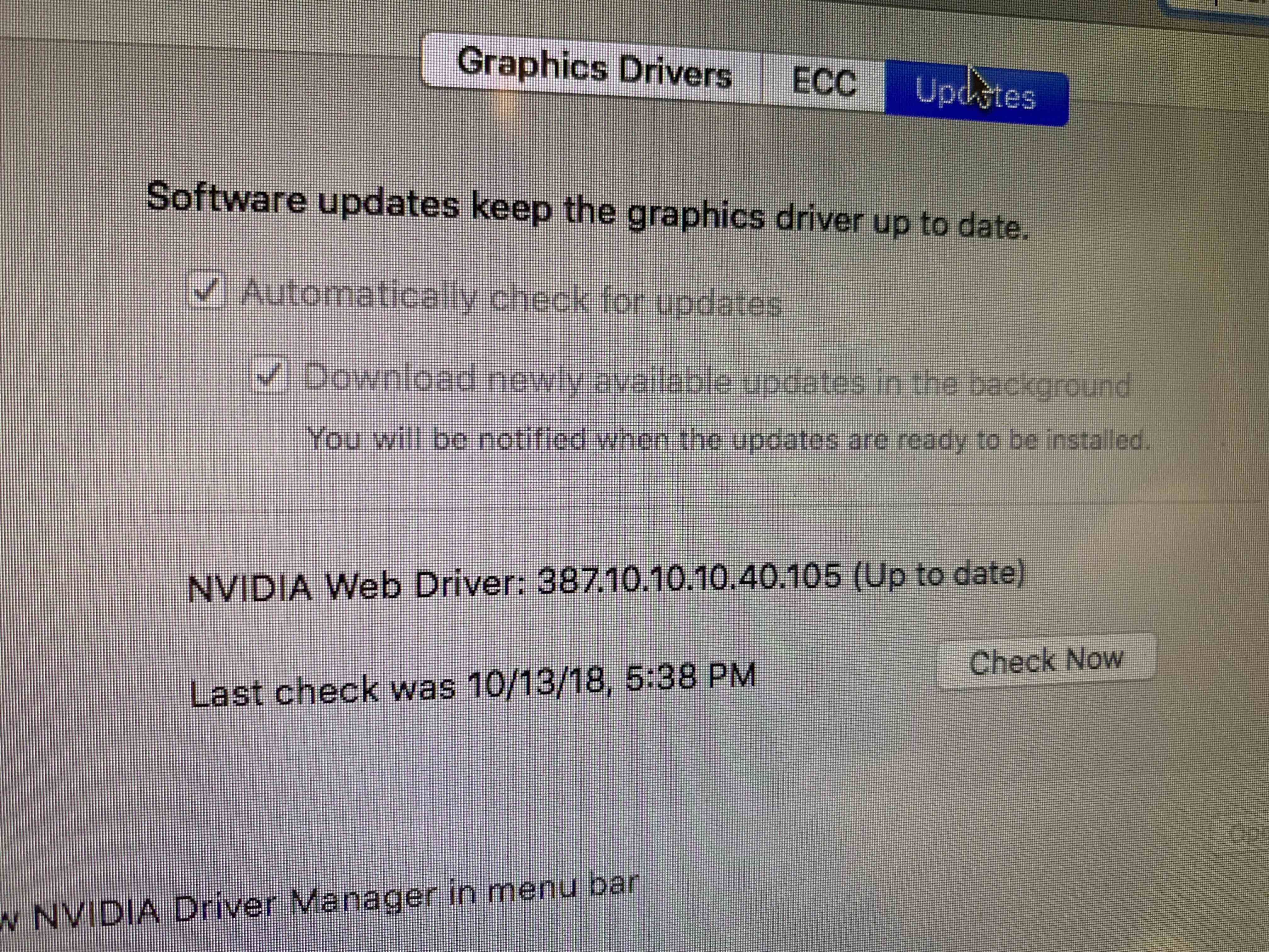

I tried uninstalling the driver and reinstalling it through the script. Still get a black screen with the GTX 780 6gb installed.
I’ve even tried installing earlier version of High Sierra to see if they would work and still get black screen.

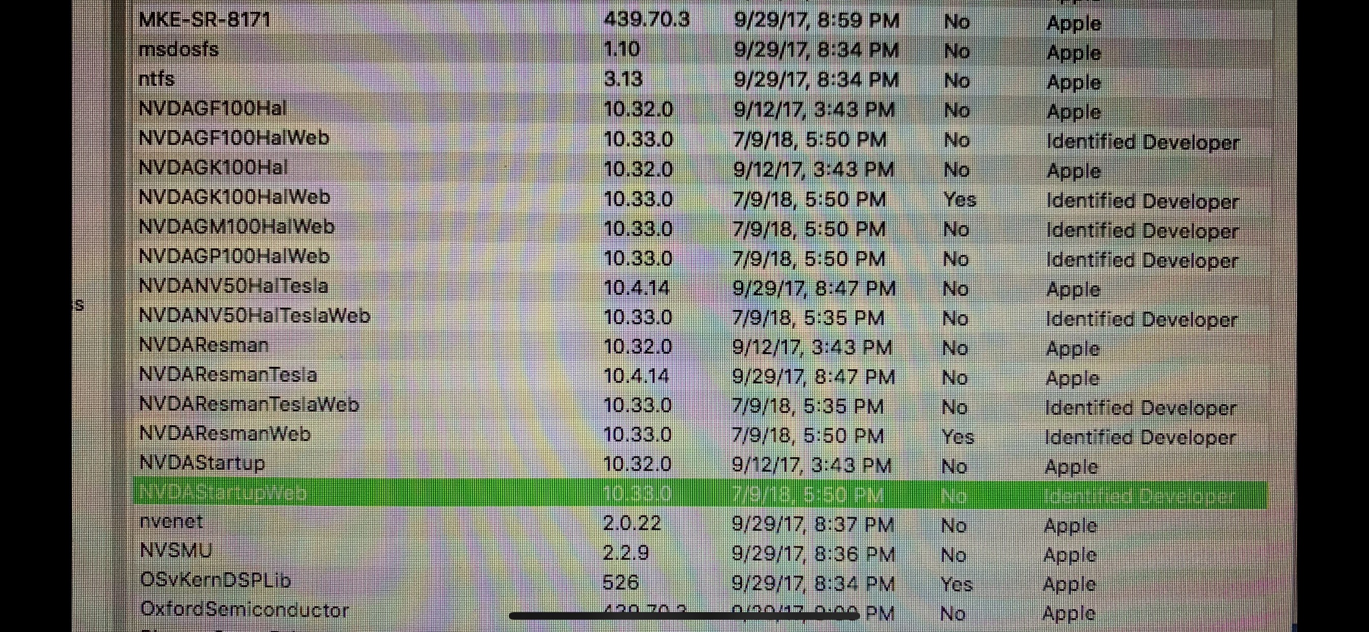

I used the screen sharing tool to see what happens with the GTX installed (see images for info)
I feel like this shouldn’t be this hard. Can you guys think of anything that I am missing?

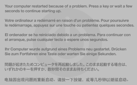

Your card should have native support in High Sierra. Can you get anything display when using the native Apple driver?

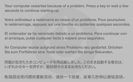

Yeah I had read that and every time I try, seems to get a kernel panic message.
Even if I leave the 780 in the lower PCI slot and put the quadro back in above it and try and reboot I get a kernel panic till I pull the card out completely and reboot.
I can’t really see what’s happening, but I know it doesn’t boot in because when I switch it too the Native driver and reboot I never reestablish my remote connection to the other Mac I am using. Then I have to pull the card and put my Quadro 4000 back in and start over.
The 780 has 1 8 pin and 1 6 pin port. I am running one mini 6 to 6 pin (stock cable) and one mini 6 to 8 pin to the card. Which from everything I’ve seen and read that is the correct set up.
